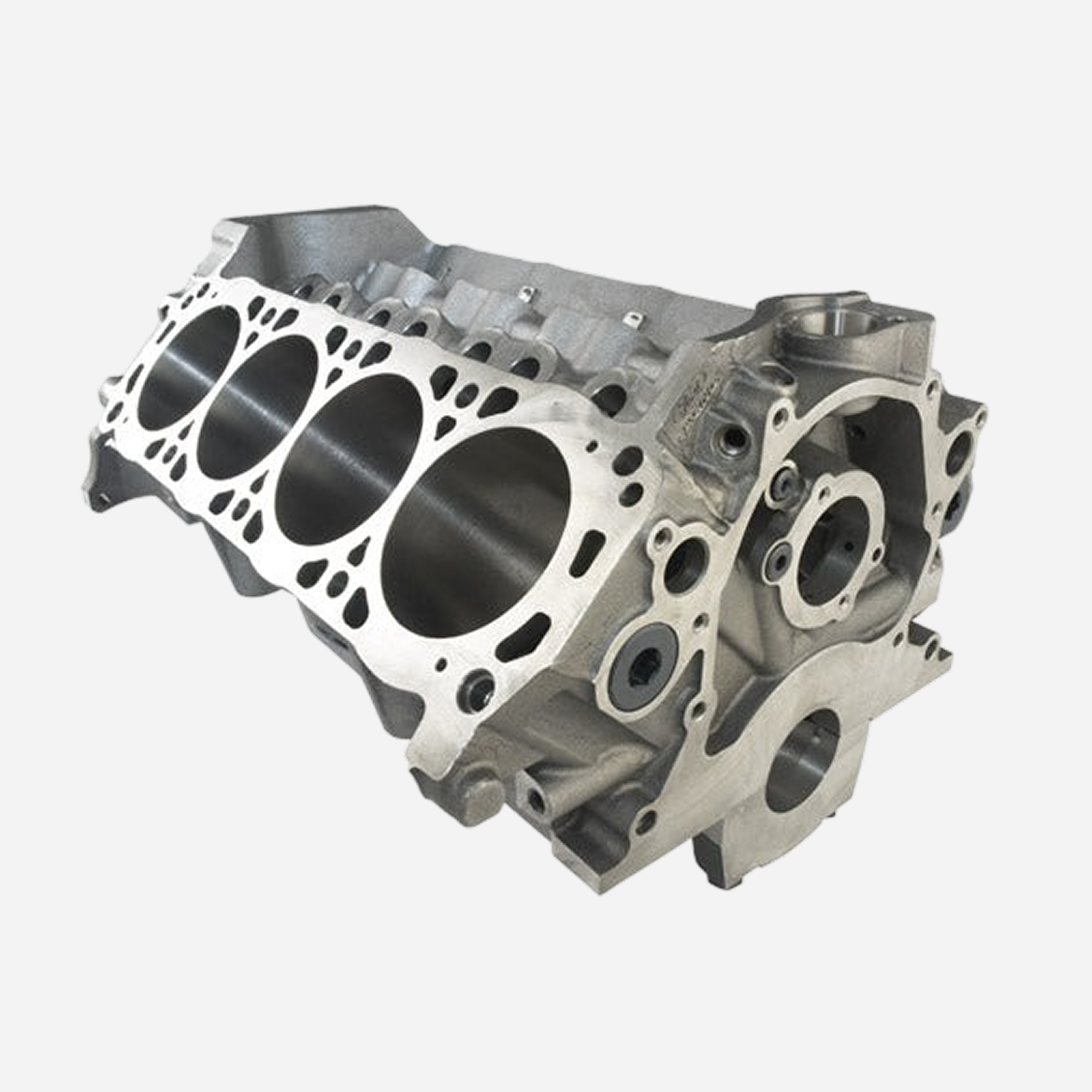

BOSS 302 ENGINE BLOCK
Unleash legendary power with the BOSS 302 Engine Block, expertly crafted by Ford Performance Engineers for unmatched strength and versatility. Built from diesel-grade iron, it's your ultimate choice for dominating both track and street. Ford Performance Engineers have designed the replacement...
paulsautomotiveengineering.com
This definitely sparks my interest

So on that one it would need the cylinders machined and honed to my pistons, corrrct?

Yes... You would have the block machined to your rotating assembly.

I been reading around the web and see that cracking is coming at this area of the late model stock 302 roller blocks. I’m definitely going to upgrade. I’m going to do some research and maybe connect the various aftermarket block makers and see how ready they are off the shelf for a stock bore stock stroke rotating assembly. The Dart or the Blueprint may only need finish honing whereas the Boss block would also need boring. Point is, I don’t mind a slightly more expensive block that needs less machining to be ready for assembly.
