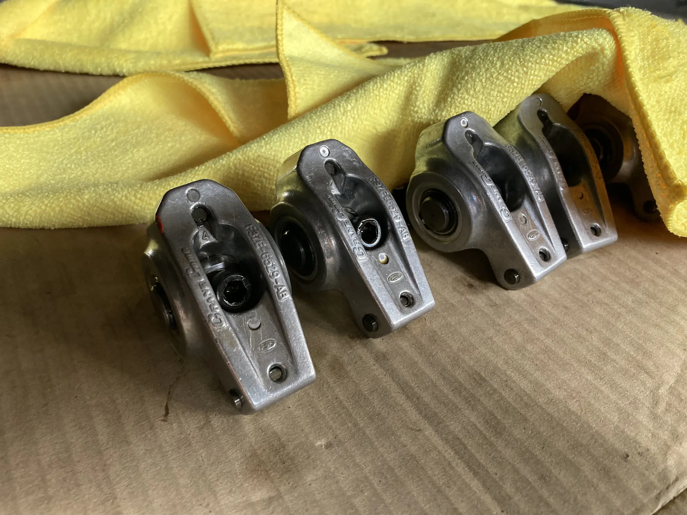

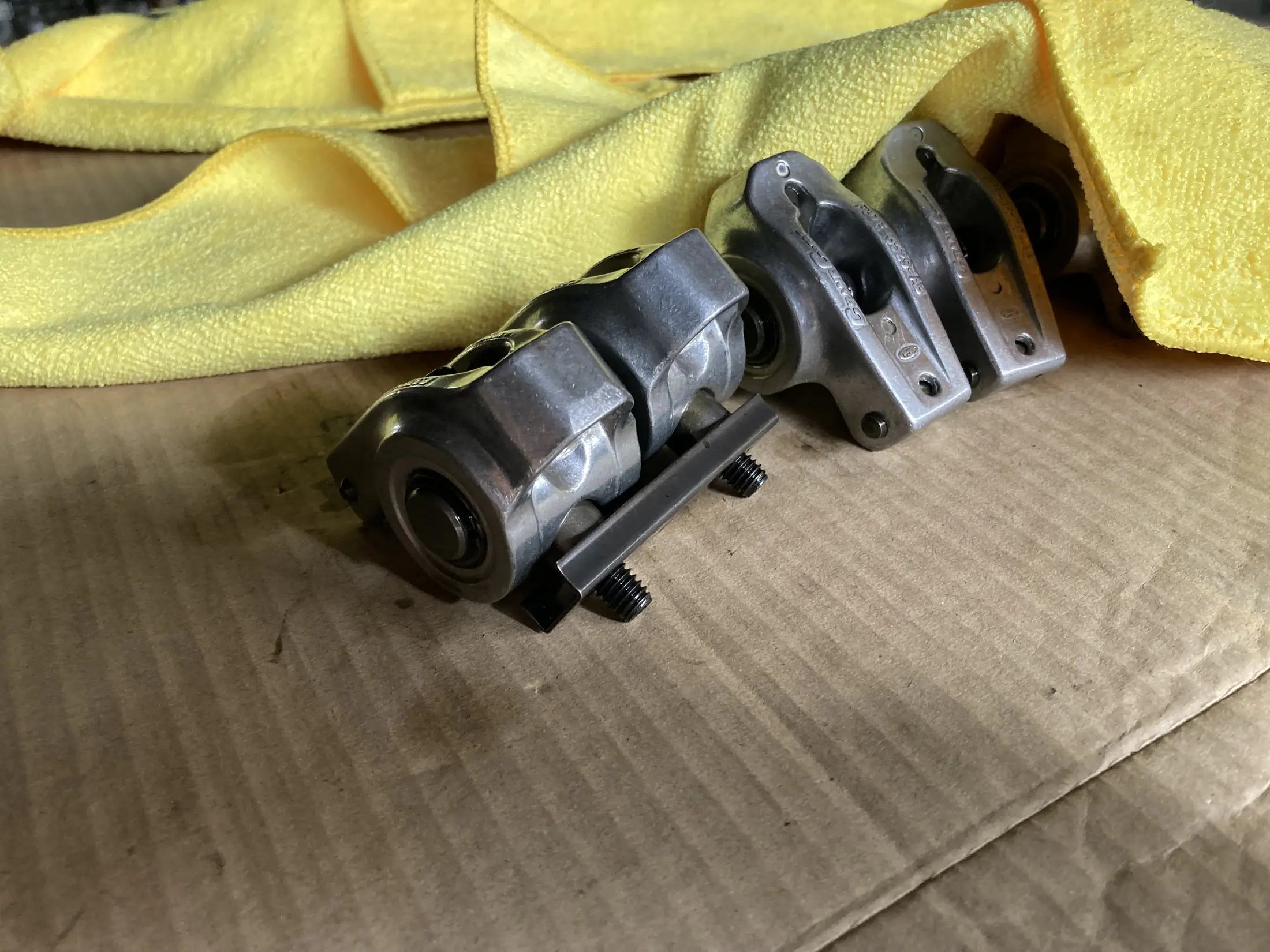

FWIW, I’m running Ford Motorsport 1.7 full roller pedestal mount rockers. Made by Crane Cams and I’m not sure if they even make them anymore. Pretty pricey if you can find a set. There’s a set on eBay listed for $1000. Obviously I think that’s insane!
Here’s a couple pics of mine
Reactions: DadLife0724

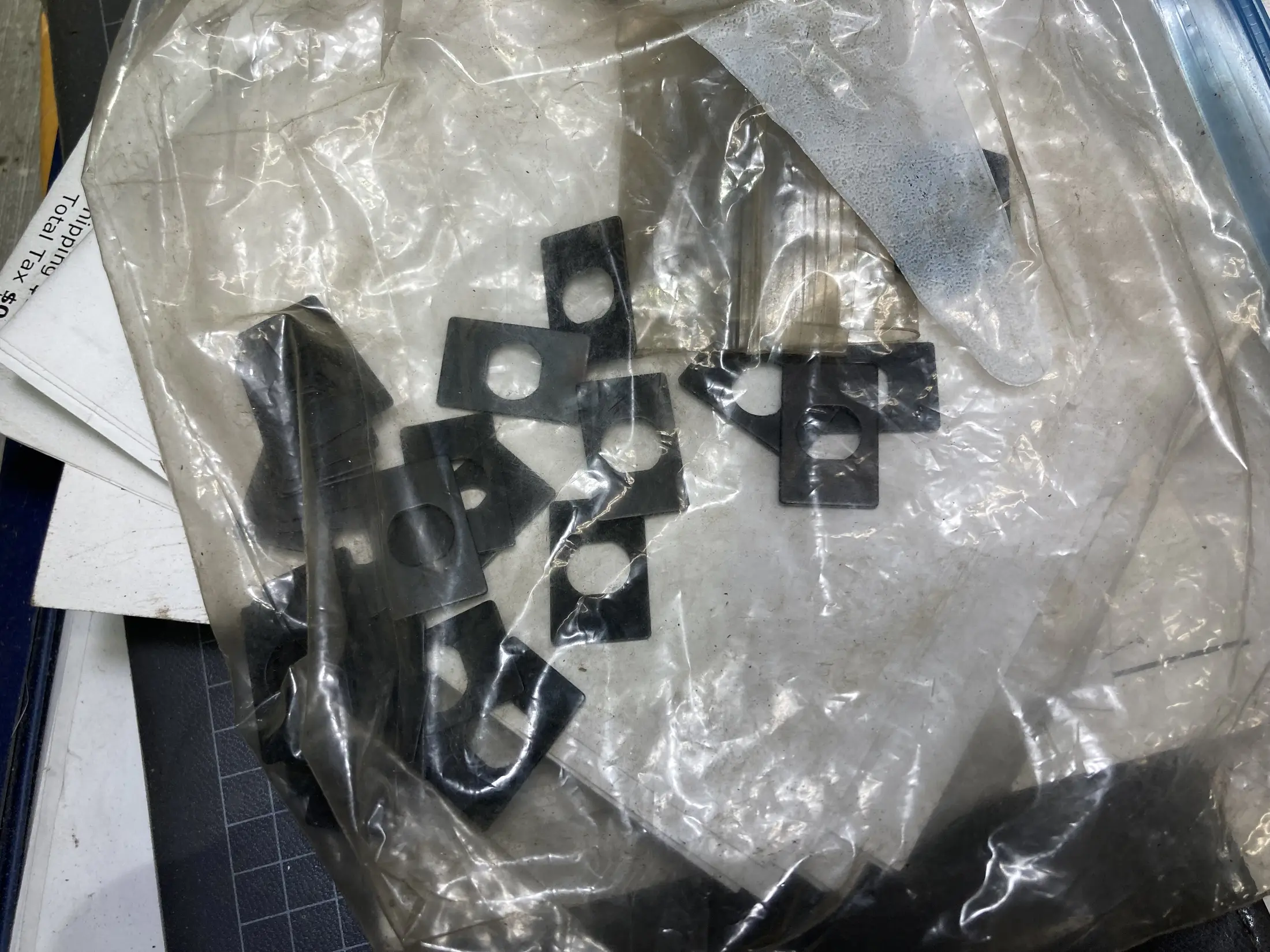

Still trying to find my damn pedestal shims. You see, I needed them and used them the first time around. Then I changed to Cometic head gaskets and ran a slightly thicker gasket so I didn’t need the shims. This time with the new AFR heads I’m going back to 9333 PT1 gaskets and I need the shims again. Can’t find em darn it. Might have to buy them again.
JD1964
there is enough sticking out to grab on to
Jun 28, 2013
3,461
1,548
194
Maryland
Apr 21, 2026
#59
  • Apr 21, 2026
  • #59
Ah hah!!! Getting warmer
Reactions: nicholase
JD1964
Jun 28, 2013
3,461
1,548
194
Maryland
Apr 21, 2026
#60
  • Apr 21, 2026
  • #60
Got ‘em! The nice thing about searching for stuff is now I have a refreshed memory of other stuff in the inventory.
