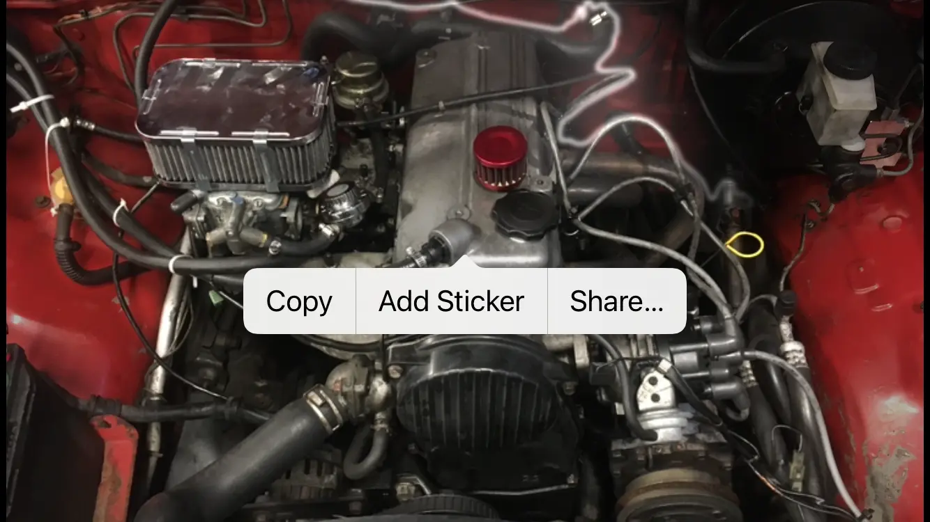

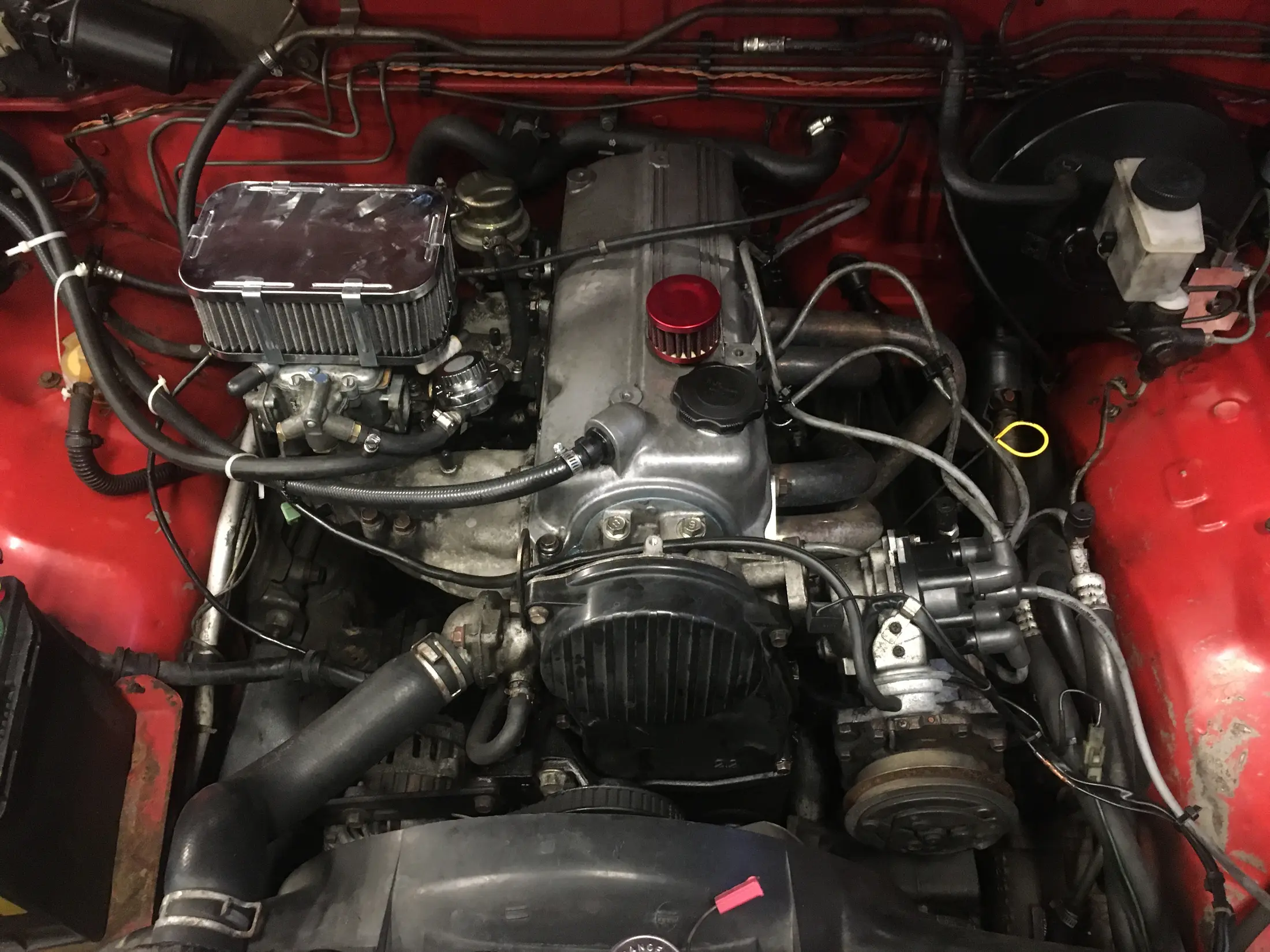

Mine is stock except for a Weber carb swap and a header. 5 spd manual and a wopping 90hp
