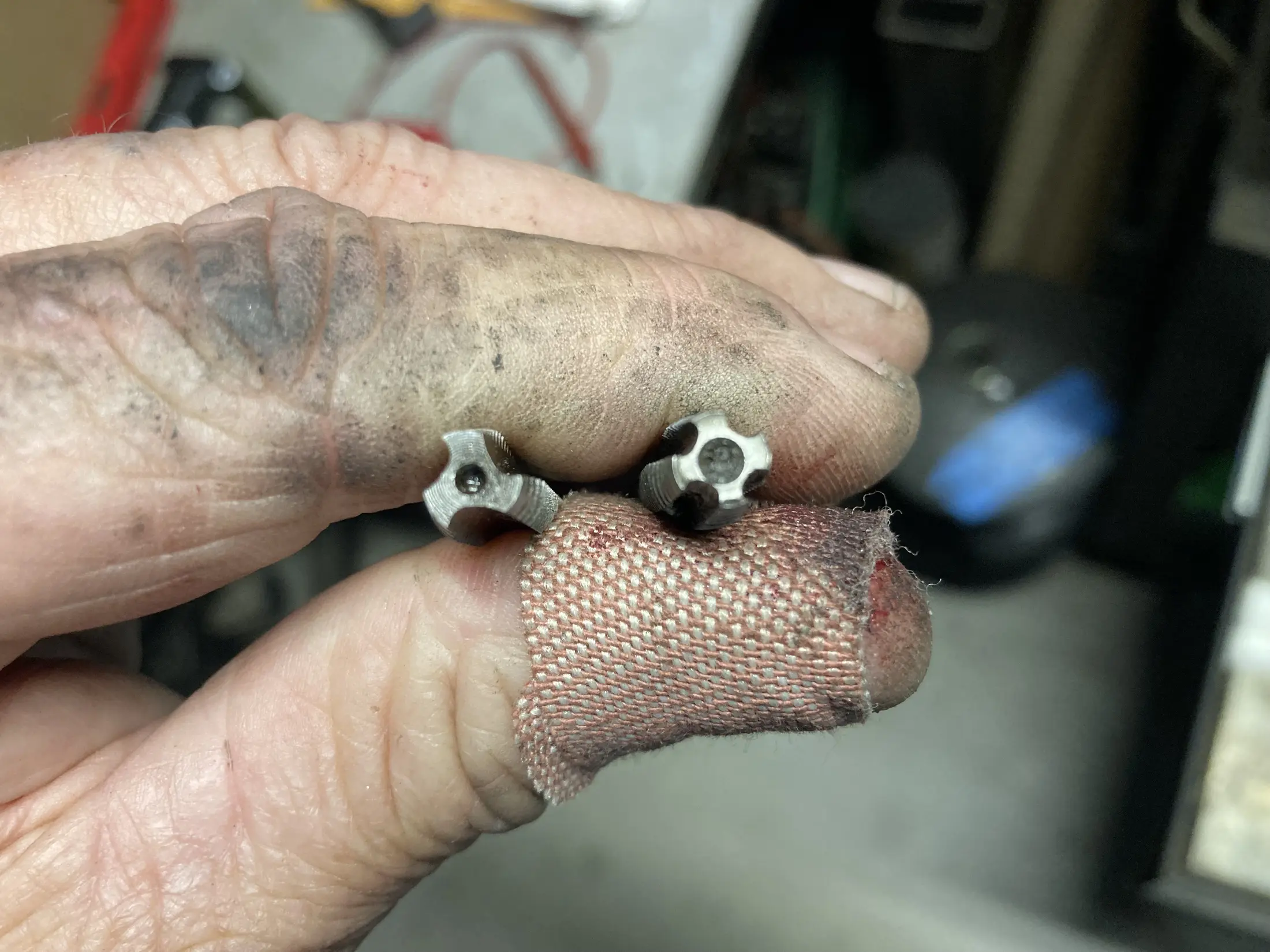

Whats the pros and cons if any between 4 flute or 3 flute tap?

Seems like it was easier to get the three flute started in the bolt holes. That’s one point for it

To clean out threads a thread chaser is the tool for the job. Taps are really aggressive designed to cut new threads. Chasers are meant to restore existing threads.
As for the 3 vs 4 flute taps, no idea.

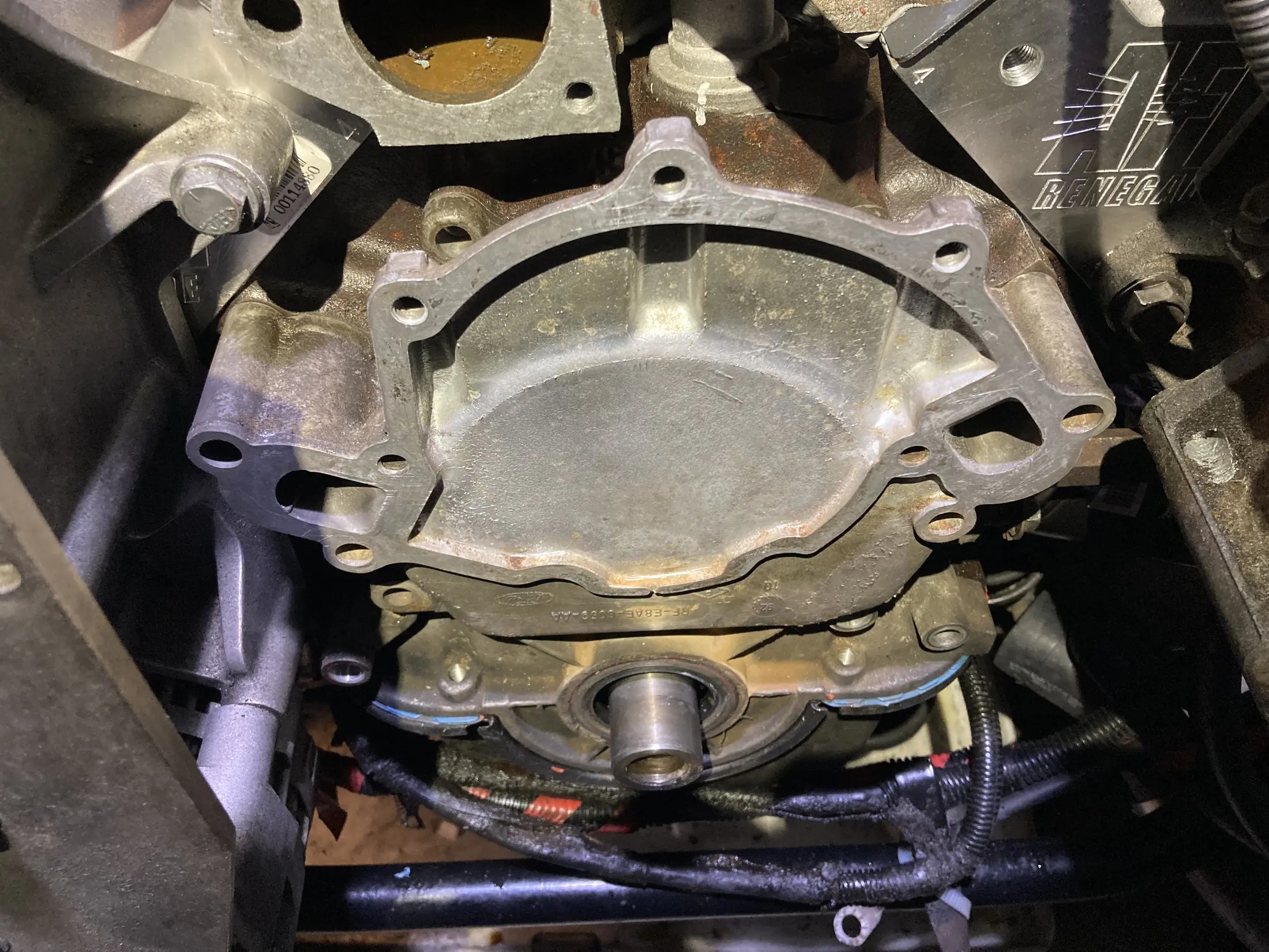

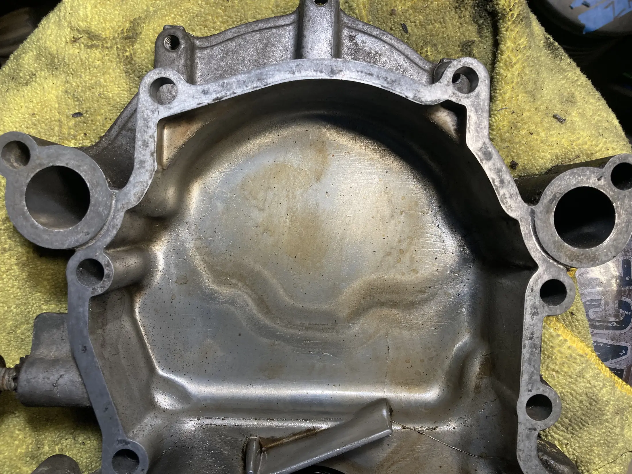

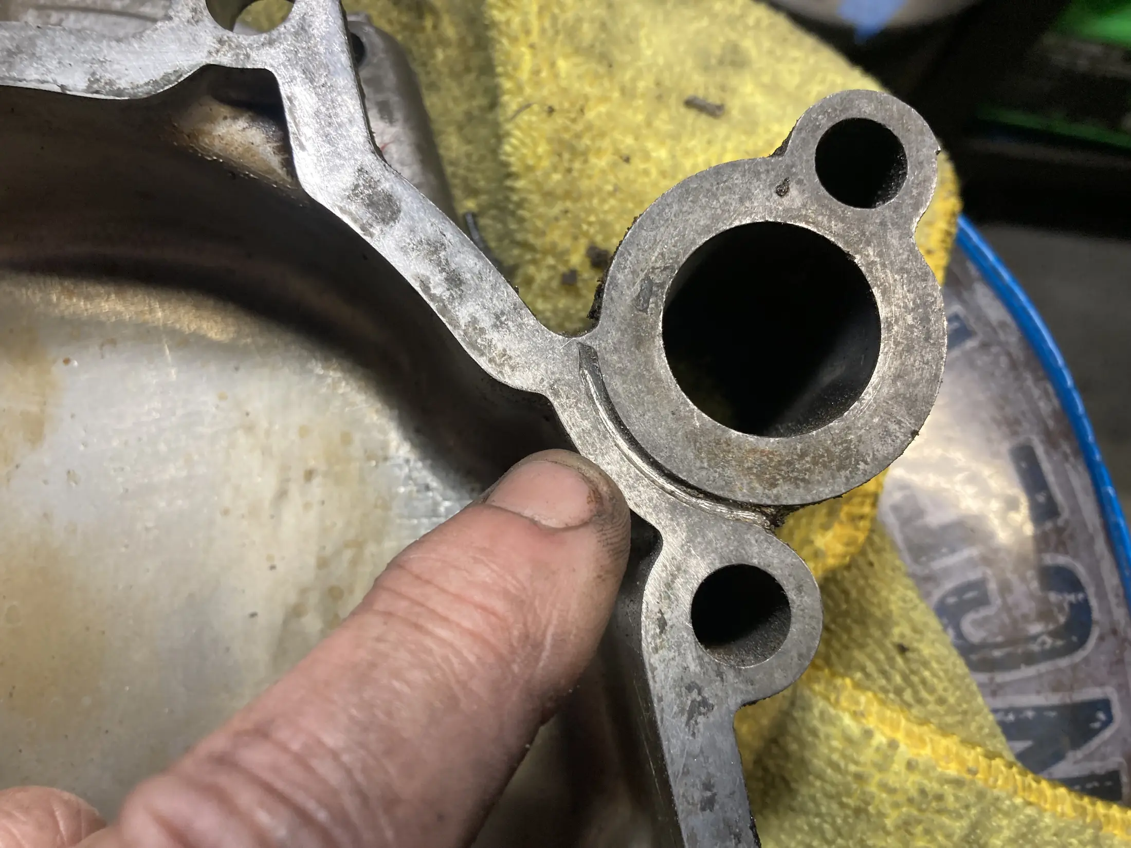

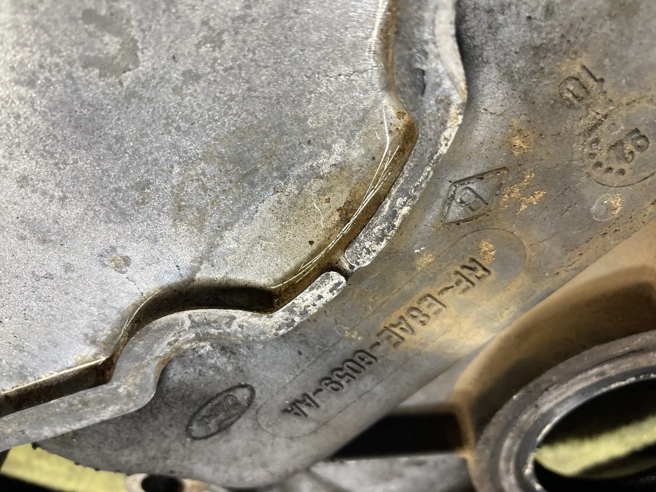

Is this a designed weep slot in the timing cover?
JD1964
there is enough sticking out to grab on to
Jun 28, 2013
3,470
1,557

Also, is this a designed weep to reduce a leak of coolant from getting into the crankcase?

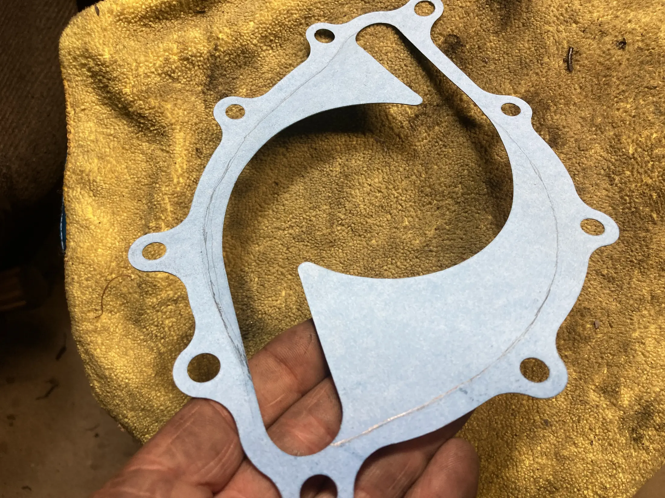

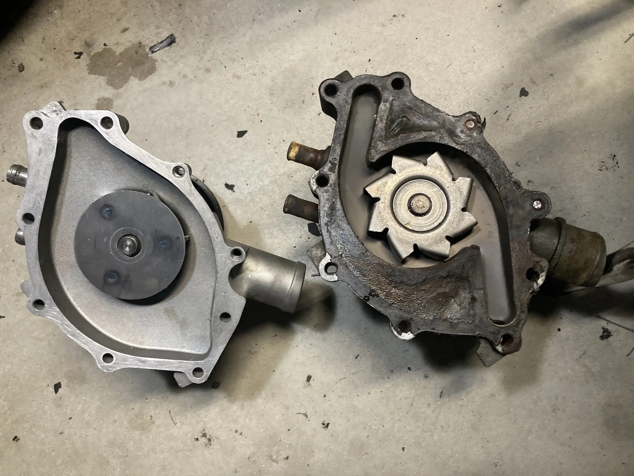

The back of the Tuff Stuff water pump is different so I pressed and imprint and penciled in a line to trim the stock replacement gasket of the excess material that should not be left in there.
That is what I was told but it’s useless if too much RTV is used.
Yes.

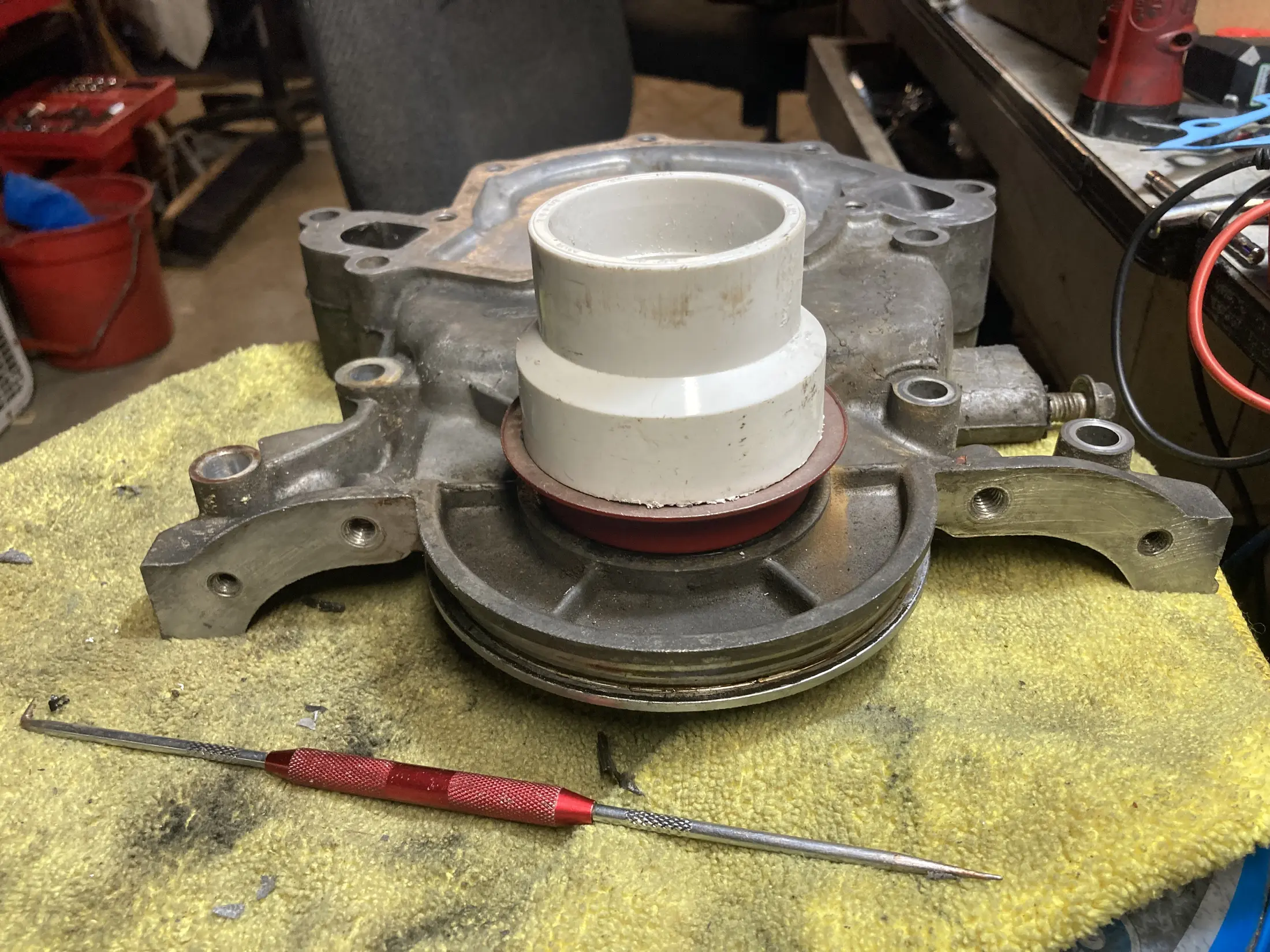

I’m thinking I’m going to remove the old hub seal and install the timing cover onto the engine before I install the new hub seal. This pcv fitting will make a perfect installer. It fits over the crank snout and its outside diameter is just about perfect for driving the seal in.
I figure without the seal in place when putting the cover on, I’ll have more range of movement to go in a little high then push the lower part of the cover down into the lower pan radius seal. Also prevent damaging the new hub seal while gaining extra range of motion for installation.

AeroCoupe said:
That is what I was told but it’s useless if too much ATV is used.
If a person expects to have even minimal rtv on both the water jacket surface and the crankcase surface it seems almost impossible that rtv will stay out of that weep slot.
I believe factory installed the gaskets dry. I’ve tried it (others here have as well( and got a leak shortly after. Have used RTV ever since.
Yeah ain’t no way I’m putting these paper felpro gaskets in dry. Not happening

I test fit the cover install process with the old hub seal still in place and had no trouble getting it properly installed. I can install the new hub seal in the cover before I install the cover to block and have plenty of free movement to get easily together correctly.
I had the original pan radius seal on the cover during this test fit. Its thicker and it also fits the existing rubber pan gasket perfectly so I’ll reuse it in the final install.

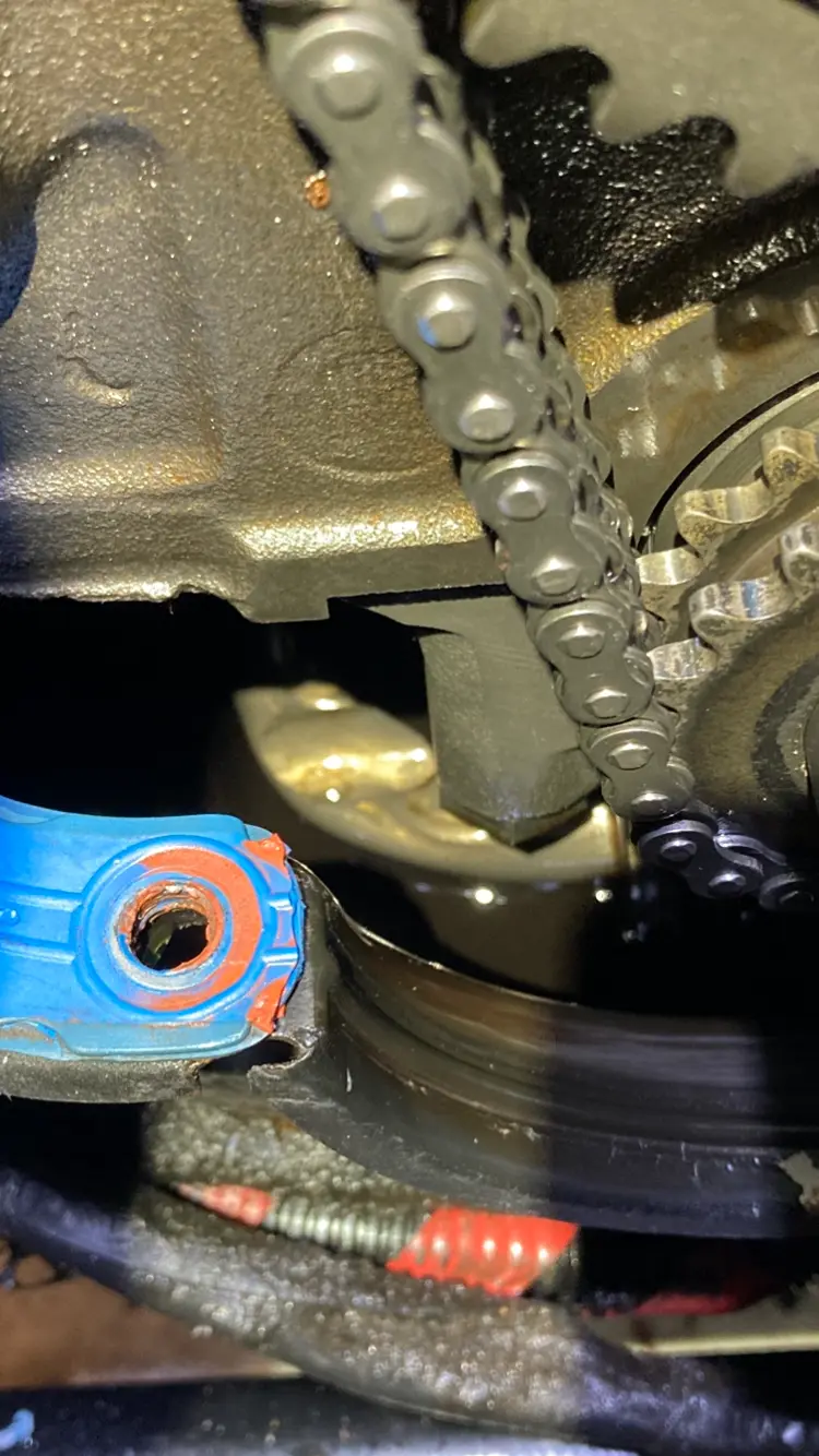

Can you see the indentation in the oil pick up tube? This is normal, right?

I bet it’s for connection rod clearance

I found these pictures on FB and it looks like normal stock tube. When I rebuilt this engine, not too many miles ago I used a standard volume stock pump. I probably went through this question back then too, but just don’t remember.
