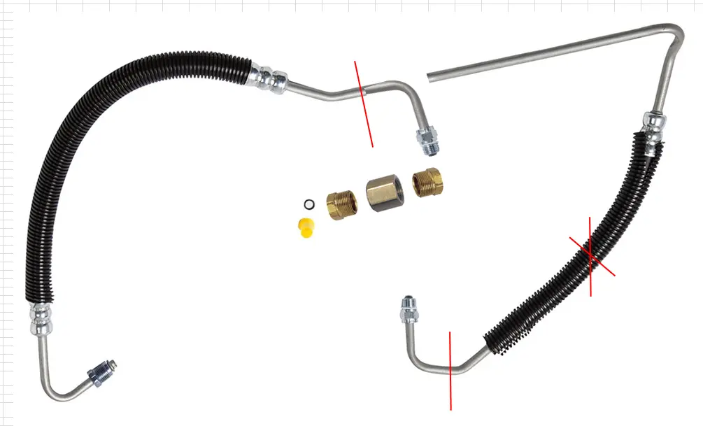

PS pump to hydroboost hose is a little tougher. Buy or salvage a 2002 mustang hose. Edelman 91974. Cut the shorter flexible hose section out of it and toss it. Joint the hose back together using a 3/8 flare union and you have a custom hose that fits perfect. I am actually running the junk yard hoses cause they were just fine. Here is the hose, where to cut it, what chunk to throw away and where to joint it. My editing is so good you might not even see that I cut and paste the end on where it gets spliced.
