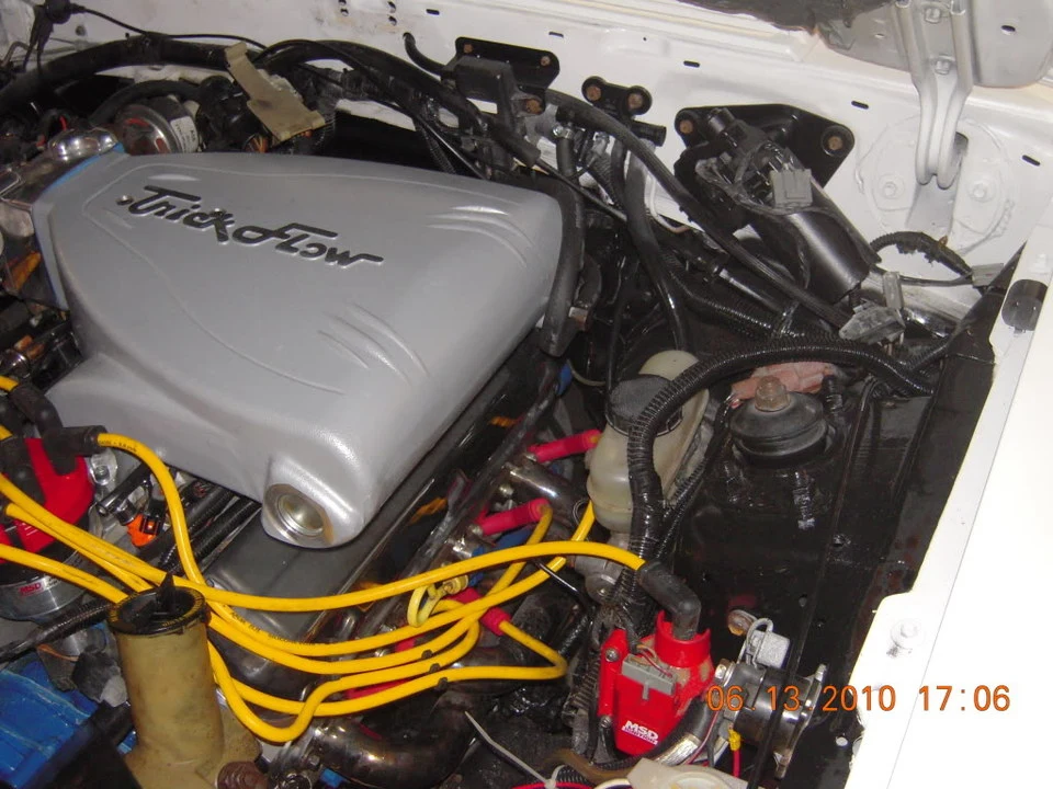

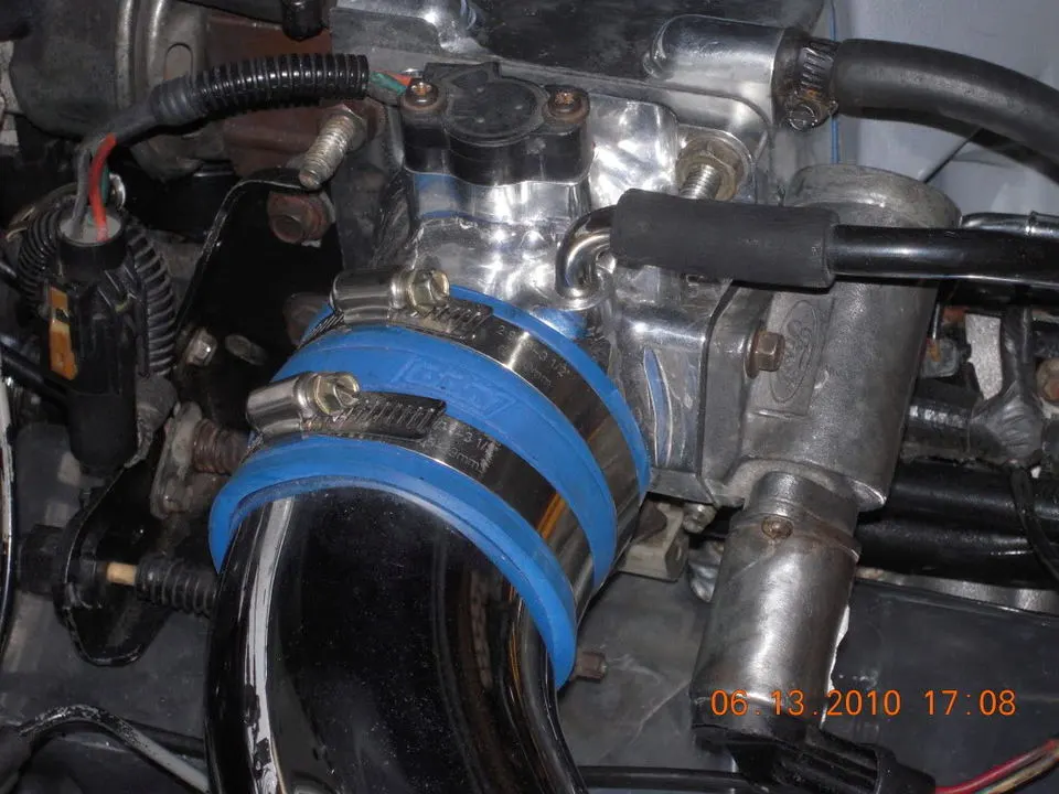

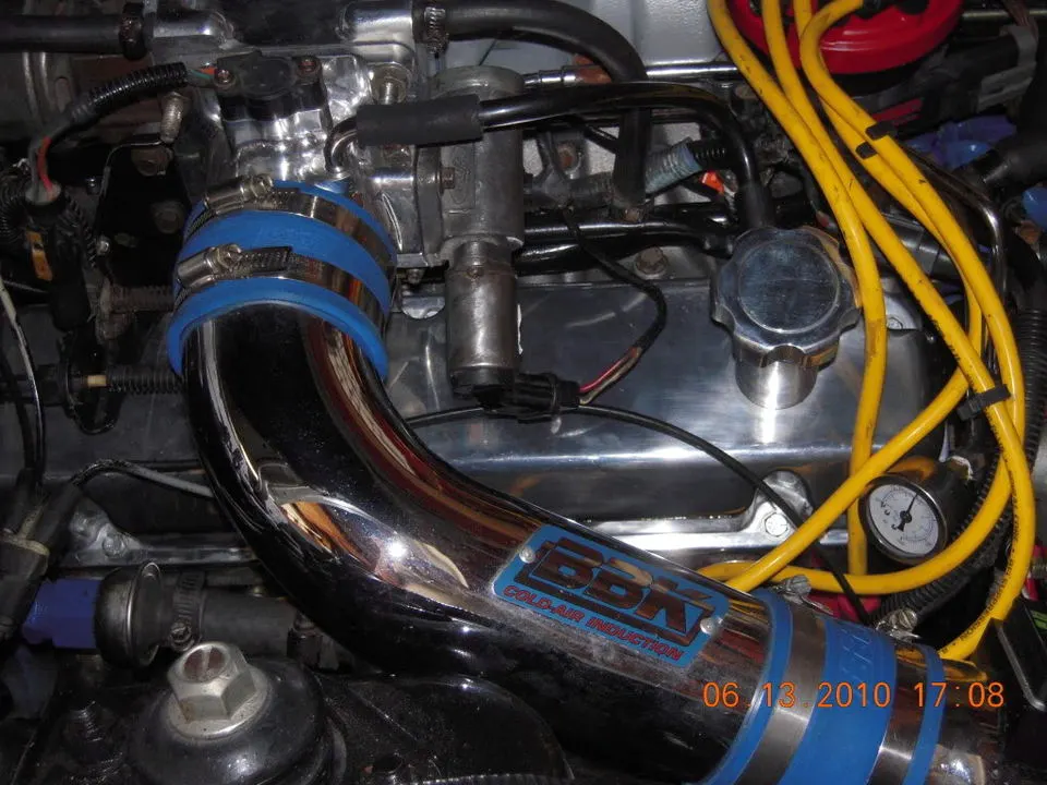

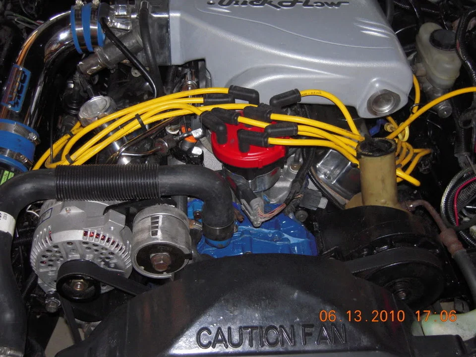

well i finished my swap and finally got it all adjusted, first off its a 93 triple white convertable, the following are what was done to her:
AFR 165 emission legal heads ( need to pass e-check)
TrickFlow Street Heat upper and lower intake
TrickFlow stage 1 cam, degreed
New timing chain
New Hydraulic roller lifters
1.6 Rockers
new pushrods hardened
new 24 lb injectors
new 255 fuel pump
fuel regulator adjustable

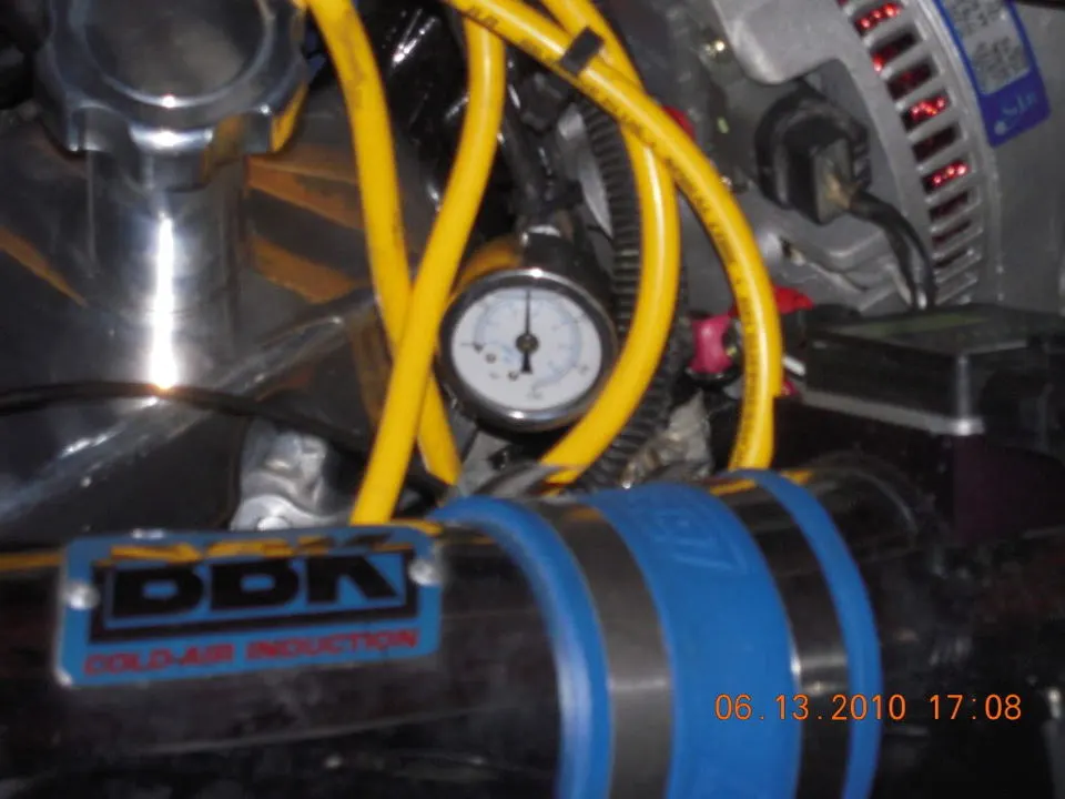

fuel pressure gauge
new aluminum radiator
PA performance 130 amp alternator
PA performance mini starter high torque
new equal length shorty headers
new O2 sensors
new performance harmonic balancer

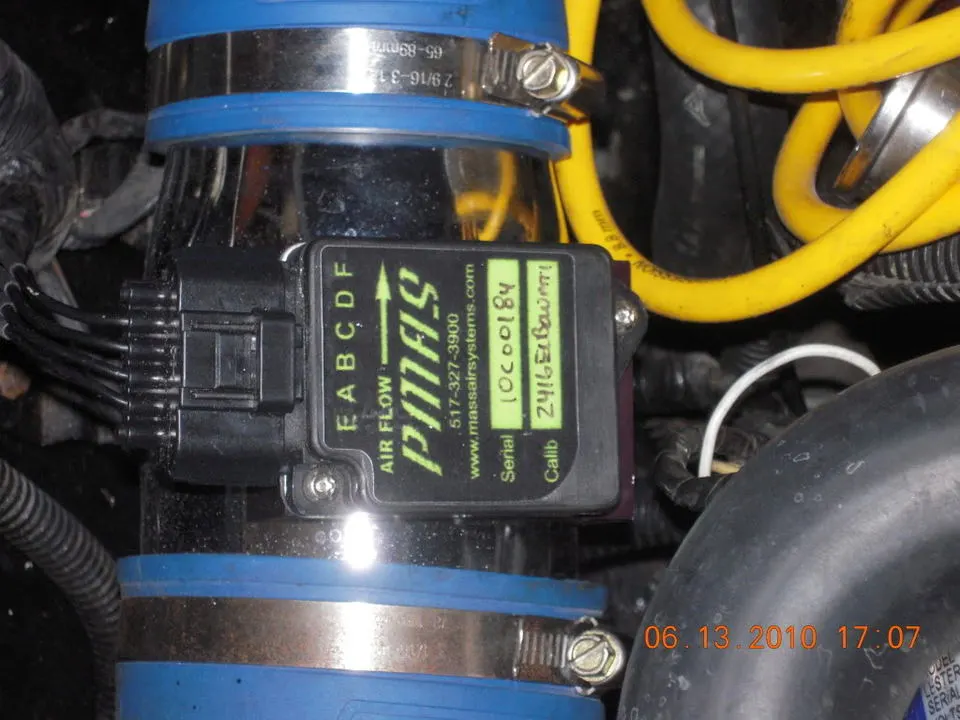

New 76mm PMASS MAF calibrated for 24 lb
New MSD Distributor and coil
70mm throttle body

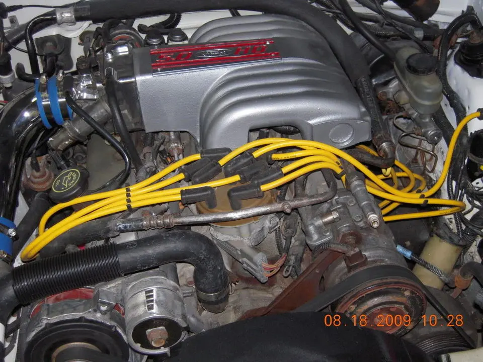

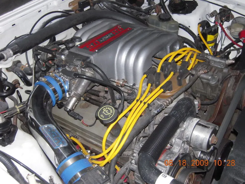

Car already had 3.73 gears, full subframe connectors (welded) new springs shocks and struts, new tie rods both inner and outer, 3000 stall converter, and shift kit. Heres a few pics of the engine before and after the swap
before
she really pulls hard now, cant beleive the difference

well just a update, i finally drove the car a little hard today and boy does it pull extremely hard from 1500 to 6000 rpm, it also has alot of torque it feels like, i am very impressed with the results acheived from the swap
did you notice a loss in low RPM power?
did you notch the pistons for that cam?
i want to do h/c/i but am worried about losings the low rpm torque that makes my near stock 5.0 so fun to drive on the street
no loss of power at all, even more power and torque, no notching the pistons as i checked the clearance before i installed, the cam is not that radical but makes alot of power with the right heads and intake, i upgraded the injectors because i needed new ones anyway and did the fuel pump at the same time, but its alot more fun to drive now, alot of it is matching your components to acheive what you are looking for in terms of performance and drivability, my car is a street runner and maybe occasional track times
