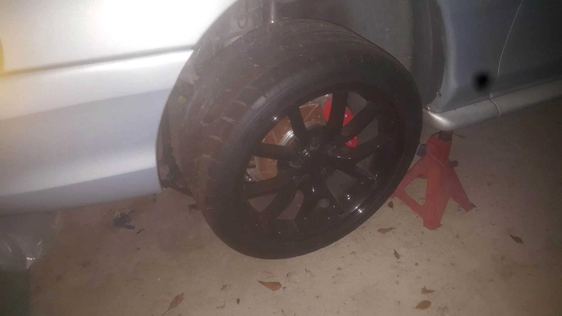

So as far as the exterior i have put on a new top. I have fr550 rims with nitt0 556 tires. 10s in the back and 9s up front. Also have slotted and grooved rotors with the best pads American muscle had. came as a set. Caliper covers do their job well as the red is a nice touch. I have flowmaster mufflers with 3 inch tips. Back cats are removed and pipe welded in place. front cats are physically there but i poked out all the insides. this car is non egr as you can tell now. H pipe is fine, not worth my time to change. got bbk shorty headers. I also put in a walboro 190 lph fuel pump and changed the gears to 355

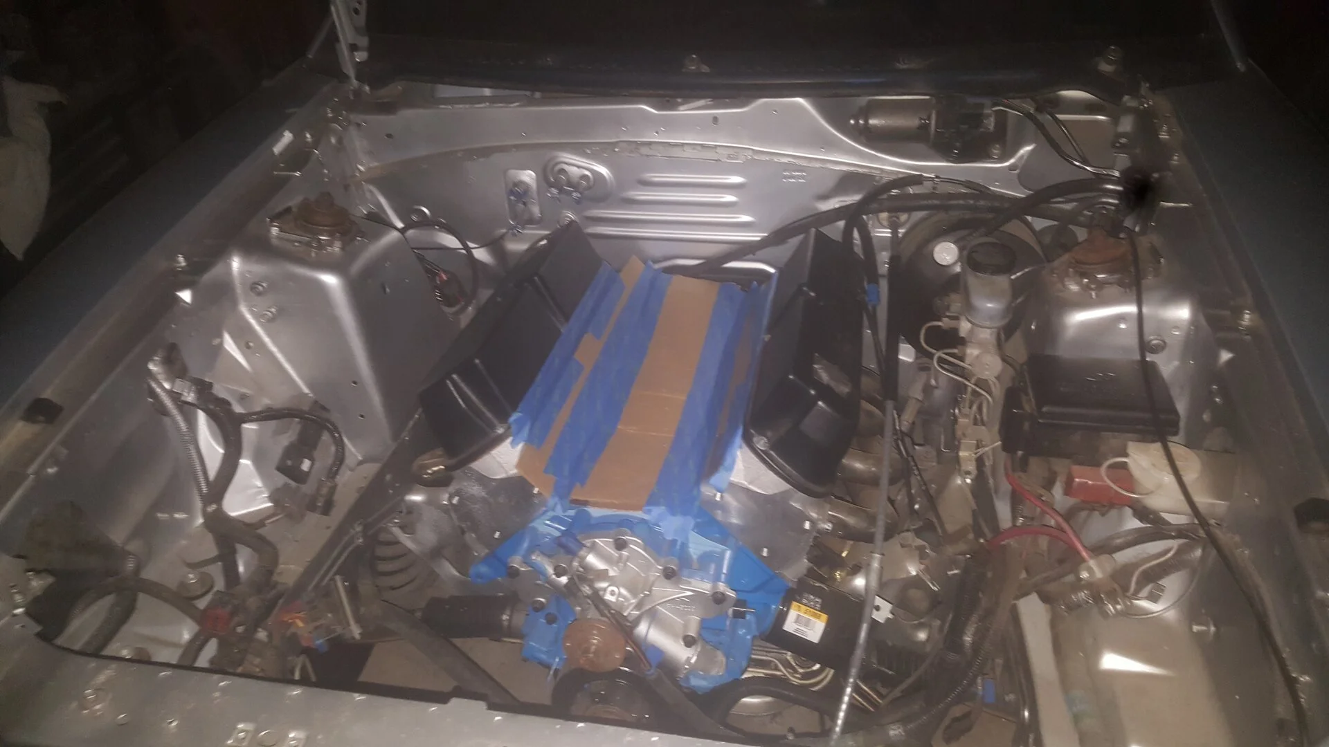

Ok the main course... I broke down the engine to the bare block and took to an engine shop here in columbia SC. i had seen their work and didnt care the price. The rotating assembly is an eagle kit. Everything is forged in there that can be. Flywheel is 0 degree , so is the harmonic balancer which no longer balances:DClutch is a stage 2 Ram i think. Put in an adjustable cluth quadrant too. Clutch and flywheel came from american muscle as well as alot of these parts. or LMR. So far i have only reused the water pump, the starter and both were cleaned and painted a gray as well was the engine bay 2 coats color one coat clear. Heads are aluminum 190cc intake runner, 2.02 intake valve, 1.600 exhaust valve. got a comp cam with .580 lift. Roller rockers are also comp and 1.6 Got some nice tall valve covers on summit that say stroker and are a matte black finish. from the picture you can see thats about where i am.
I am currently porting an intake i got from pullapart off an old for explorer. Halfway done with porting then i will clean and paint the same gray.

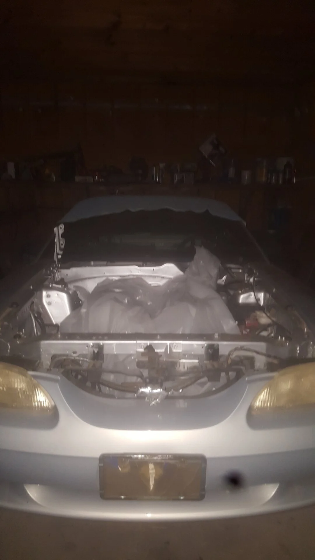

I have taken off all the smog stuff. also the A/C. Why? Cause its a convertible and will only be driven on sunny days and never in dead summer or winter. It will be in this garage in the photos. Im debating just putting on a smaller belt instead of those bypass pullies.
Im sure there is some other stuff im missing as far as getting it to turn over and some of the stuff on here is not needed for that but i pulled enough from my 401k to finish it. There is not enough for a supercharger:mad:, but its not really setup for that.

So today was mounting lower intake that i ported. Everything was going perfect. Then i dropped a washer down an intake runner...
im 99% positive it went down a runner where there is a gap with the valve. I tried to use my magnet but no luck. Im thinking my only option is pulling the head.
What a nightmare this project is.
i bought an arp pack of 12. i would say aluminum.I took the exhaust off driver side. no luck inn any of the ports. Not even sure it would have slid threw like that. im more of a carpenter building this thing
I will say this, 6/8 valves are seated looking at it from the lower intake manifold side. i tried my magnet in all of them and no luck. The 2 valves that are open, one is a 1/4 the other 1/8. Both are opposite each other.
This leads me to believe that if i pull one side and dont see it, its in the other obviously. Thing is, i paid an enigine builder to do this work. If i take these heads off im probably gonna have to either get him to come to my house to put them back on or take the motor back out to bring it to him.
