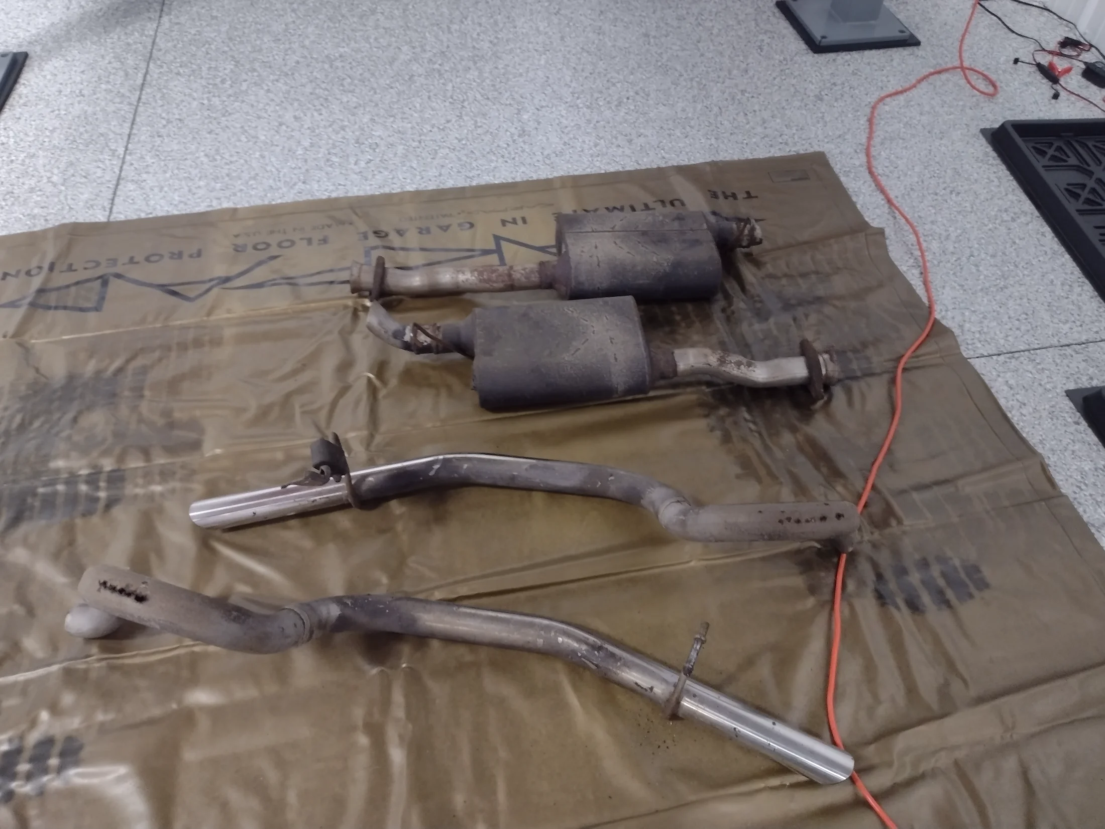

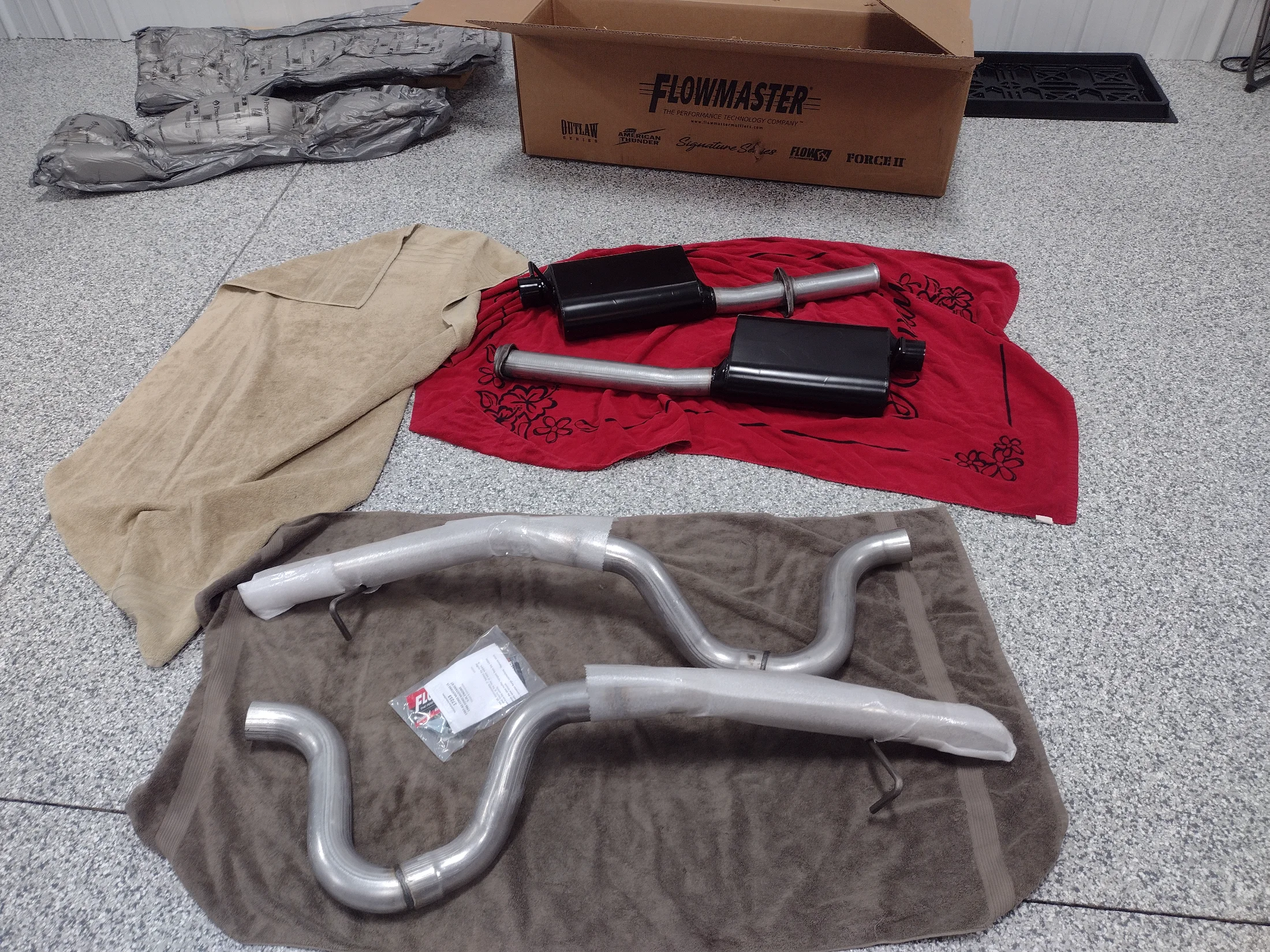

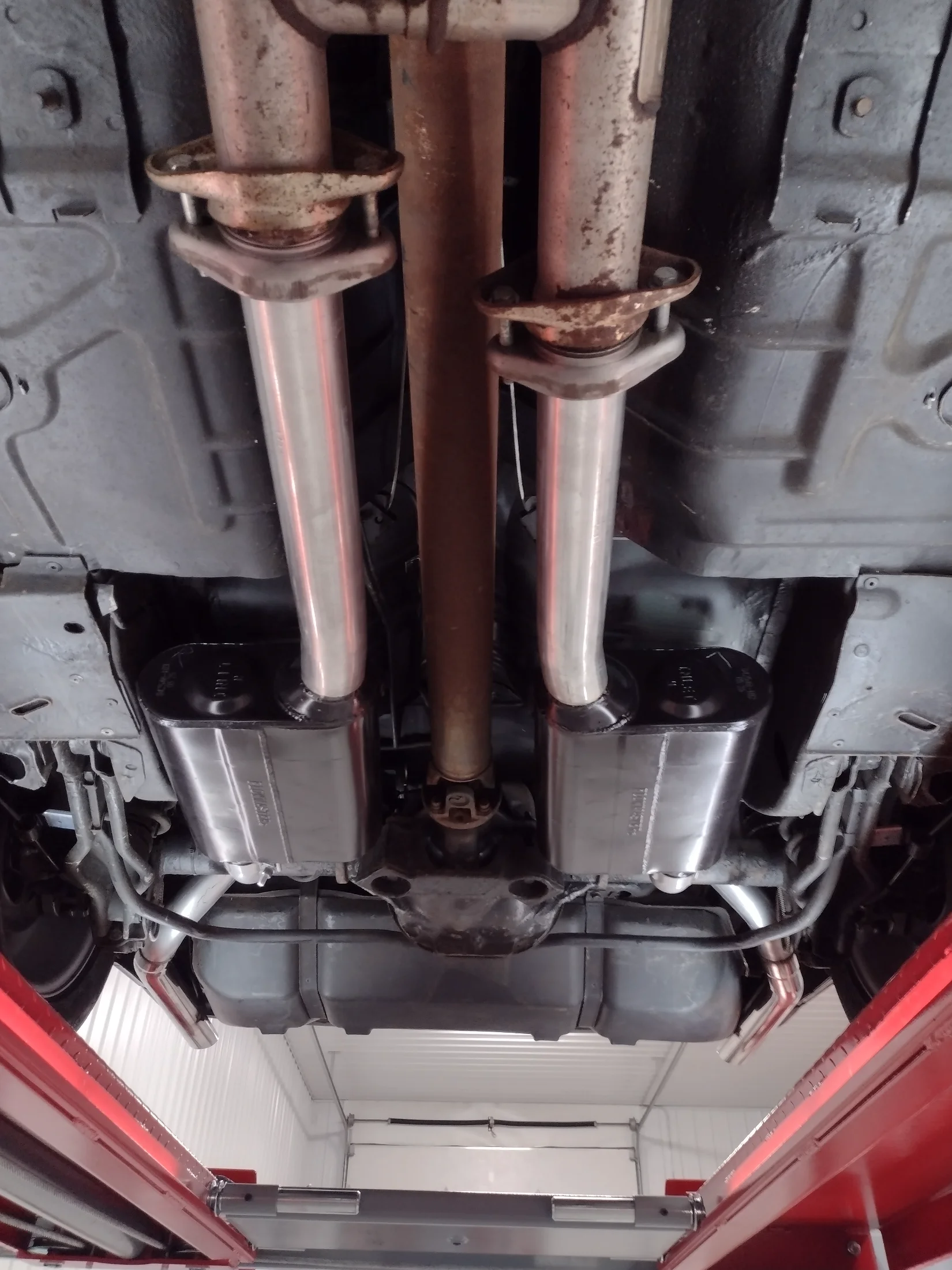

For starters, I just installed a new flow master american thunder cat back exhaust.

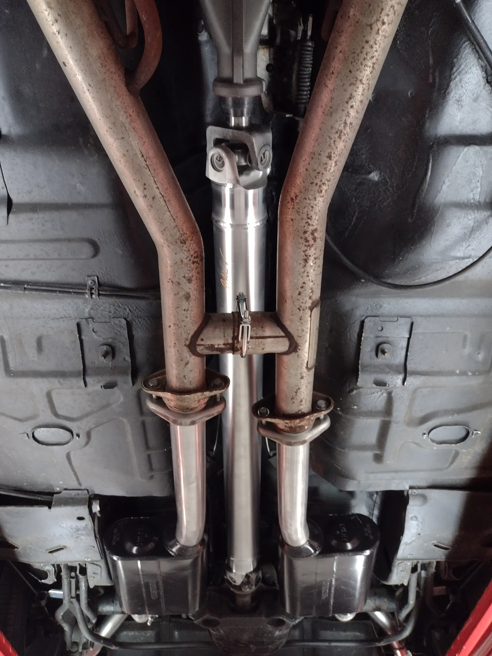

The good news is the exhaust you got works with the panhard bar. It's one of the few that follows the factory routing over the axle and therefore one of the few that works with the panhard bar an no "adjustments" needed.
So if you decide to do it down the road it won't be very involved.
