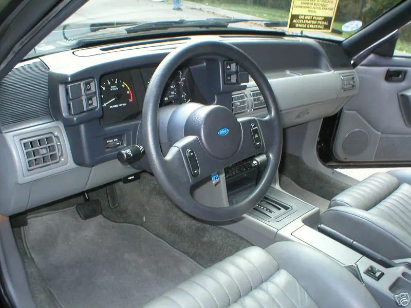

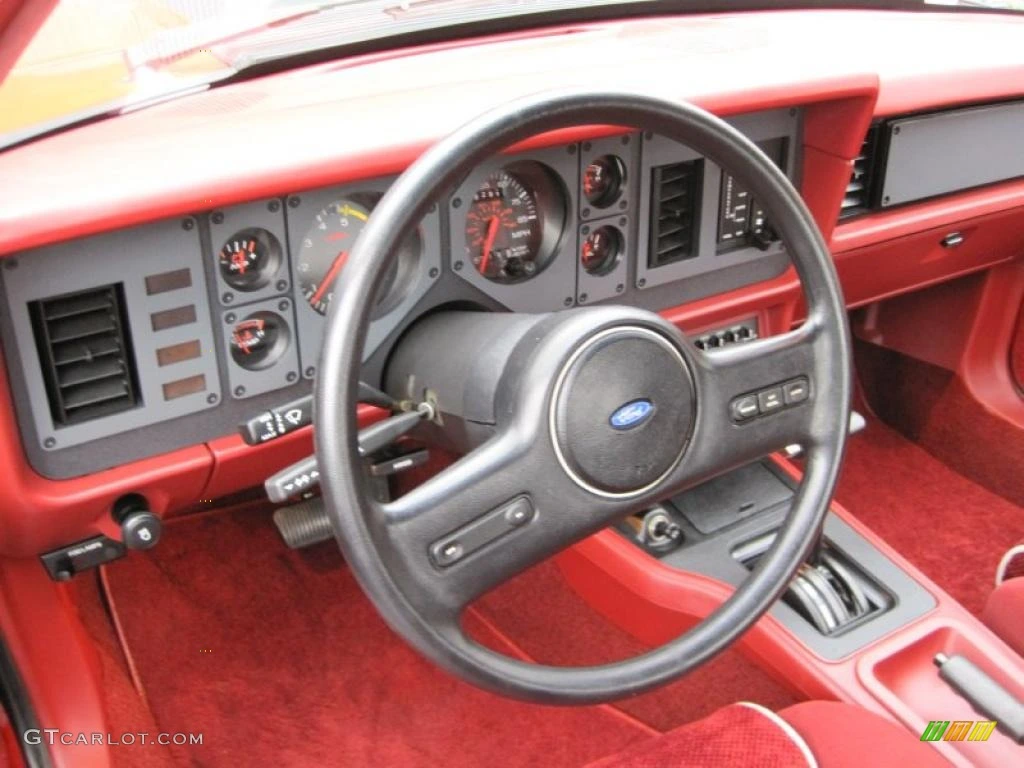

This is a typical 1986 dash
And this is 1987
Outside was completely different as well, and even the 5.0 engine is different. Have you decoded the rest of the VIN? What is the 6th and 7th digit (body style) and what is the 8th digit (engine)
And this is 1987
