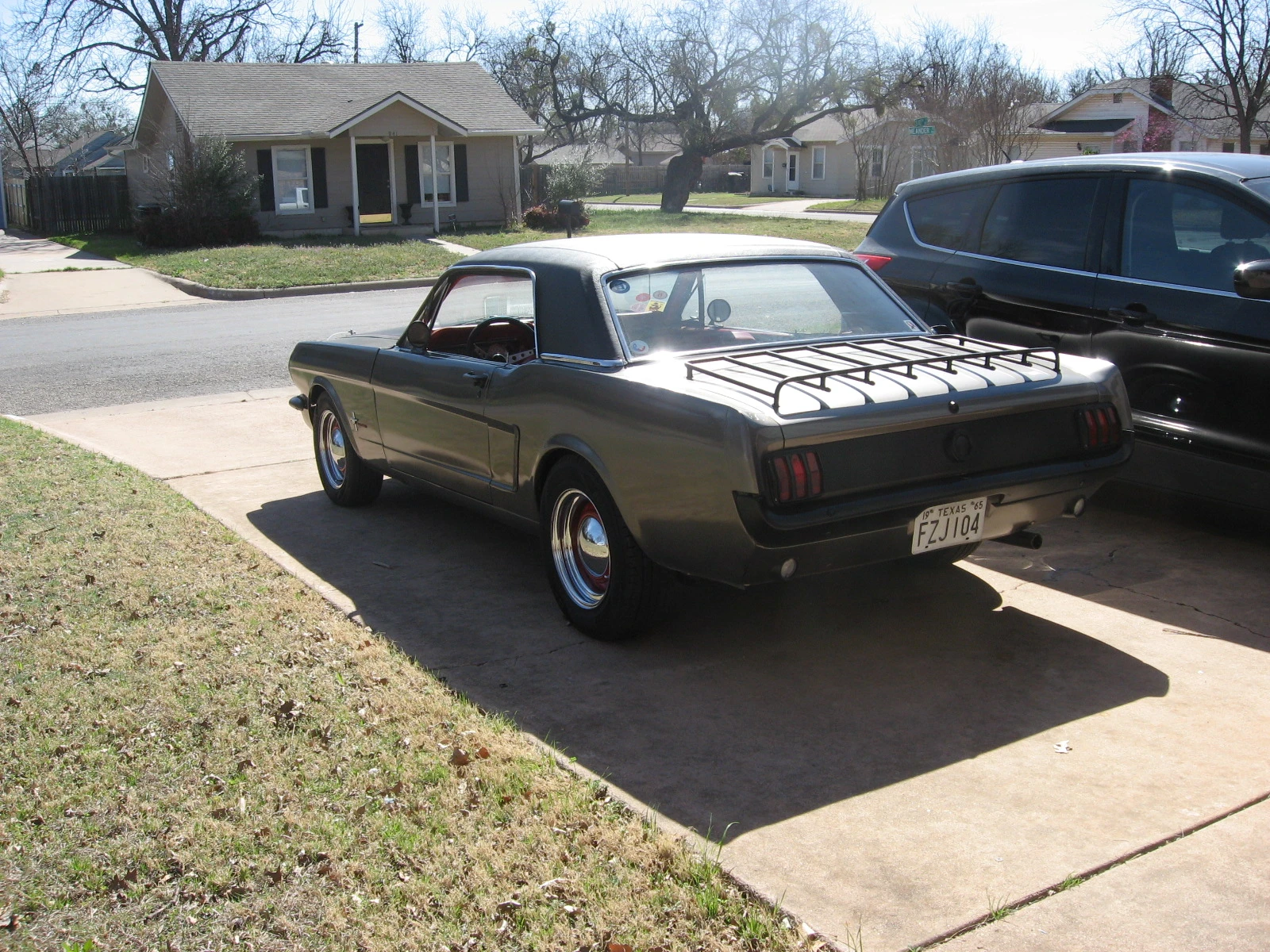

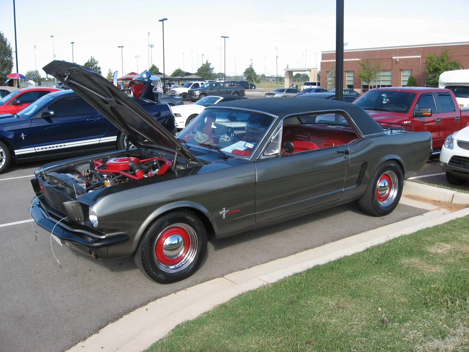

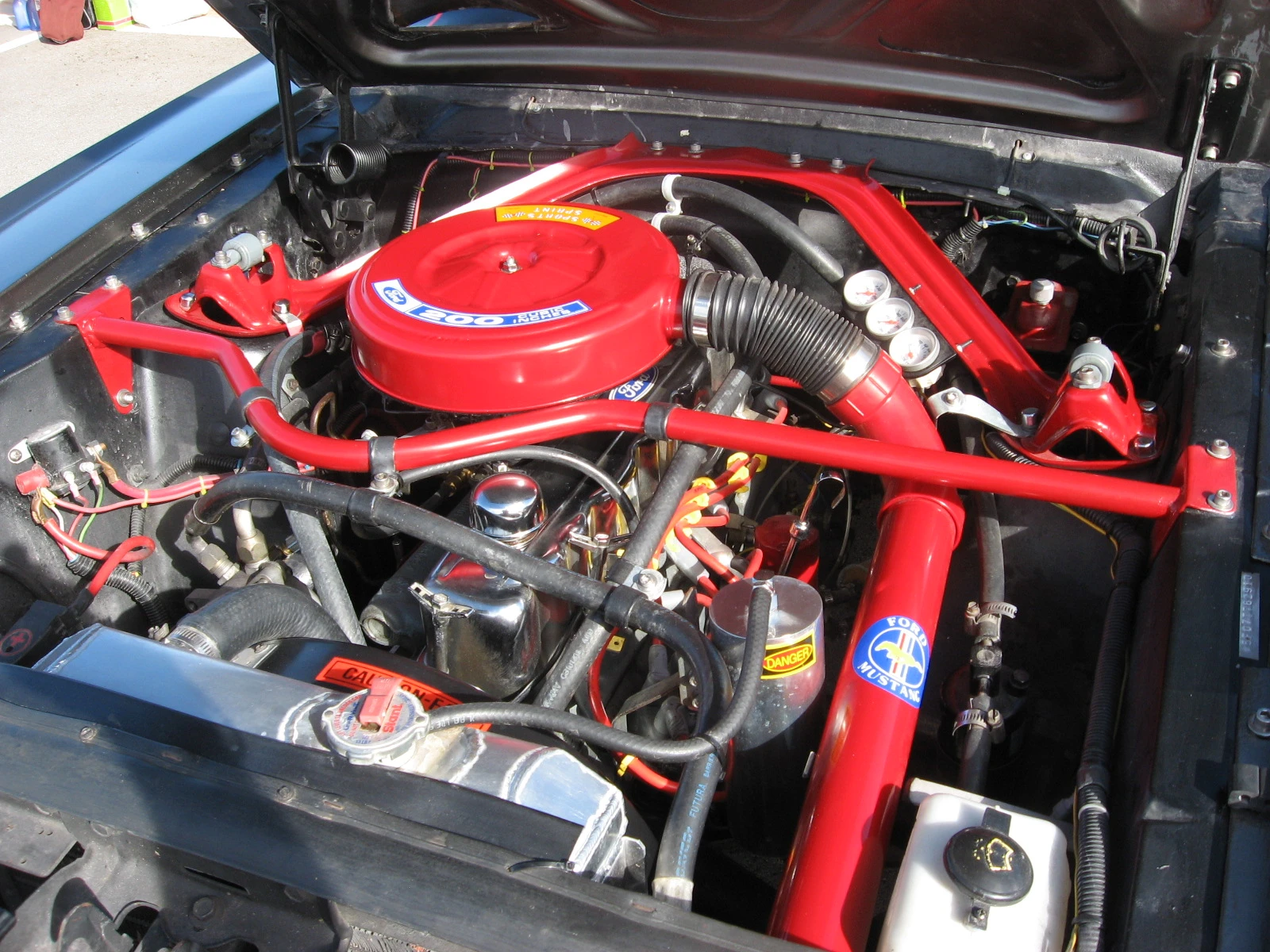

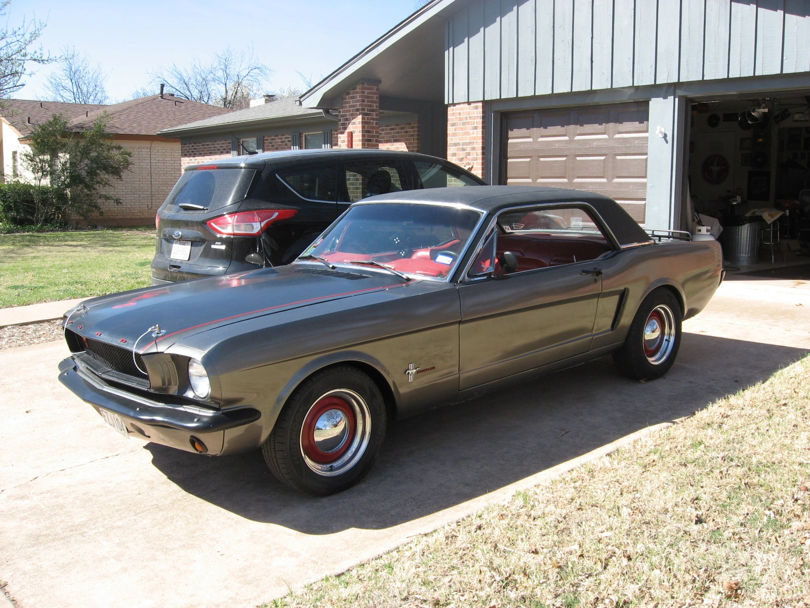

For those who think the old Pony is not road worthy, I just finished a 2,275.5 mile trip in my 1965 modified SIX cylinder coupe. A .060" over bored, 2-barrel, exhaust work, hot ignition with modified suspension, front disc brakes, air conditioning and 15" radials. The SIX will not out run a V8 but it has a place in the Pony corral. I had no trouble staying with guys in the NASCAR lane doing 75+ and passing was not a problem either. I have always been a big V8 fan and I still am, but do not sell the Inline 6 with 7 main bearings short. It now has about 35 more HP than when new with taller rear tires, which help it get 24.5 MPG without Overdrive...and the AC was on all the way.

Funny how age changes your FUN FACTOR. I'm starting my '66 F-100 resto now,I took it off the road about 5 years ago when the rot got so bad I couldn't open the drivers door anymore. It is a 390 4spd 4x4 now and I am seriously thinking about using a 300 I have for the new build. Looking at the Clifford mods for it, Also going to do a 4 wheel air ride system with a 4 link, Just because it'll be a fun project. :) PS; I like the gauges under the hood there, nice touch.
The gauges under the hood is an old race trick for easy tuning. One should be a vacuum gauge, but mine is oil-volts-temp to check while on the road. For years I had a Ford pickup with the 300 inline and it worked great. Down low it makes more torque than the V8, and pulling loads was never a problem. A buddy raced a 240 inline with 3 two's, big cam, serious internal work...which I did not understand at the time, and it NEVER broke. This was a front engine dragster that ran strong. He started with a 1940 Studebaker coupe running a 240 SIX called, "The Elongated Hole"! At the track the announcer said he would not touch that name with a 10 ft. fiberglass pole. What happened was, when they removed the body thy did not put enough bracing inside the body, plus they did a lot of welding on the frame causing things to twist and warp. When they tried to fit the body back on...every hole had to be "elongated" to fit. If memory serves, it ran strong 13's in the full quarter mile back in the late 60's. I am sure you know the 240 is a de-stroked 300 and with a 4 barrel, cam, header, head work, hot ignition and B&M Hydro it was close to the 12 sec. mark, even hitting high 12's on occasion. The V8 gassers had to spot him and few could beat him.
