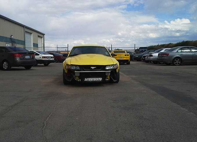

FINALLY strapped her to the dyno.
Im very pleased.
Completely stock top end (heads/cams/POS plastic intake/65mm TB)
421rwhp/415rwtq @ 10psi
Tuned by Richie @ EPT Motorsports

Well...that makes me curious what the "much more" in your sig means. I'm completely happy for you and your awesome numbers. I follow your posts when you contribute but I'm green with envy.
I know you got a D1 instead of a P1. But I am making 2 more lbs of boost and about 30 less rwhp and 20 less ft/lbs of torque. GFDIt!!!!!
Car looks great and get out there and wind that mother up. Boost is awesome. Enjoy the fruits of your labor, my friend. Awesome

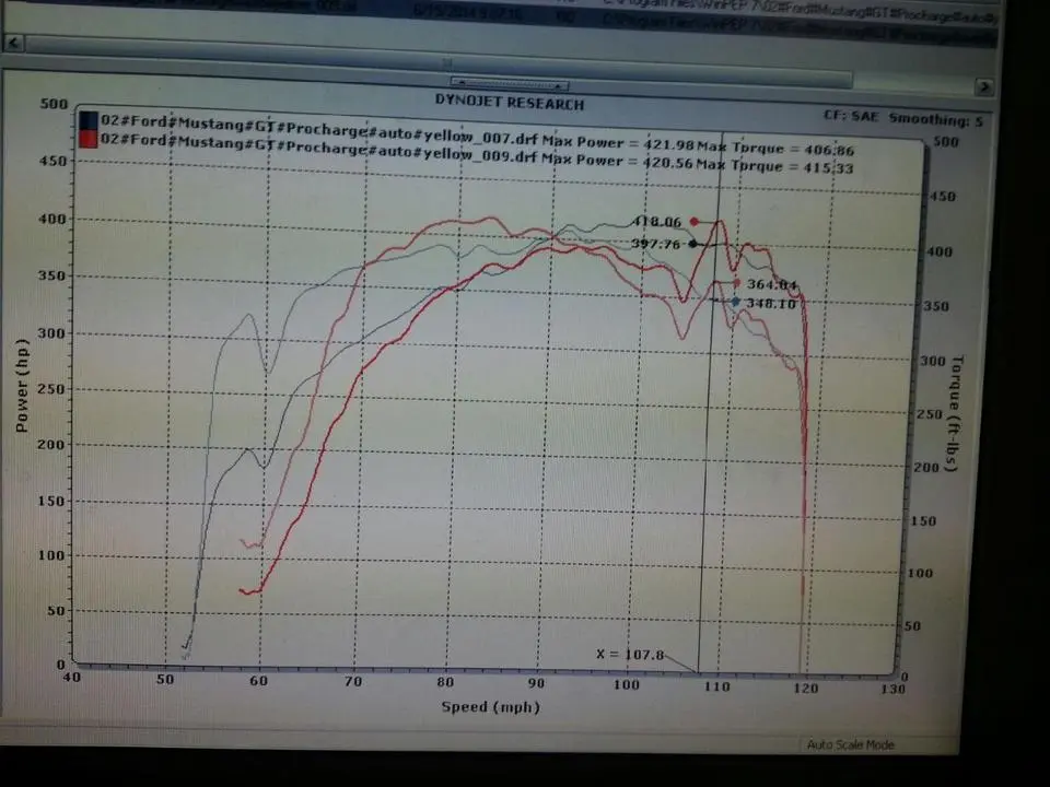

Just a little update.
I finally got around to asking my tuner for a pic of the dyno graph (since my dumbass left before getting one myself). He sent me one. I wanted to confirm that a max of 10lbs was made. He said he couldn't remember off-hand and would go back and check is logs. He message me back and said no, it only saw a tad over 8lbs, not 10. Here's the graph:
420/415 @ 8lbs.....through an auto......in a 6500ft DA. Time OD the crank and pulley down :cool:
Any idea why the graph looks so odd? :scratch:
