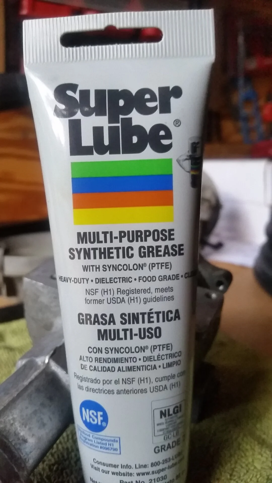

My poly bushings on the MM lca's we're driving me crazy too. I read everything i could find. Ended up on the Factory Five forums and eventually on the Corvette forums. Very OCD people on there. I can relate unfortunately. So most of them use this stuff. I went on their site and read all the specs. It's the only grease i could find that directly replaced the little tube of grease that comes with Energy Suspension and Prothane bushings. I really wonder if it's the same thing and they just package it. But the specs on this grease meet or exceed most any other grease application. It's even food grade so you can put it on your sammich. Oh, and it's dielectric so works for that too.
Anyway, bushings never have squeaked since. The only time i use any other grease is for wheel bearings and i use the Ford spec moly for that.
