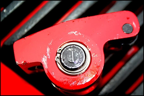

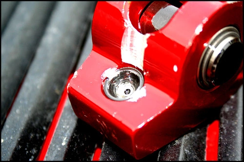

Well I took my car out for the first time last Sunday. It was going all good, except for some reason it wont shift into third... anyways. As i was pulling back in front of my house the motor starting running like crap and stauled out. I coasted into the driveway. I pulled the valve covers and was gonna adjust the lash on the rockers and to my surprise.......
I'm guessing the poly-lock was never tightened or it just backed out. I was so pissed when i saw this, i was sure i probably broke something, but i think everything checked out good. After this i made sure everything was TIGHT! Could have been a lot worse.

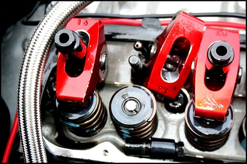

Here some pictues of the car before the Test Drive.

Looked like it broke off inside the rocker at first glance. Good to hear it all went back together, though.

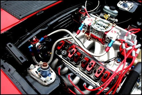

Man, that is not a welcome sight at all. Glad to hear the damage wasn't too severe. On another note, that's great looking engine set-up.

Lemme guess,solid roller cam right?
Did the same thing to me on my first roller,sad thing was I knew the rockers where needing a adjustment,but my father was in a hurry to get to the track.I just didnt think they would come loose!
File the tops of your studs,so they a FLAT (no burrs,no ridge- FLAT),and then buy a good set of stud girdles.
Went Jesel shaft rockers after,never had a single problem
edit: I didnt notice at first,but I see your polylocks are for a stud girdle,did you have it torqued even?
edit2: Oh,the rocker should be good,but if its hard tuning after oiling it up you'll probably need to replace the needle bearing pack.

Yeah its a solid roller cam, .620/.620 lift... I have a set of stud girdles sitting here but i didn't put them on. I was gonna put them on after i got all the lash's set but never did. They will be going on before the next run though.
