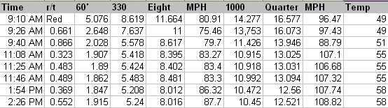

I love posting this one:
This demonstrates the learning curve from the first time I ever took the 65 (and myself) to the track. Learning to drive the car, figuring out little things like the car wasn't holding 2nd gear, learning launch RPMs, changing air pressure, how much burn out to do, etc.
I have a spreadsheet that I built that shows almost every pass I ever made in the car from 03' to the last time I raced it on slicks in 05'. My spreadsheet documents the major changes I made from a carb change, to open headers, to Vic Jr intake to another carb change.....
1st pass ever was a 12.53 @ 106MPH
Last pass was in 05 at WFC8 - 11.28 @ 119MPH
This just goes to show you that little tweaks and some wheel time can net some significant gains. I made this progress with the same motor with minor changes(same gears (3:70's), same stall, and the same Cam, same heads etc)
