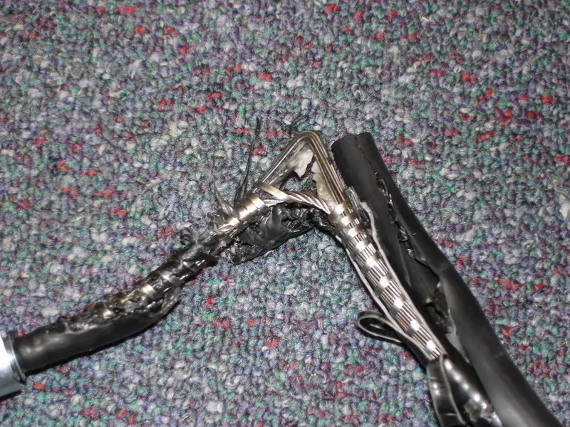

Well, I finally replaced the clutch cable yesterday. Here's a pic of the broken one. Looks like the casing melted, but I don't know how it got so screwed up.

Naw, it wasn't against the header. It lasted almost 3k miles. I'm pretty sure the engine compartment and headers just got really hot while I was trying to show this guy to drive it around a parking lot at low speed, then it went. I made sure to bend the bracket a little so that it was farther away though.
I'm thinking that putting some type of heat shielding on it would be a good idea.
