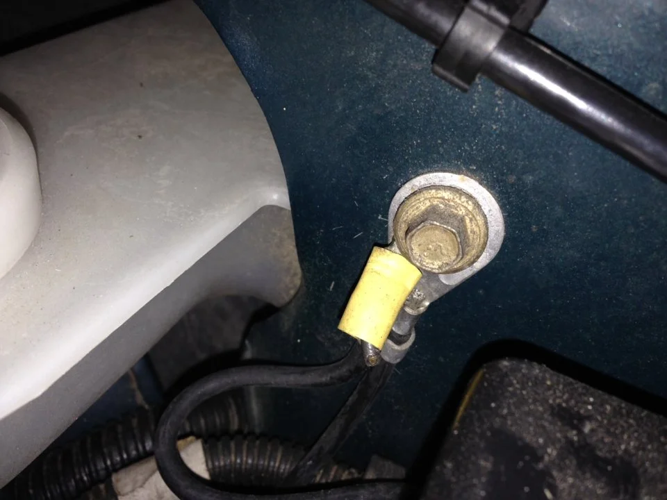

I think my next steps will be:
- Pull O2 ground (orange wire on back of head) to ensure good contact. Clean and reinstall

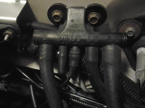

Dumb question #2, where would I connect the gauge? I ordered a gauge last night so I'll have it in two days.
I plug mine into the spare branch of the vacuum junction on the firewall.

I pull the O2 sensor ground bolt last night and cleaned the two connections (orange O2 ground wire and the metal wire that connects to the firewall). I don't know if I mentioned before, but about 2 months ago I found this bolt threaded in only half way. Both wires were spinning freely. Based on the resistance tightening the bolt, I would guess the bolt has been like this for a while.
I cleaned the threads, both grounds and wire brushed the back of the head (looked like it was a little rusty (surface). Everything looked good until I dropped the stupid bolt down the back of the bell housing. After searching high and low for over an hour I hung it up for the night. I cannot possibly imagine where this bolt landed. I searched from the top and bottom, around the tranny, frame, front suspension- nothing! I supposed it won't cause any problems if I can't find it, although now I need another bolt!
Strikes me as strange when the bolt likely slid down the angle of the bell housing, then should have hit the floor. I don't think it's possible for it to have landed on top of the tranny, but I'm out of ideas.
Think the dealer has this bolt on the shelf?
Home Depot, Lowes or Ace Hardware should have the bolt. All the bolts on the engine are standard US thread bolts, no metric or odd bolts on the engine itself.
O2 ground all set. That was fun.
