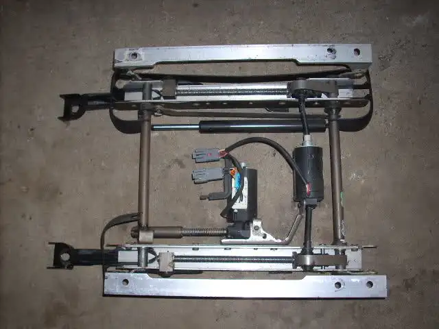

I actually have one, a really nice one.
$18 + another $12 to clean it up pretty nicely. 1 yard visited, over 20 mustangs between 1994 and 1998, where these come from. First vehicle, got this one!
