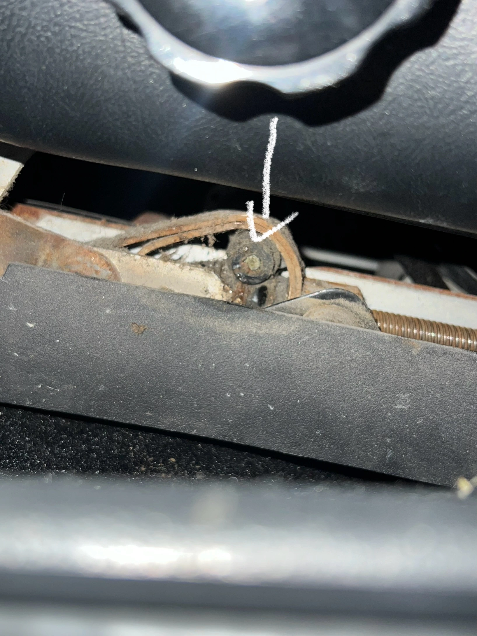

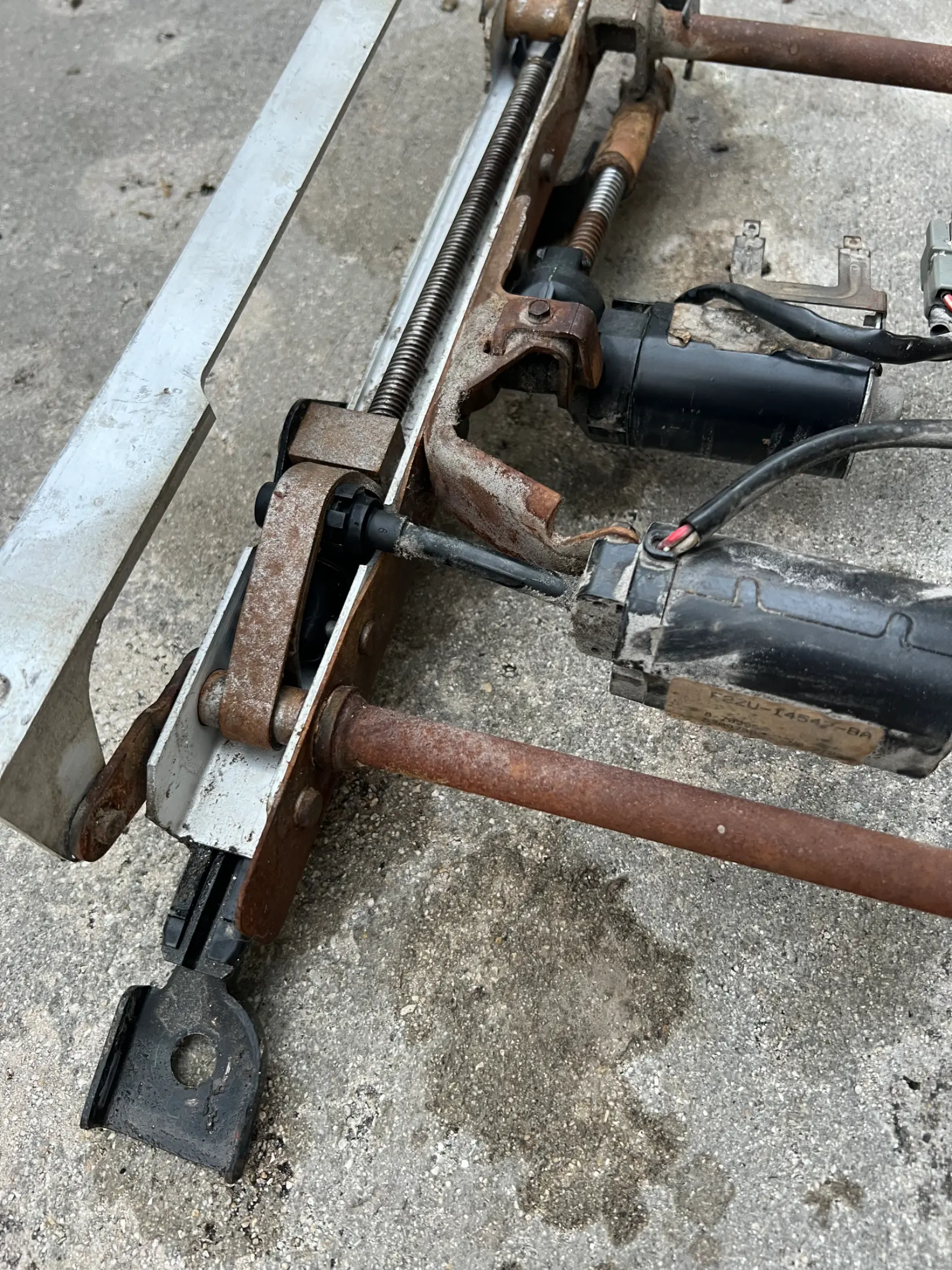

So I took a better look at what’s going on. The white part in the middle is spinning around when I press the switch and it’s not driving the screw gears, all that happens is that the white pin spins around.
Does anything stand out in the pic? Am I missing that gear you mentioned?
Maybe you got lucky and it's just a broke shear pin.
If the drive motor is spinning inside the gear then that's where the issue lies.
Clean it all up, and take it apart. Those jack screws need cleaning and lube too.

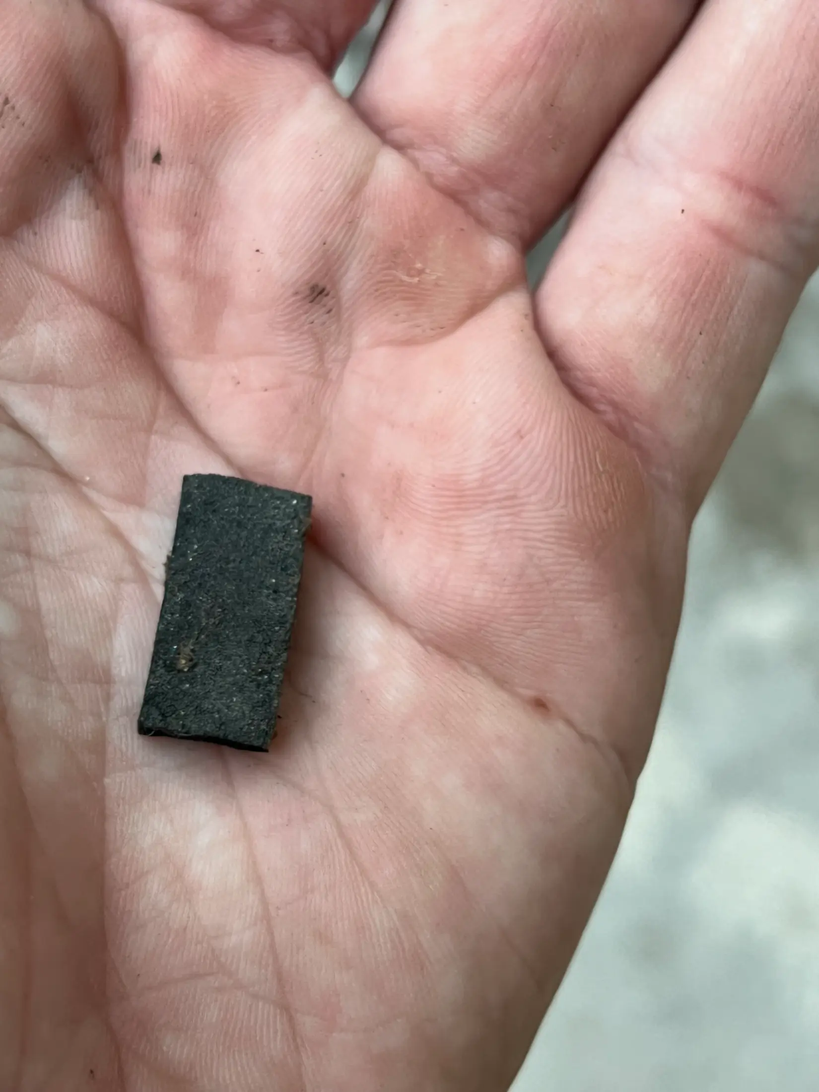

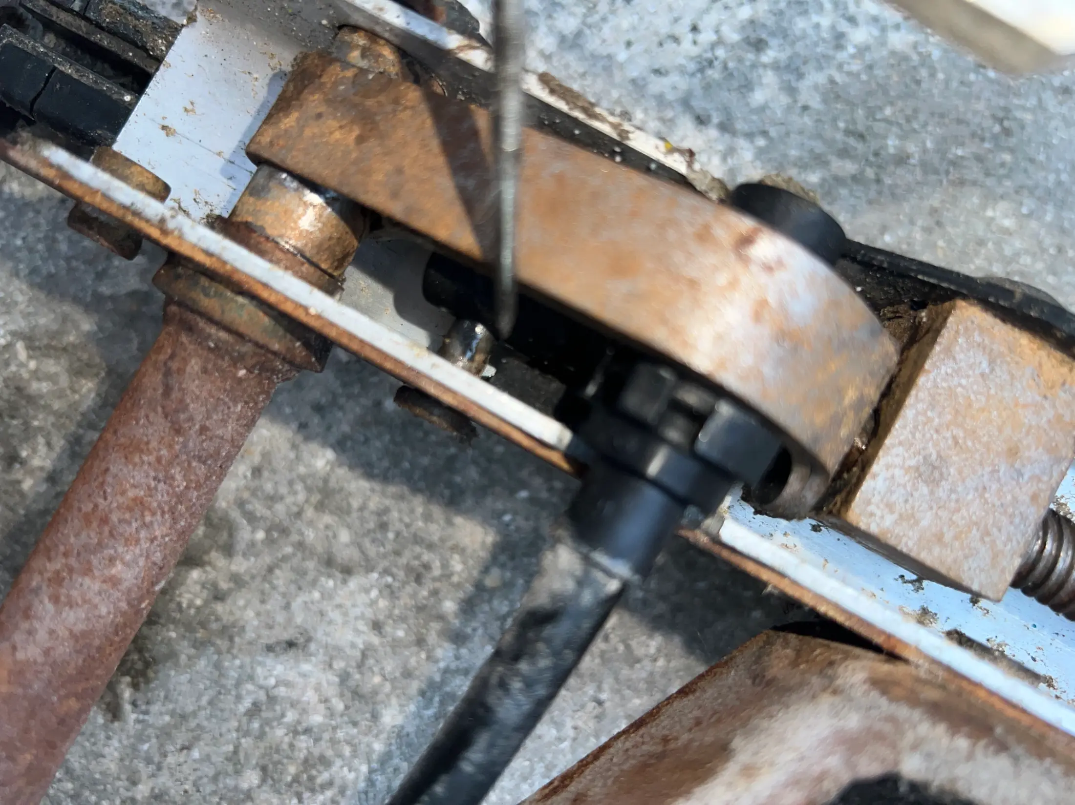

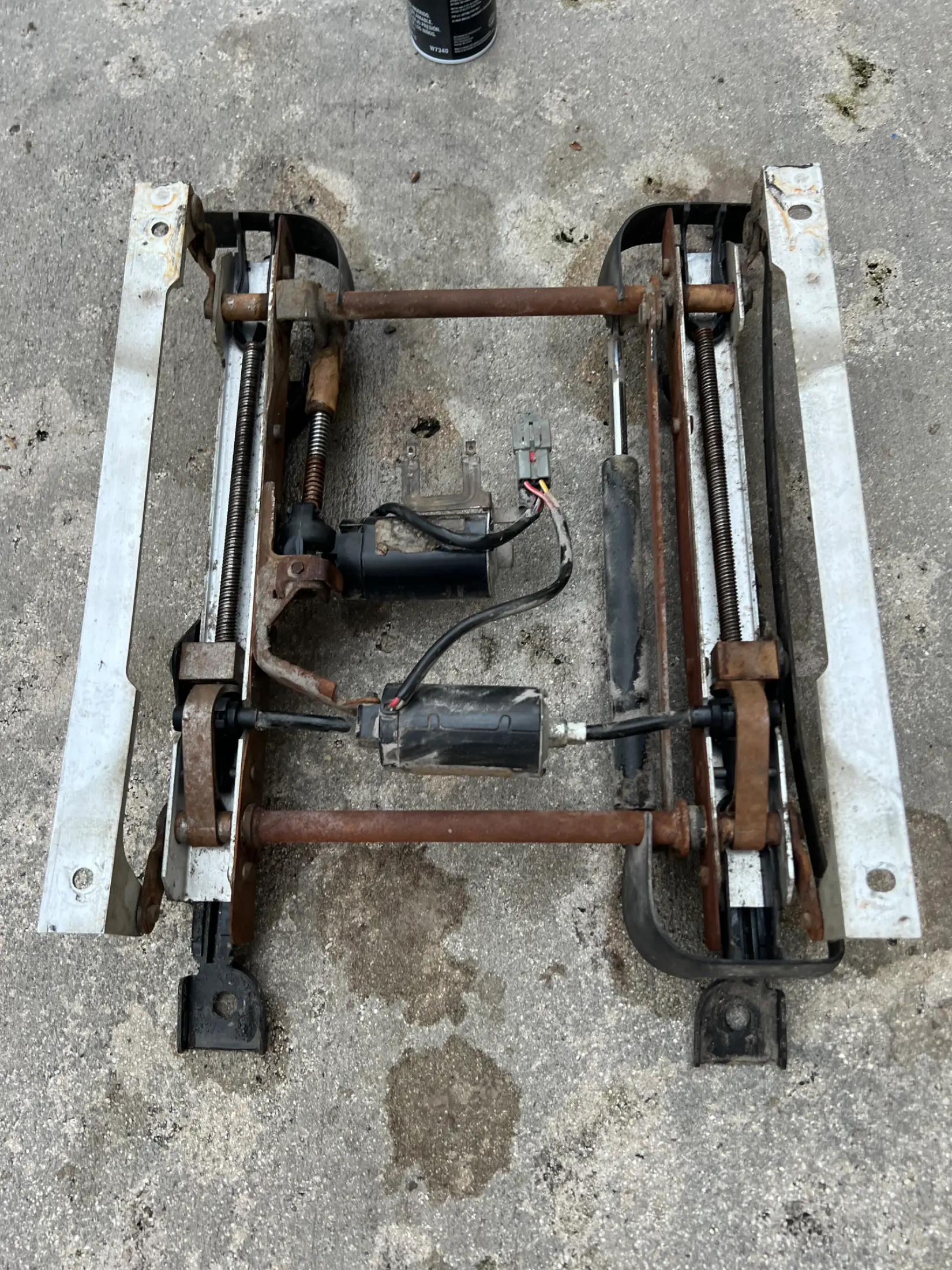

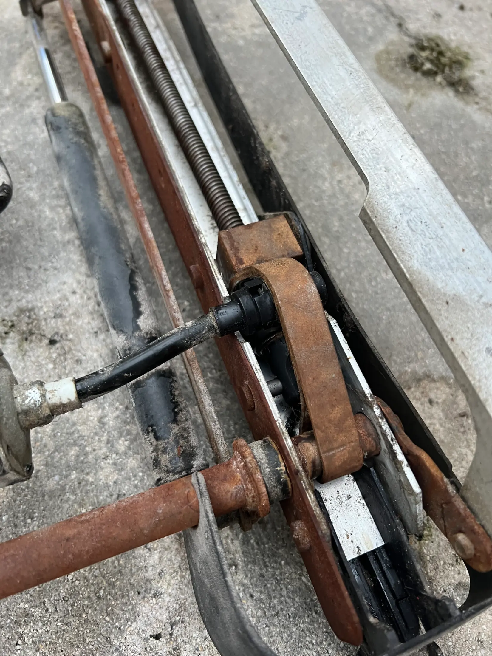

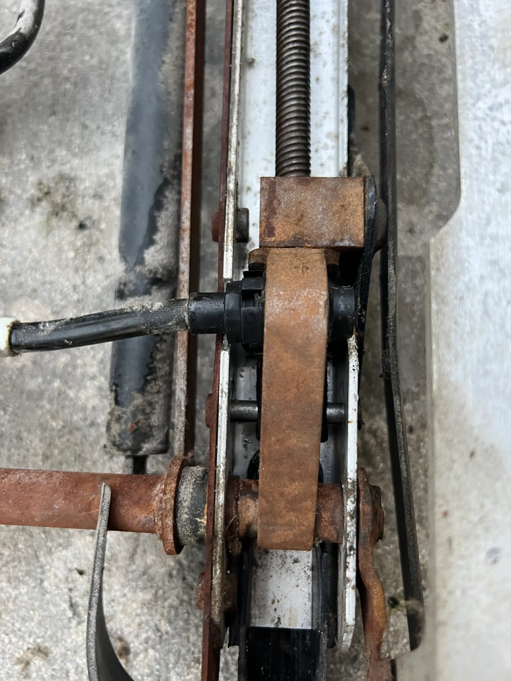

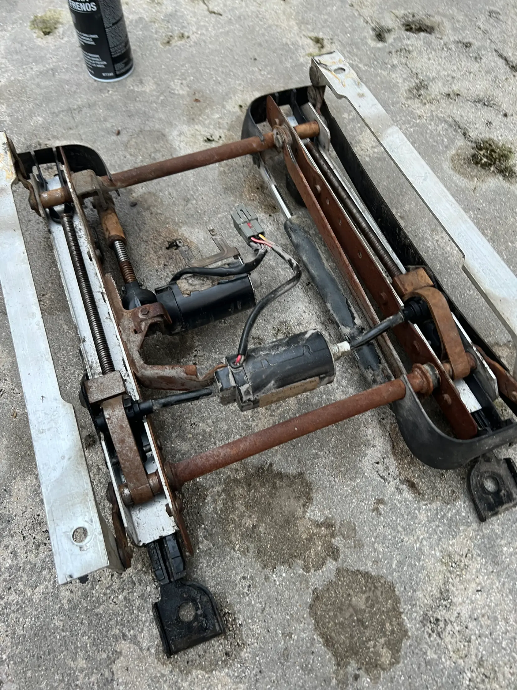

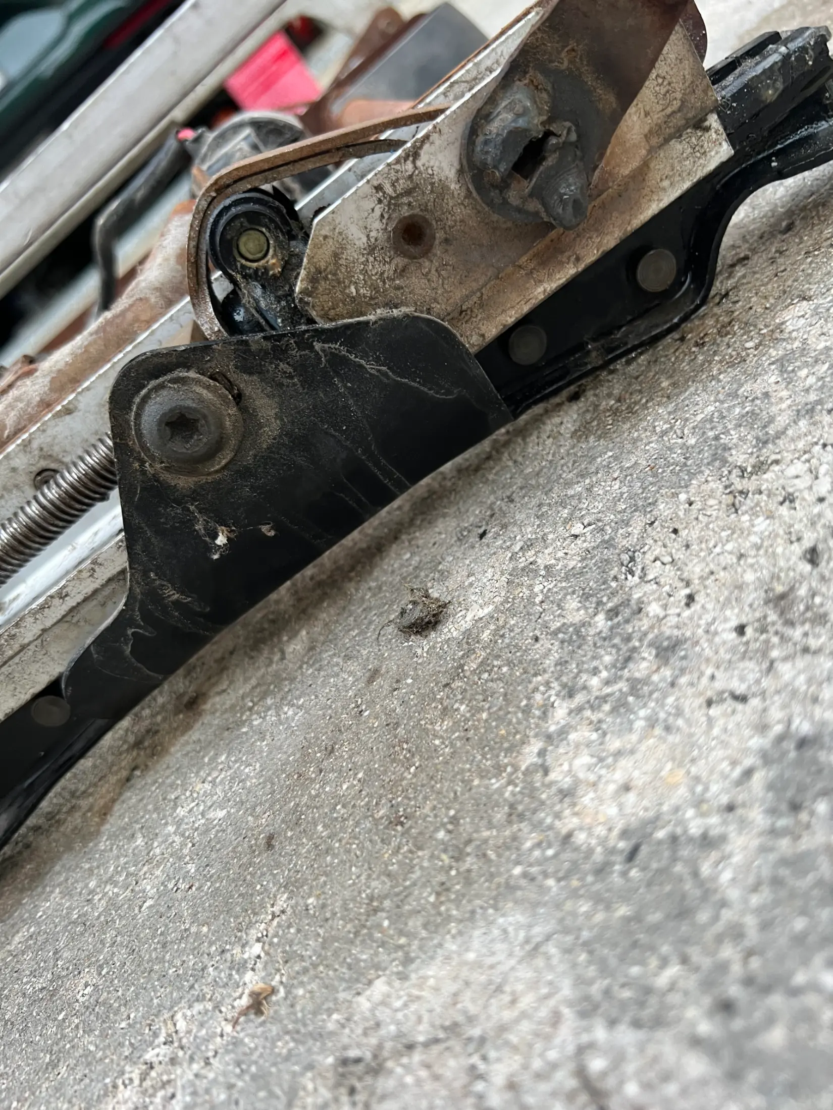

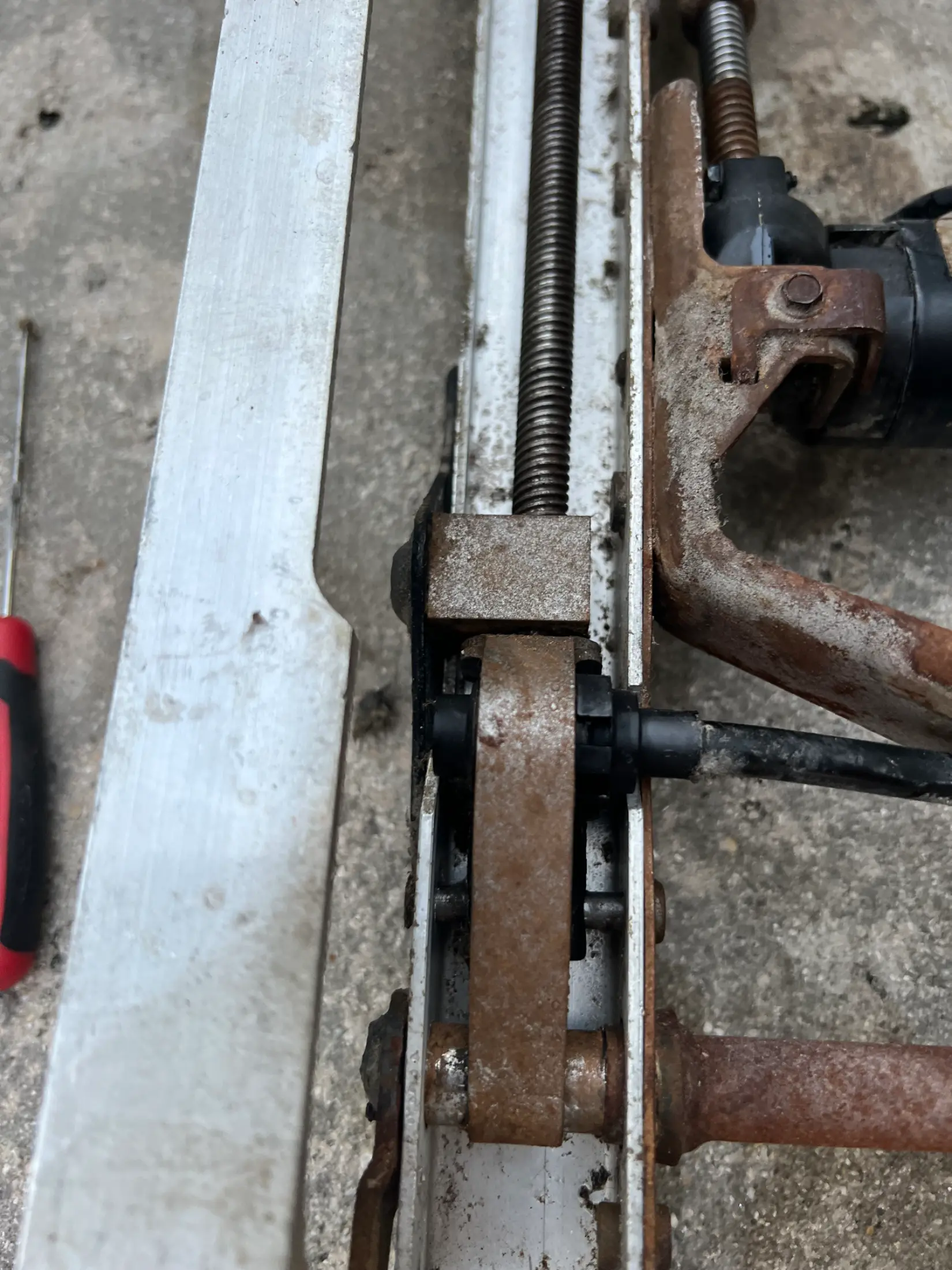

So I got the tracks off and cleaned everything up. The tracks were full of grime and dust everywhere. I cleaned it all up and even noticed a little block of foam stuck by the motor. I removed that as well. What exactly am I looking for as far as checking if anything’s broken?
Should I just grease it and see if it works?

Put it all back together after inspecting everything and cleaning and greasing. Still didn’t work. The good news though is I found out if I hold the button forward and nudge myself I was able to get the seat to move up so I can drive it again. I’ll just live with the power seats not working cause at least now I know how to move it if I need to. I plan on getting nice recaro seats anyway
Do they still make replacement horizontal and vertical motors for these seats? I have a 93 Cobra. I haven’t tried the vertical motor yet but the horizontal motor does “work”. When I press the button on front of seat, I can hear it and I feel the seat move slightly forward and backwards, but it doesn’t move much. Could I possibly need a new horizontal motor?
