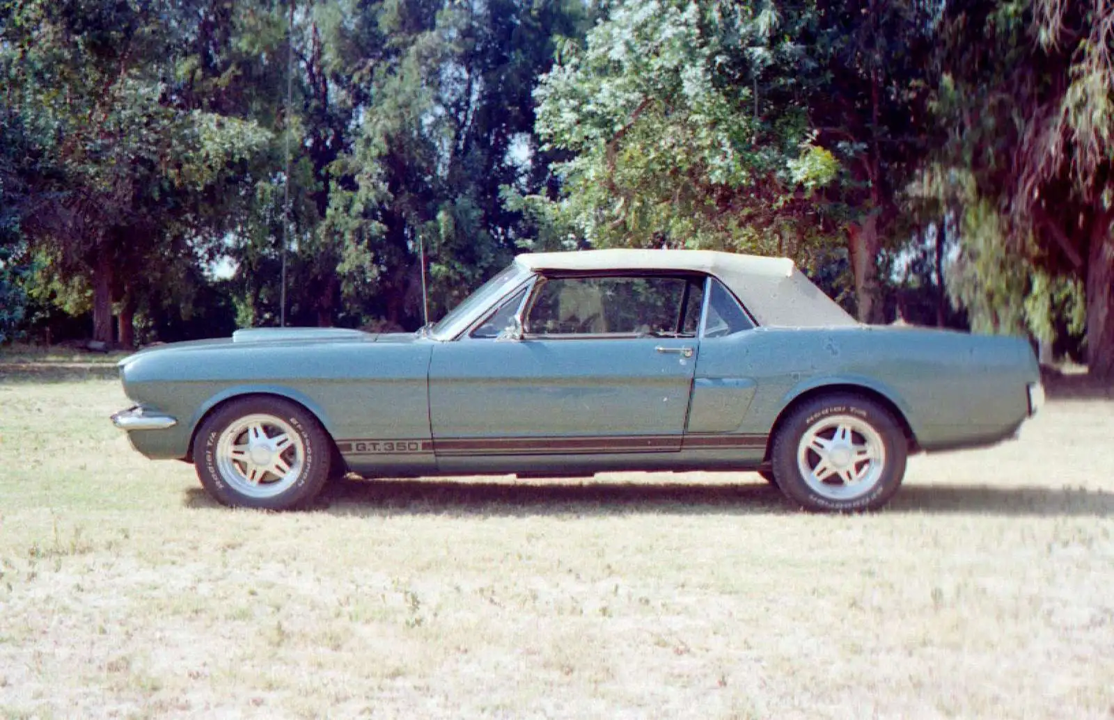

i assumed you were working on a convert. a coupe will be much easier. i built a convert from a coupe. tweet is correct you will need to remove atleast 1/4 inch to 3/8 inch were the floor meets the rocker,also about 12 inches there about in the toe boards were the torque box slides through. it will not work to bend the flange as the floor will now weld to the bottom of the inner rocker. you will also have to cut the rear torque box so the inner rocker will slide through. it will be easier to just remove the seat boxes, and i would replace them with the convert box,it will lay right in place. convertible torque boxes in the front .you will have to trim a little bit of flange on the frame rail pinch weld on the side of the front frame rail as well so the convertible torque box will slide in .it will go straight up in place .you will still have to support the rocker and rear frame rail because the torque box when trimed will be completly seperated from the rocker. its not hard just needs a little measureing and trimming.
oh and slide the inner rocker in from the front .Jim
would you believe this is actualy a coupe? it was a blast to build, and and so easy to do you wouldnt believe it,all the convert pieces are available now through Dynacorn
