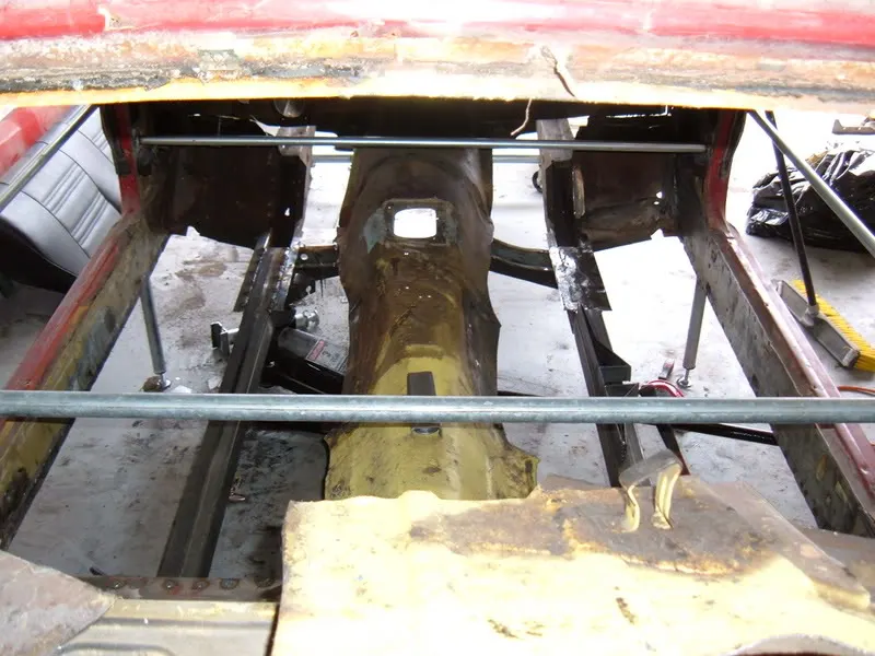

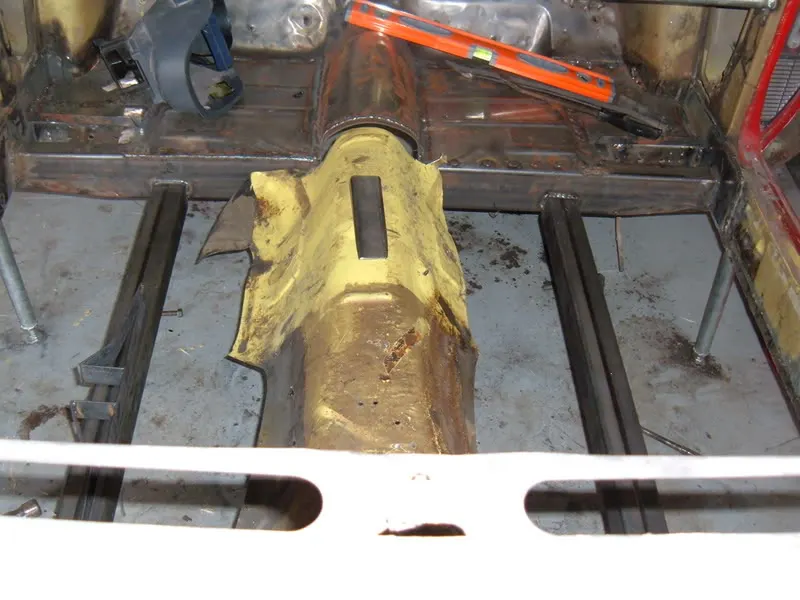

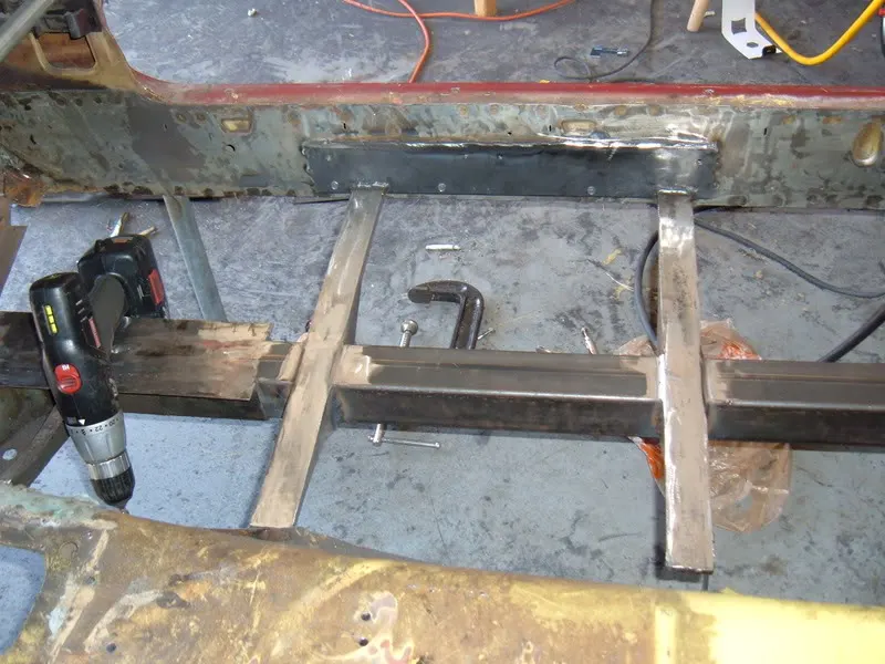

Huh, two different answers. Well let me clarify a few things, probably should have added some pics before. The car will get a 4 point cage, I might add door bars.
Here are a few pics of the subframe I built, these are not off the shelf subframe connectors by any means. Off the shelf subframe connectors are using ~1/16 thick, these are 1/8. The rear torque boxes have been eliminated and replaced with a 2X4 crossmember. The front torque boxes will also be eliminated and replaced with 2X4 box. The firewall will be cut out and replaced with a flat sheet and reenforced with 1.25 square tubing runing across the entire firewall and down the sides tieing into the 2X4 tubing that is replacing the torque boxes. I can't think of anything else I could add or beef up, but IMO the car is solid.

Based upon what you have done, I guess that beaded 20 gauge would work. (to keep your feet from dragging on the ground and dropping your keys on the ground)
Not knowing what you have planned for the car, well you are on your own...

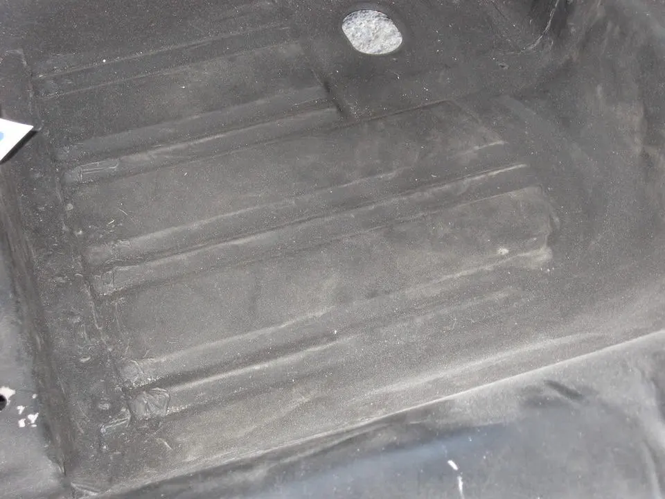

Here is a picture its just a stock mustang floorpan, theses "ridges" create alot of rigidty. Try and bend a flat piece of 18 guage metal, the try to do the same thing with 18 guage that has the enhanced structural characteristics of these "ridges" and you can see how much it helps. This it why anything built with sheet metal normally has them. Though like I said I am not an engineer and truely don't know.

Not on the sheet metal for the floor, but you might get into issues with the frame, its connection to the rockers, and your cage. There may be restrictions on fire walls though. Of course, it all depends on how fast you plan on going... and who's track you are on...
If it is going to be mostly on the street, you should be fine with rolled 20 gauge and the supporting that you have established. If anything, I would consider connecting the rocker panels to the subframes (it looks like you are mostly there), and then you need to provide a cross connection between the sub frames (perfect for a drive shaft loop).

John, thanks for the input. I am not quite finished, and I have not posted recent pics. I have connected both subframes to the rocker panels via a 1/8 plate welded to the rockerpanel. and I have already got the cross connections worked out, I am going to finish welding them in today. Thanks for the input.
I don't have the tooling to be able to roll that size of ridges/beads. However I do have a bead roller and I plan on rolling in some beads. The bead roller I have can roll 1/4, 3/8 or 1/2 beads. I think when you refer to Ridges, you might actually mean beads.
