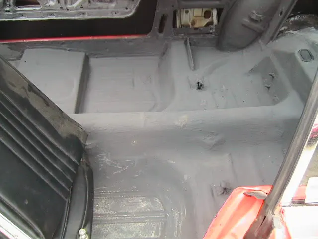

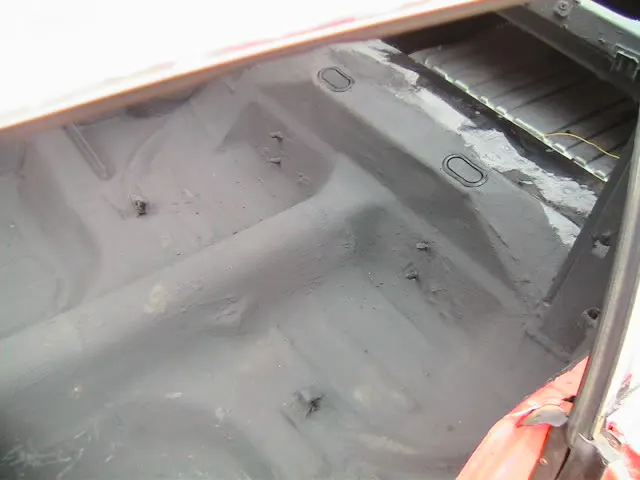

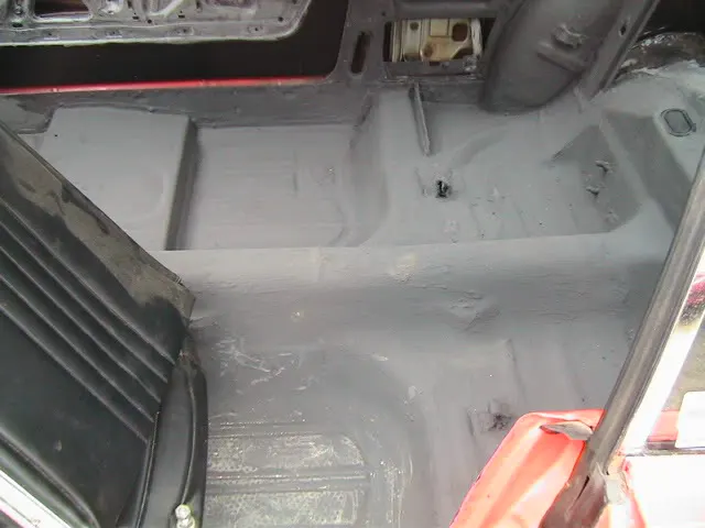

Hey I just thought I would take some pictures of the work I have been doing on my 65 and show them here. I bought some of Eastwoods Rust Encapsulator and pulled everything out of the interior to inspect for rust and protect the floor from further rusting. I actually didn't have to much rust thankfully. I have a couple pinholes and a larger hole on the passenger side pan. So I proceeded to remove all of the old seam sealer, loose paint and crap off the floors with a scraper and wire wheels on a drill, it took a long time but it all came off ok. Cleaned with soap and washed. Then I applied the RE everywhere that is not going to be seen...in these pictures not everything is covered yet and the RE is still wet here but I have since pretty much finished. I have some paintable seam sealer that I bought from eastwood that I am now going to use on all the seams next. And tomorrow I have some Lizard Skin Ceramic Sound Insulation and Thermal Insulation coming. I am also going to order a new carpet from ACC that will have their 'mass' back to further help with sound reduction. I will post some more pictures after all the steps and I will tell you all about how well the stuff works out since I don't believe there are many real experiences here yet with Lizard Skin especially. But I would highly reccomend the RE, I have used it on my trunk previously and it is easy to work with and dries really nice looking even when painted with a brush.

AFTER:

Thank you! I was told by a forum member here that I did not need to. The directions on the can also said to just remove loose paint and loose rust. The RE dried fine and adhered well to all the surfaces; painted, rusted, and bare metal.
