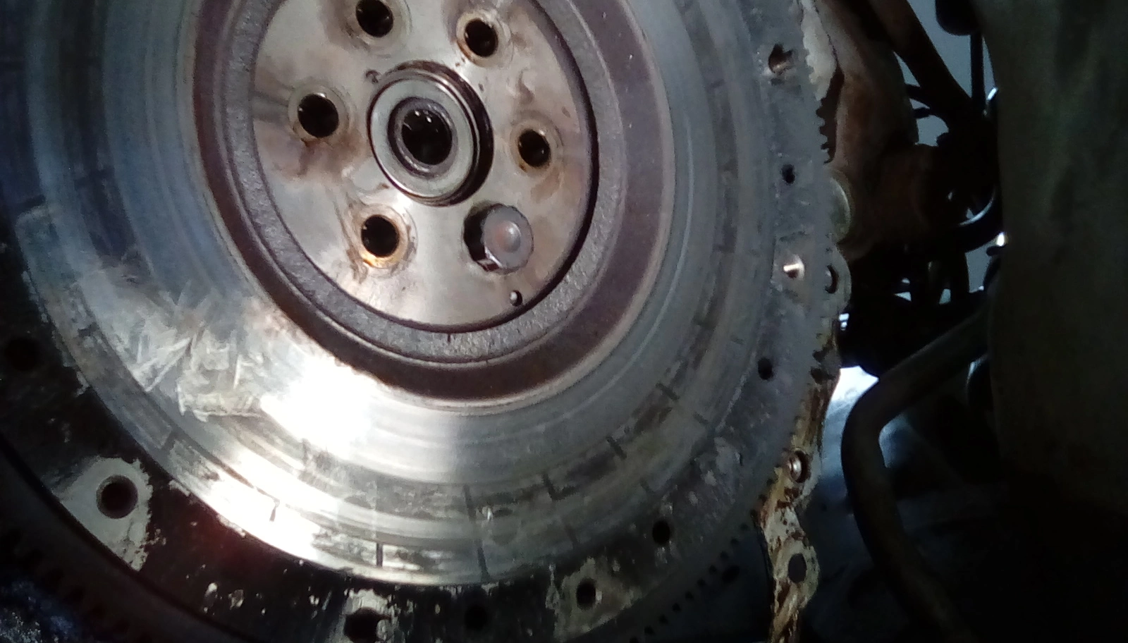

I took everything off, the rms has no oil on or around it, the back of the oil pan looks like it’s leaking a tiny bit but I still can’t find what was causing it to leak out on the front side of the flywheel in between the clutch. The only thing that stood out was the oil pouring out of the flywheel bolt holes as soon as I took one off
The Windsor cranks are drilled and tapped threw .In other words the flywheel bolts need a thread sealant, it is a must.

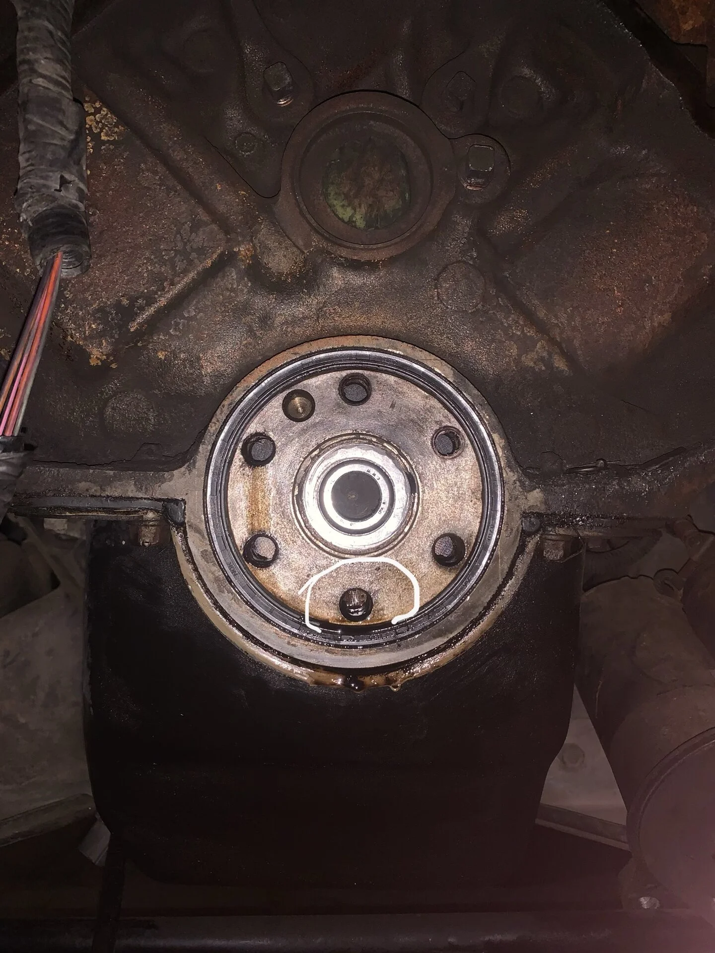

Alright thank you I’ll try it out, I think this is the hole it was leaking out while the flywheel was on but there weren’t really any oil marks on the flywheel except at the very bottom bottom where it was dripping.
