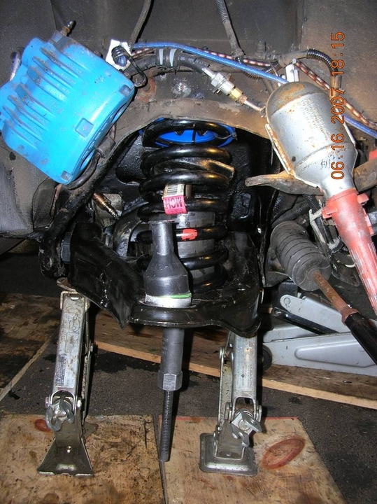

Yea, I should rotate that picture. :) If you look at the center of the wheel well, right above the center of the spring, you'll notice two clamps for the brake hose. It's very tricky to get the right position for the clamps to allow for the full turning of the wheel and accounting for the fact that the wheel/FCA will fully extend at times. It's not impossible. But, it'll take a little time and maybe a couple of tries to get it correct.
Also, I use gas hose over my SS brake lines so I can gauge how much rubbing I get. Note: The clamp location depends on the particular SS brake hose, or the particular rubber brake hose. As I said, to prevent rubbing at full turn with the FCA at normal, fully compresses, and fully extended take a little effort.
Also, use metal clamps and use some sort of rubber isolator. I used tie wraps to keep the rubber in place on my metal clamps.
