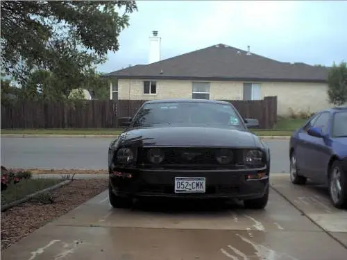

I went with a 35% smoke tint. Two reasons... One to blend with the blackout look, and two to hide the RED and BLUE strobe elements. Both the driving lamps and the strobes are in use, on seperate circuits.
I looked at 20%, but this would render the driving lamps useless.

That looks sinister as hell! Red and blue strobes? I think you just made the worlds meanest looking interceptor. For Gods sake, take the photos off the net! I don't want the OHP getting any ideas!

Thanks for the compliments. Sinister is just what I wanted... All I did was tint the lenses and paint the pony black.

I forgot to add a couple of tips...
First, this is a cheap mod ($5-10), if you remove the lamps yourself. Remove the grille by pushing in the tabs and pulling toward the front of the car. Then remove the 4 Torx screws and the adjuster assembly on each side to allow the lamps to come out. When reassembling, the VENT tube is clocked to 12 facing the rear of the lens. Both lenses are the same part number, and only go back in correctly or 180 degrees off.
The lenses are NOT perfectly flat, so expect 3 small wrinkles (One per 1/3 of the OD on each lens). Do not try to cut, because when the tint overlaps itself, it is MORE unsightly than the three small wrinkles. You cannot see the wrinkles standing right in front of the car.
Use CARBON based tint, which is recommended to allow flexing and compensating for heat variations. This I am told is the best way to maintain a long lasting finish.

Crash, I can't view the pic. All I see is the red square. I'm curious about the LEDs, plus I like the blackout look. I'm a firefighter and want to add lights but I I don't want them to be visible when off. I like the tint over the lights idea to hide the strobes. I was thinking stobes in the turn signals (I would change the yellow housing to clear or smoke) so they'd be visible from the side but the housing is a bit small. Any ideas?
