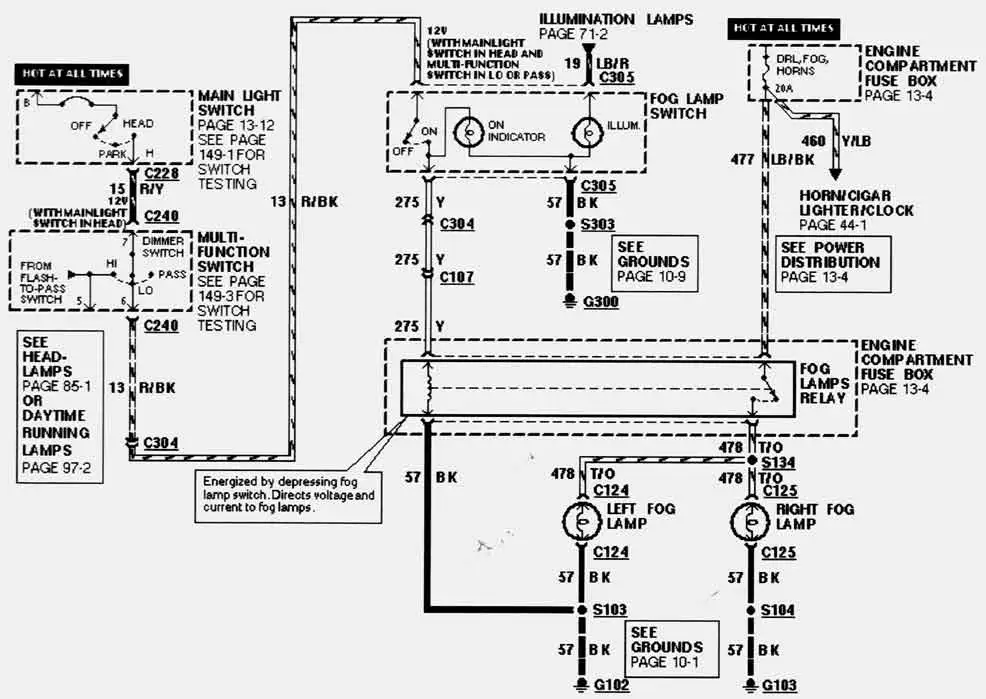

when you turn on your fog lights, there should be a little orange light on the fog light switch that lights up but on the other side of the switch there is a little picture of a light, is that supposed to light up at all too? j/w if mine is blown. thanks

i dont think its supposed to light up

Yes, that light diagram lights up. I just got a new switch and verified this. There is also wiring to the switch for this. The schematic also shows 2 lights in the switch.
FWIW- My original also is burnt out and doesn't light up. I'm guessing it's a common problem...

pretty sure just the orange led lights up

Nope, both light up. I took a pic of both of my switches, showing the new one lighting up and the old one not. The new one is in the convert top switch location. The center console is in my living room and I powered the lamp off of a power supply. I also tested my original switch and it didn't light up (either with the power supply or in the car).
I think that most peoples bulbs have burnt out a long time ago. This bulb is on anytime the headlights are, after all.

Yep, the switches that don't light up with the headlights are burnt out. I still have the stock one in full working order (although my fogs are burnt out) knock on wood. Just confirming since nobody else (with the stock switch) had.
