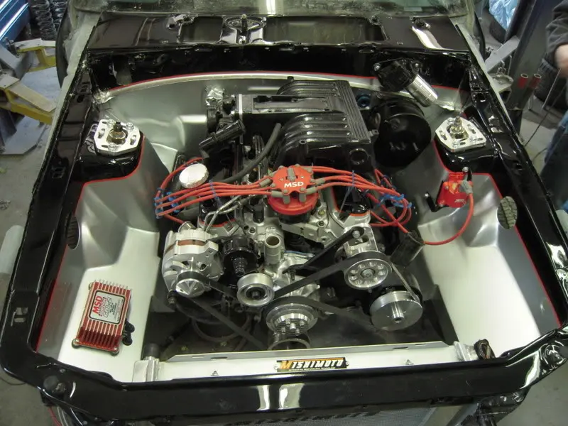

yea, cougars, fairmonts, lincoln mark VII's, mustangs. The holes all serve a purpose, just not on everycar. I have 80+ hours into my engine bay and it was so much work but totally worth it. The engine bay is so clean now.
I'm an engine bay pic whore (its all I got to show off right now) lol
man, i've seen some insane engine bays on this site.... but i couldn't imagine wrenching on a car with that kind of liability all around me, haha, one slip with a screwdriver or wrench and you'd more than likely have to kill yourself :rlaugh:

ohhh yeah haha its not too much fun. after awhile you just say screw it, its not a show car, well at least i did
mac n black your bay looks awesome
