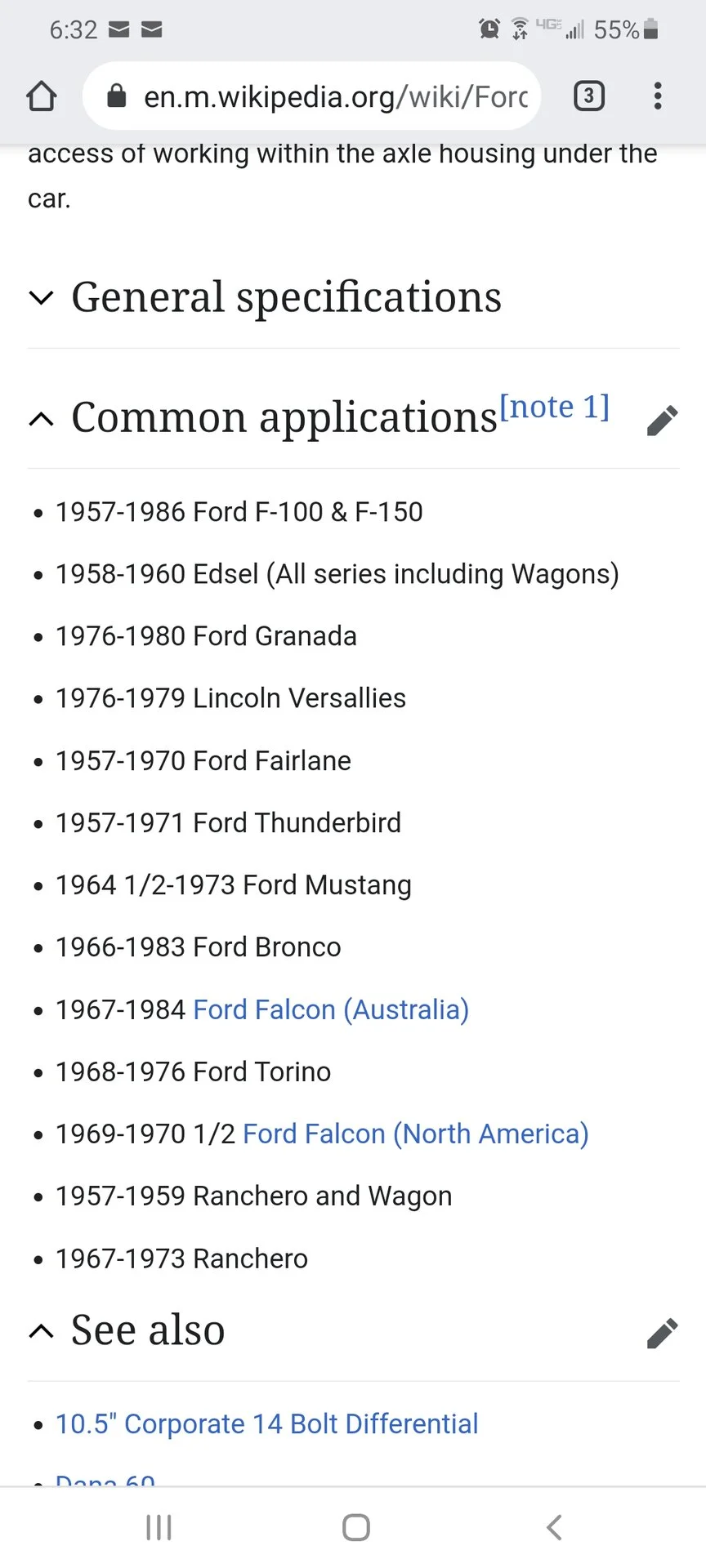

You can luck up and find a 9 inch in an old Ford truck or motorhome. The housing will still need to be shortened, leaf spring mounts cut off, the center section may need hybrid u joints to mount to the driveshaft.

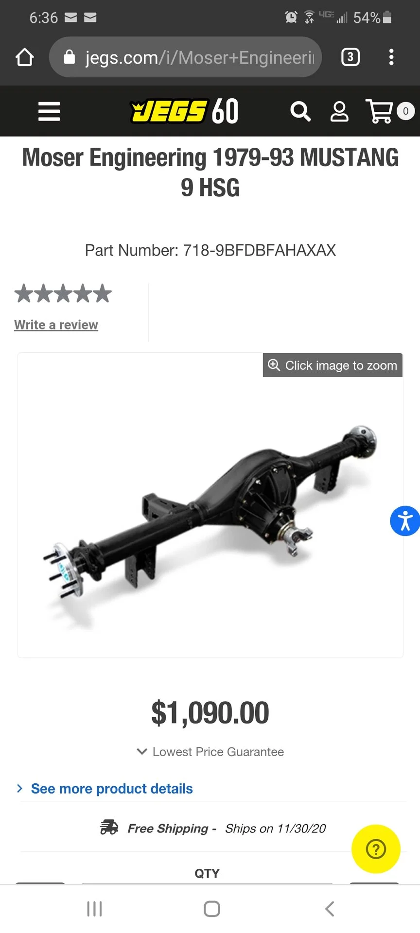

The cheapest quickest option would be to buy one new, complete with axles and brake caliper brackets.
The 11.65 brake conversion is available from 200 to about 400 bucks. Takes the guesswork and time out. Think about crawling around trying to find some junkyard rear thats not a rusty mess inside. Then you've got to find someone with a jig to properly cut and weld it....then you still need to order axles, bearings, gears, etc. and hope it all works out. If one measurement is off you are screwed.
