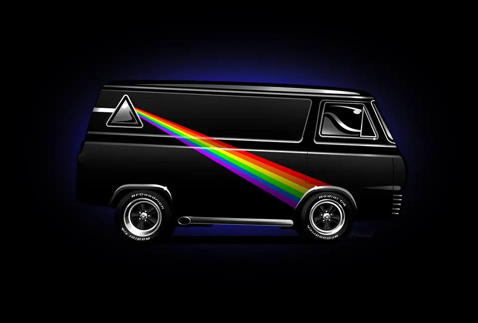

This is the artist's rendition of the design. There will be some body mods done that aren't shown, and the starting van has 2 doors on the passenger side. The rear doors will be welded and made into a clam shell single door. The side pipes I'll be fabricating and have chromed. The triangle portholes will have to be custom made. The multi-color prism rays are pure metal flake and the van body will be black metal flake. Wheels will be 17x9 Mustang GT wheels.
I used to have a body shop and teach autobody in the early 80's, so like the pickup, I'll do it all myself. BTW: It's a plum crazy base with pure purple flake over it.
