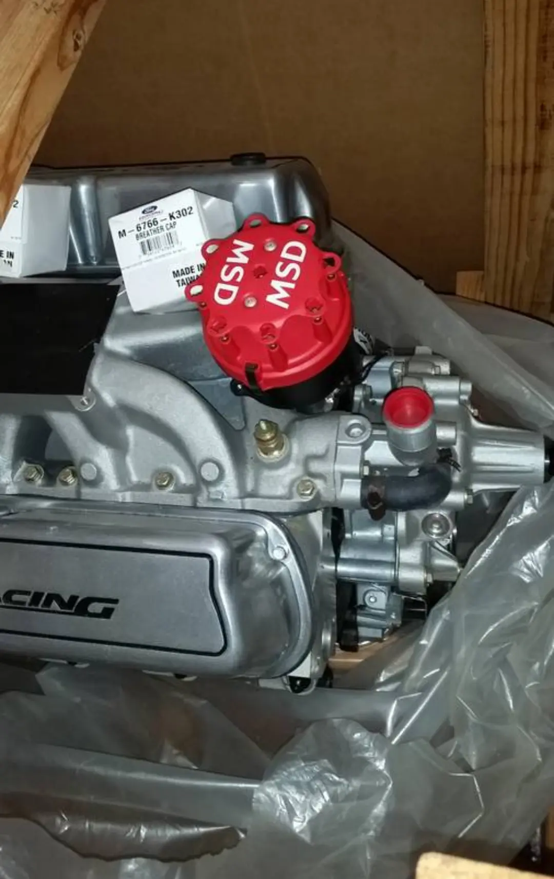

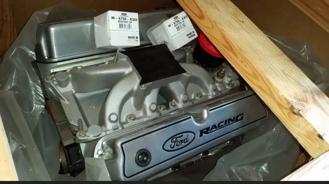

I have this crate engine that I bought for me 1962 Falcon Futura, but lost the car in Hurricane Harvey at the shop where the Mustang ll front suspension was getting installed. The engine has been here in my garage since I bought it. I bought it new in 2004, been in the crate the whole time. I never got another car and now we are moving out of the area. So I need to sell this amazing engine.
This is the M6007-C347, 450hp sportsman block engine. Complete with intake, factory stabbed MSD Distributor, plugs, oil pump, pan and filter, water pump. I'm even throwing in the Edelbrock Performer series 750cfm carb I bought for the engine and the March pulley set. Just add plug wires, headers, flexplate / flywheel, and go. I have over $8000 invested in these items. Engine has never been out of the bag or crate.
I'm in the Houston / Galveston area.
Because I'm moving out of the area and broke my heart when I lost the car, I just need to sell it to someone who wants this real - 460 HP engine.
