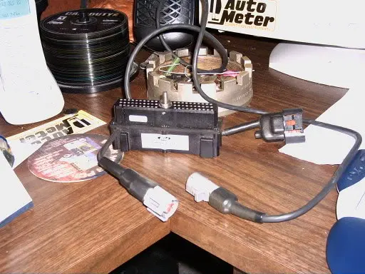

Here we go,
Figure #1 This is the wire harness I bought from supposed 89 T5 car, came with A9L ecu, ANYONE know what the green plug does or what it goes to?
Figure #2 Heres My current Speed density Computer and Harness, No green plug anywhere....
Figure #3 Wider shot angle of SD ecu and harness. there is a part of the SD harness that runs across the top of the firewall and exits down by the drivers door, Im assuming this goes to the transmission or something??
Unless I can figure out what the green plug is in Figure #1 I have to buy the dreaded $650 FMS MAss Air Conversion for an Automatic, then do my T5 swap. Good news is, I have some sort of T5 harness and A9L computer extra for someone..... :(
I thought that was what that tan wire was. I think I have a solution that will allow you to use your stock wireing harness.
The part number for the conversion harness they give you with the ford racing mass air kit is E8ZM-12A582-B32.
This harness is the one that just plugs in between the computer and stock wiring harness, then has the mass air meter wiring comming off it. You may be able to get this part from a ford racing dealer. Im trying to find one online right now.
