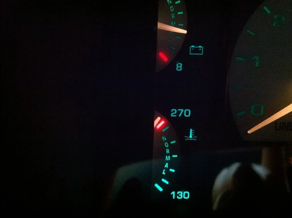

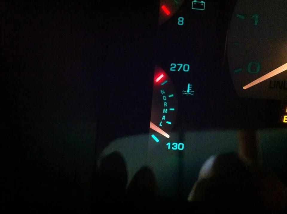

Just had a few minutes to play with it tonight and it looks like this may work out ok. I started with the Temp Sender and simulated the 74 ohm (Cold) and 10 ohm (Hot) reference values. Here's how the gauge reacted:
The Hot should land exactly on the red mark, and the Cold on the first mark. So, it looks like the needle is roughly one division too high. I'll adjust it down and see how consistent it is... Hope to have a chance to work on it more tomorrow.
These pics also show the resting position for the tach. Every picture I've dug up on Google of a Fox cluster shows the needle sitting on the 0. I'll just eyeball it and put it on the 0 and see how that works.
