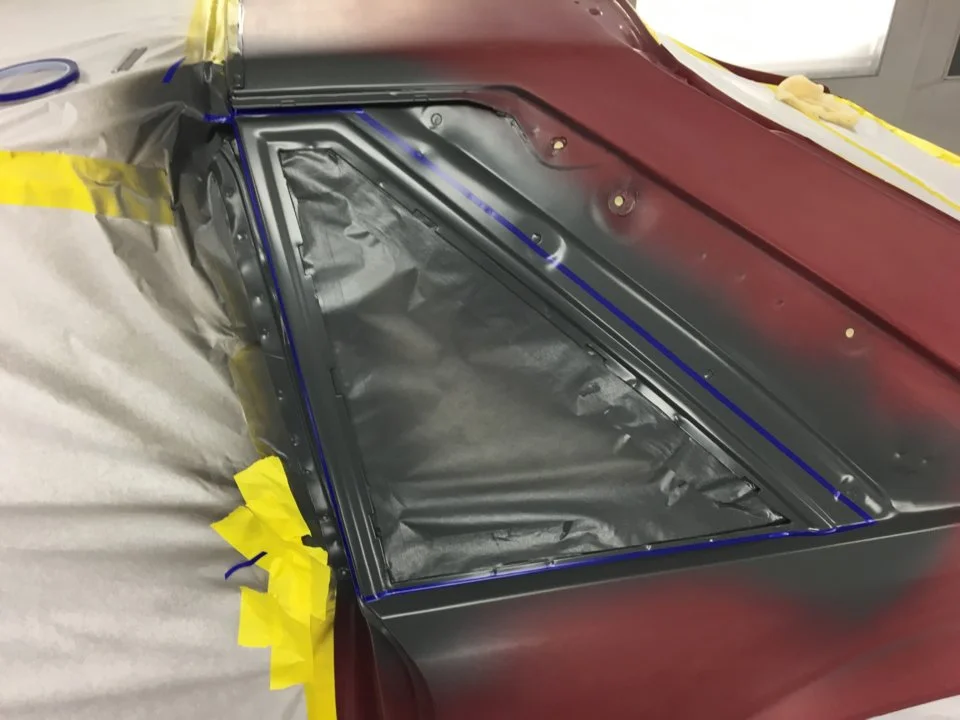

3M blue 1/4" fine line tape for leaving a sharp, clean edge:

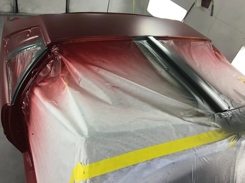

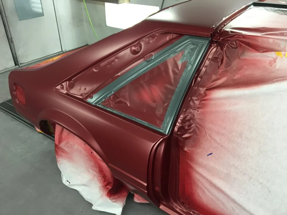

Ready for clear coating

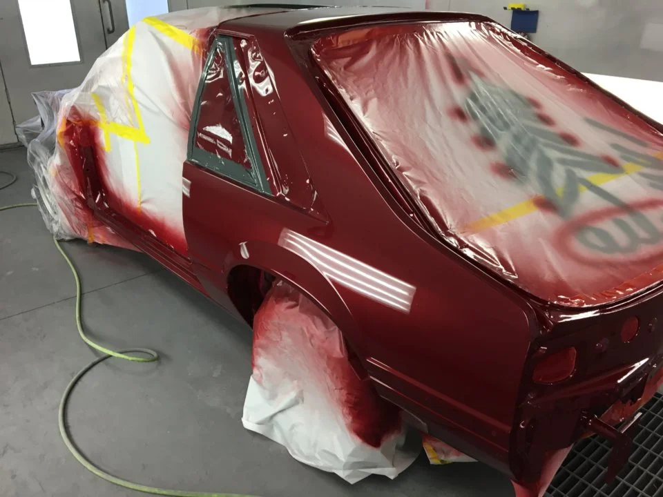

Tah dah!

Davedacarpainter said:
Tah dah!
That really is stunning, Dave. I absolutely love that color, it's gorgeous! Fantastic!
Now, If only I could paint well enough for hecker spies....

billison said:
Why tape it off like that if the interior is out? Wouldn't you want a little overspray towards the inside?
I would have had to spend an extra couple hours cleaning, plus the paint would peel on the interior unless I sanded it.
Mainly a cleanliness thing for the outer panels though.

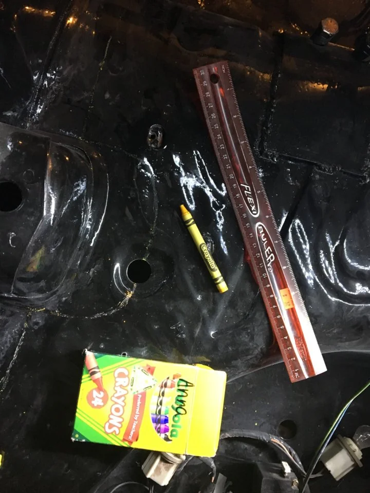

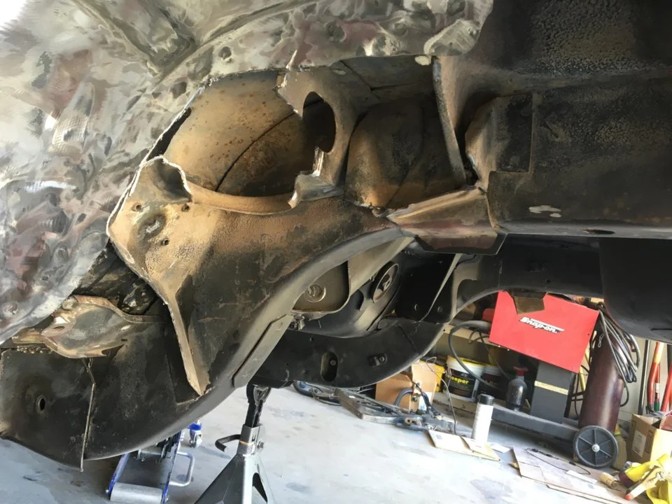

So, starting to mini-tub a fox body with a homemade kit. Let's use my car for an example.
Why do a homemade kit when you can buy a kit fairly cheap (under $150)? Couple reasons for me, one: The kits you get usually require you to use coilovers (ok, with me). But you have to move them to the inboard side of the frame. This also requires a bar to be welded in between the frame rails to attach the coilovers upper attachment, big deal, right? two: I want to keep my spare tire well though, it's got to go to fit that bar. I'll be driving my car to the east coast next spring for some of the big shows out there, my luck dictates a spare tire.
Plus, for handling, it's good to have the coilovers further outboard if you intend any sort of spirited curvy handling that is.
What do you need to do this, you might ask? Materials wise, not much for me since I could scrounge some really nice metal from a frame that was swapped out from a Tahoe. I bought one sheet of metal, 24"x12" that still needs to be cut into four 2.5" strips for the inner tub extension.
The metal I got for the frame will be used to box the frame to allow the coilovers to mount in the stock (albeit moved in 2") upper shock mount. I will be notching the frame in this latest procedure on my car.
So, sit back and watch as I go through this. Use what you want for your own mini-tubbing, ridicule me for what you don't use, You won't hurt my feelings.....much......
Two picture of what I've done so far, not very impressive, but necessary.
Drop the rear end out completely, you don't really have to I guess, but holy crap what a pain in the ass if you don't.
I used a yellow crayon and a ruler to mark where I'll cut the floor, see the picture.
And, I started cutting a little bit of the stuff in the way. I'll cover this in detail tomorrow night, I only did a little cutting tonight, just enough to put me in the point of no return phase.
Talk to you more tomorrow night.
BTW, I have given myself two weeks to do this, so it shouldn't bore everyone too much. I'll include lots of pictures for the picture whores among us:
First, my daughter's crayons to mark where I will cut the floor
Stuff to cut out
I cut into some of it to ensure I don't back out
One thing to modify that you will see in the lower left corner of the last picture, below the spring perch, is the seat belt mount. I want to use the rear seats for my grandkids and other miscreants. So, I'll cut out a couple inches of the mount , beat the hell out of the floor in that area to fit it's new location, and reweld it into it's new place.
