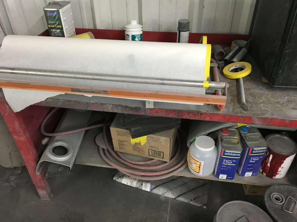

I want to first address @RaggedGT. He asked how my masking machine works. Through showing him this, you'll get an idea about masking. I will give a more detailed view about masking later.

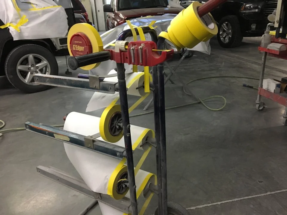

Ok raggedy, first: Here's my masking machine set up to use:
As I mentioned in my build thread, it is a 3M machine. There are other masking machines out there, through trial and error I like theirs the best.
As you can see now, the 3/4" tape attaches to the paper along the side of the paper. You can adjust the overlap on the paper by adjusting the set screws on the side. It's simple, you pull out the desired length of the desired size of paper (6", 12", 18") and the tape comes off it's roll adhering to the side of the paper.
The red plastic device attached to the top with EZ Edger on it simply folds the edge of the tape roll on it, as it's name implies, it is for masking the edges of panels you are preparing to paint. The folded edge can be adjusted for different widths depending on the reason for it's use.
Here's an example of each:
This is my 36" masking machine, it is also a 3M product. Their 36" machines are far superior to any other one that I have used over the years. I've had it for a couple decades now as well. It does what the mobile machine does, except for 36" paper.
It cost about the same as my mobile machine, roughly $350. I have no idea what they might cost now, could be more or less.:

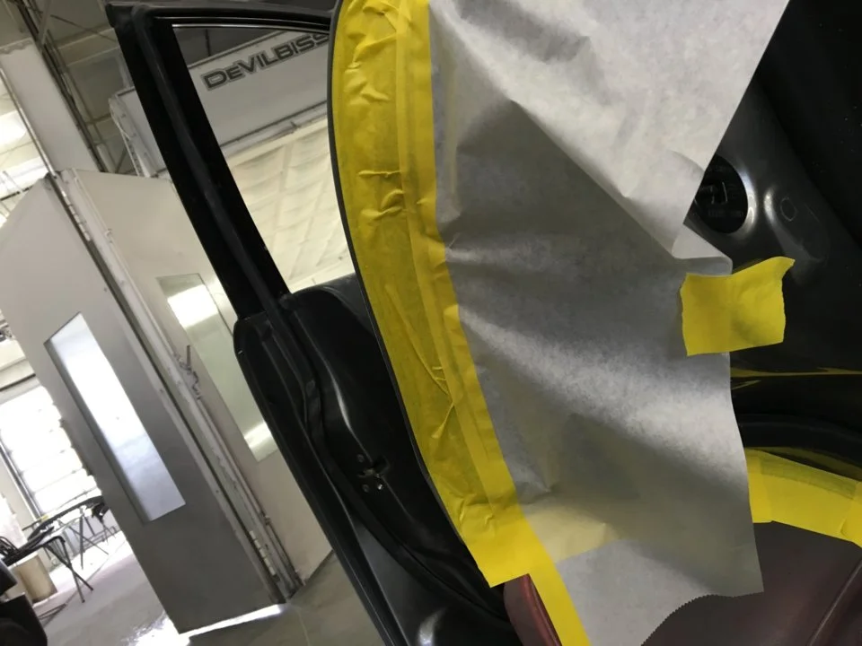

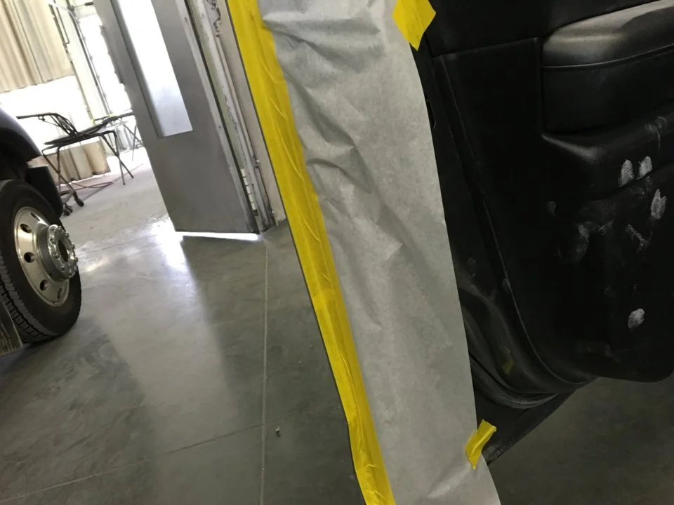

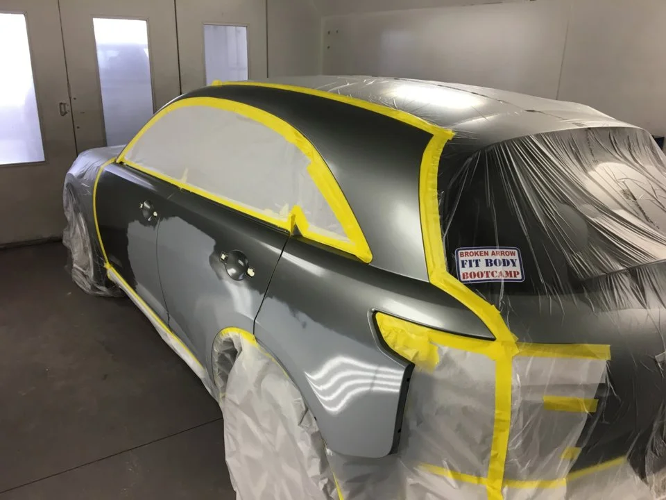

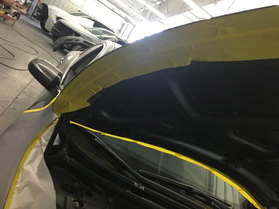

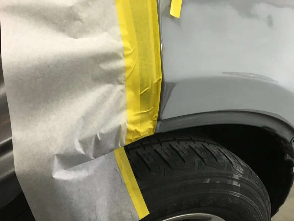

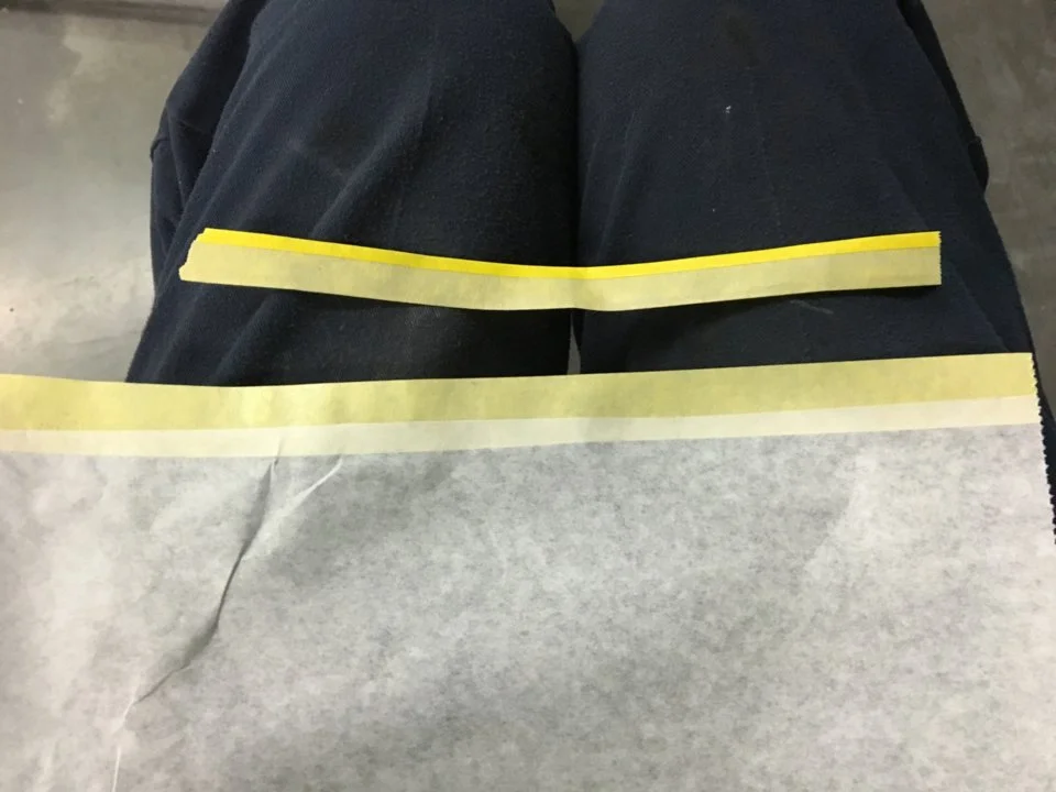

Just to show you the use of the different tapes and papers, I took a few pictures of my masking one of the cars I painted yesterday. It is an inifinit fx35 that was damaged down the left doors, 1/4, and rear bumper.
So, in this picture, I've masked the left 1/4 jamb using the folded tape, 2" tape, and 6" paper. The folded tape when used in this manner will give a soft paint edge in the jamb that isn't noticeable as it would be if you taped the jamb in a hard line fashion(meaning the tape edge wasn't folded and you will see exactly where the new paint stopped by the line left behind).
The folded tape allows a very small amount of overspray by it's edge preventing a hard line when used in this manner.
The next couple of pictures of the vehicle show other areas I masked with the final one having it completely masked (at that stage of the process I have already shot a clear base on the panels, that's why it has a slight sheen to it):
So raggedy, there you go. That's how it works and what I use it for. Hope this helped.

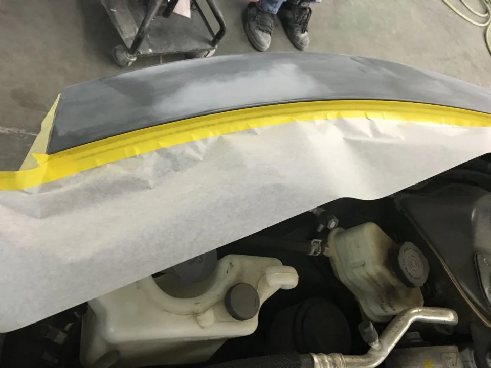

Just a picture of masking fenders for underneath the hood. Nissan Maxima, front end and left side repair. This is the right fender, I duplicated the masking on the left side as well. Underneath the hood I use two strips of two inch tape. I used the folded tape for the edge and six inch paper.
