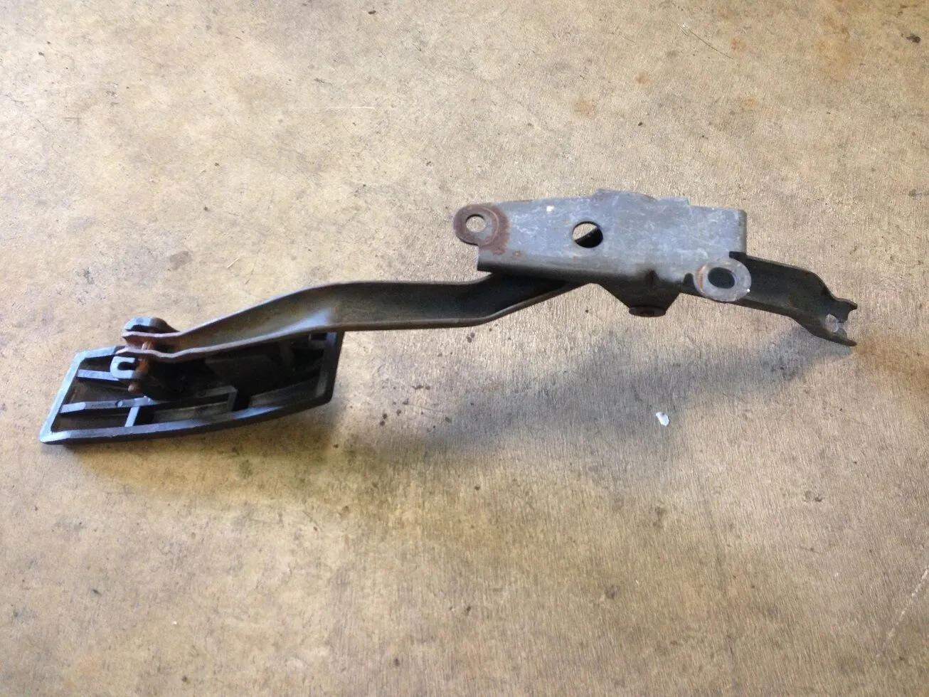

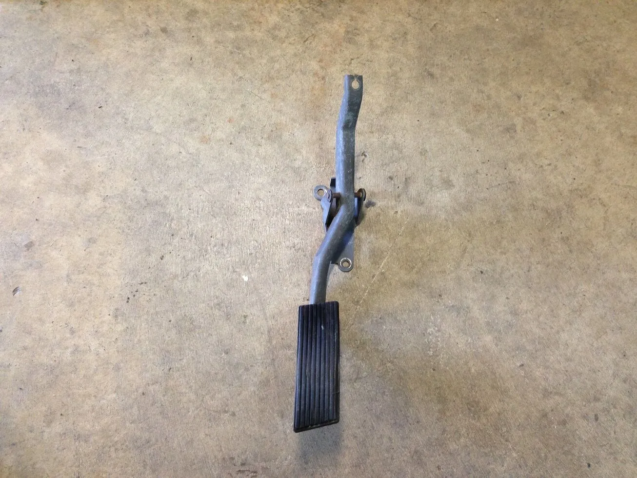

Not to be a pest, but this info became more pertinent this weekend...
2 pics of 87-93 fox pedal
bolting go pedal to firewall should be the easy part, Universal is always another option,

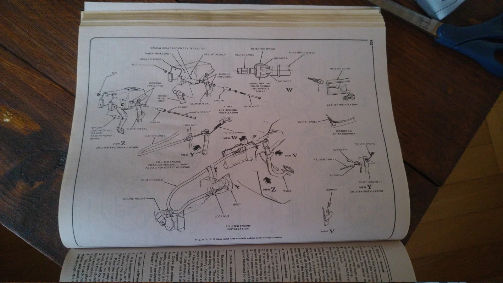

Hey,
the clutch pedal is the same, but there a diffrent holes in the pedal support. In my haynes repair manual there is a foto where to put it depending on the engine.
I put it through the brake pedal, if i remember right.

There may be a difference in clutch pedals! Going from that picture the mounting point would move up a bit for the V6. In order to keep the pedals in the same location from car to car, the mounting hole would have to be relocated and re-drilled in the lever. And since the pedal has a "sleeve" that the mounting/pivot bolt runs through it wouldn't be as easy as just punching another hole in the same lever. I'm sure they did that to make it easier to press for a stiffer clutch. Too bad they don't show where the V8 pedal location is if it's any different from the V6.
