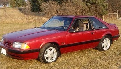

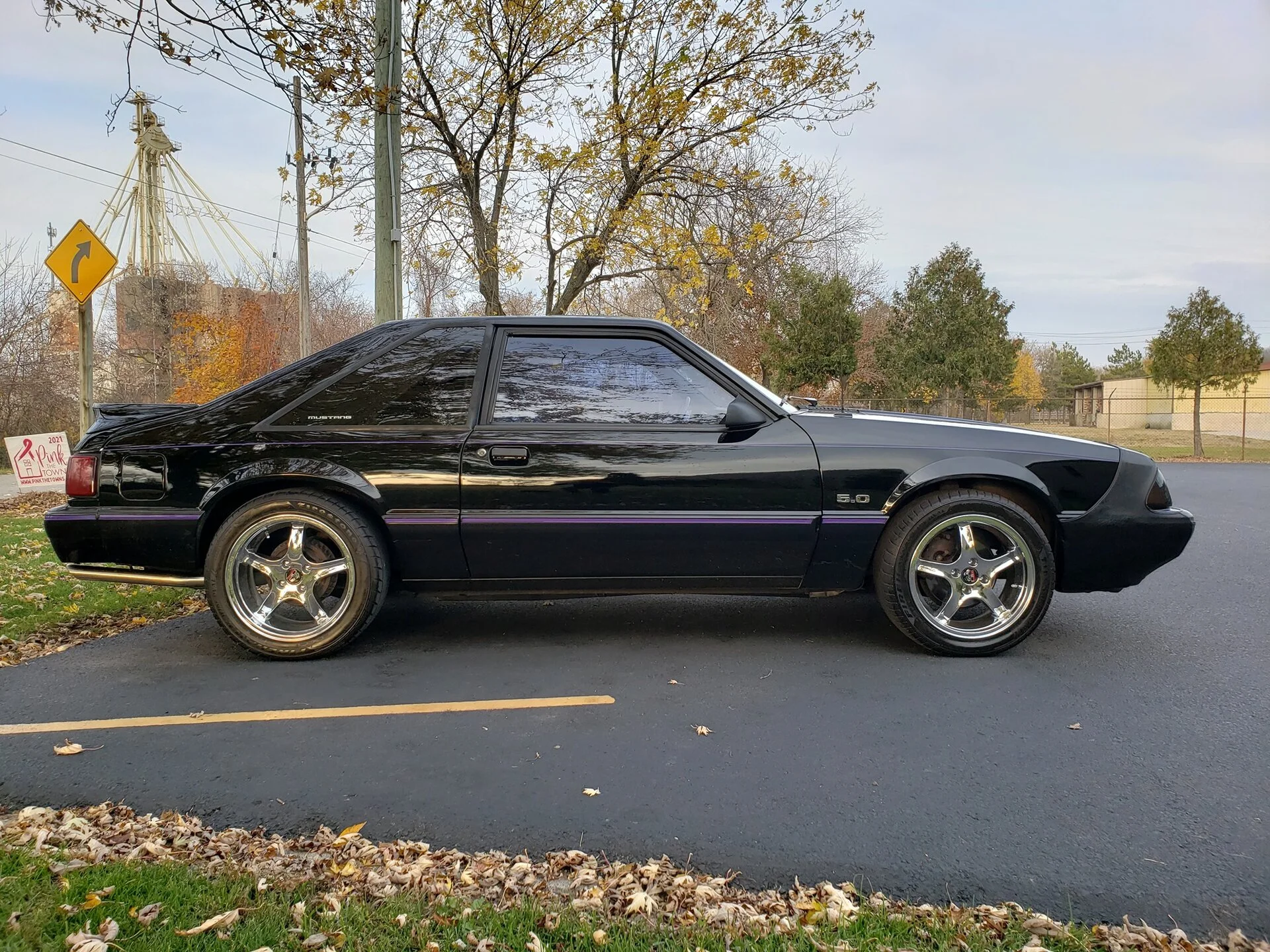

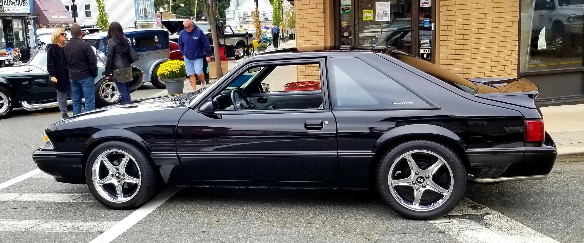

I have a 1987 LX 5.0 Hatch that has the original suspension components with Maximum Motorsports full length subframe connectors added. I'd like to replace the factory shocks/struts and consider swapping out factory springs for lowering springs but really I'm not interested in the slammed look, so lowering an inch would be fine. My overall goal would be to improve on the factory set up with decent quality parts. Considering the KYB GR2 shocks/struts. Any recommendations? I included pic taken recently to show current ride height.

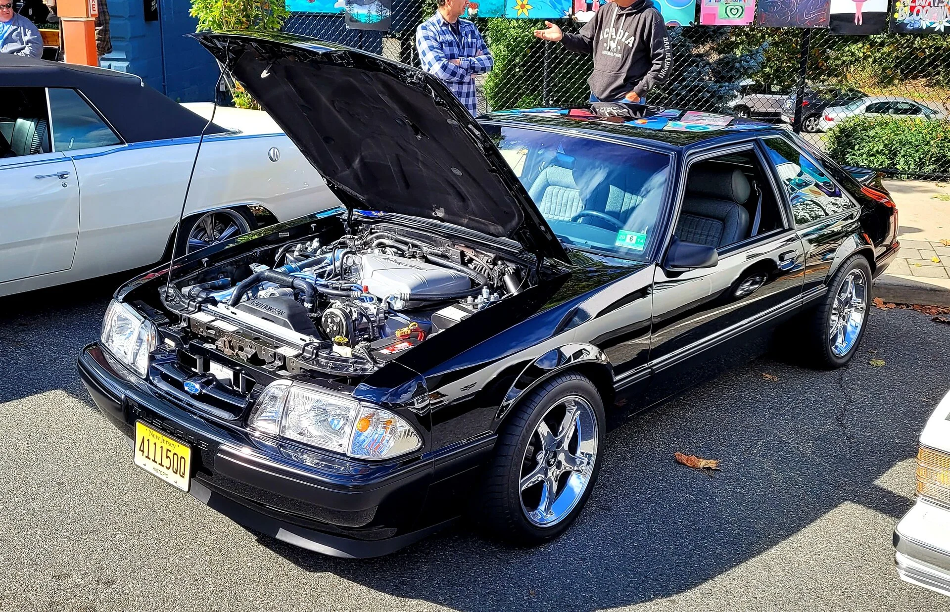

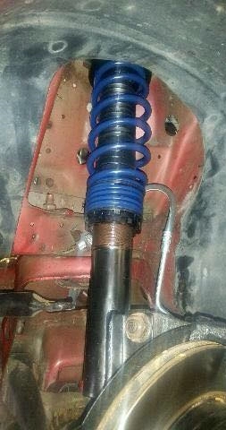

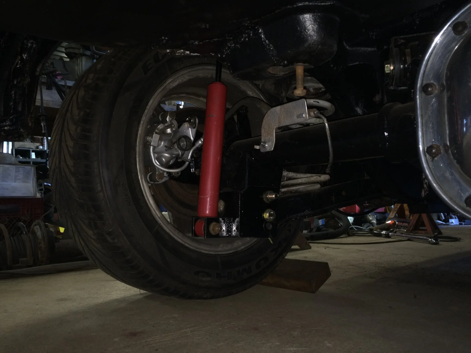

Stock rear spring with lower control arm mount lowered about 2". Front is an old school Granatelli coil over kit. I have actually moved to the lower hole in the second pic.

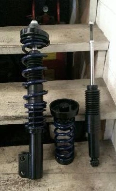

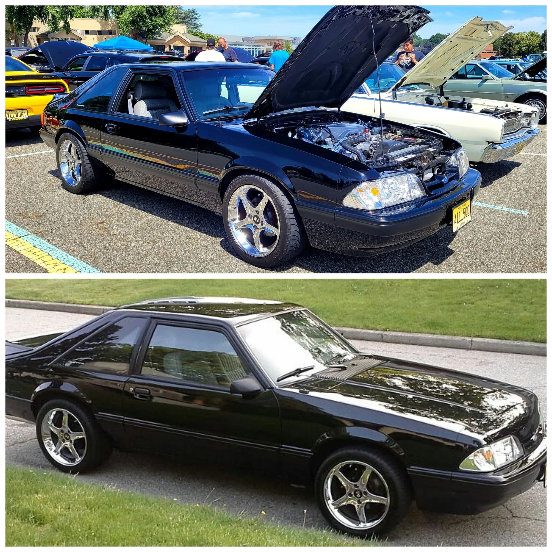

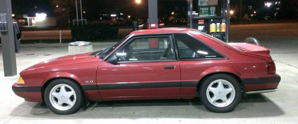

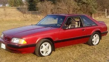

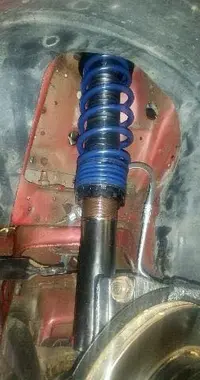

If you want the best of both worlds, rather than going with lowering springs and new shocks/struts, I would recommend going with a set of coil-overs. I did an install on a 1990 LX, and it was simple. Plus, you can raise/lower the height in order to fine tune the exact stance you are looking for. Here is a photo of before, the coil-overs, and an after.
From your experience, would you have a preferred brand name for coil overs that is good quality and priced reasonably?
We went with a complete kit from American Muscle. If memory serves me correct, it was not a large name brand. I believe the kit was roughly about $800, compared with the big-name brands going for $1500+. They have been on the car now for over 5 years and not a single problem.

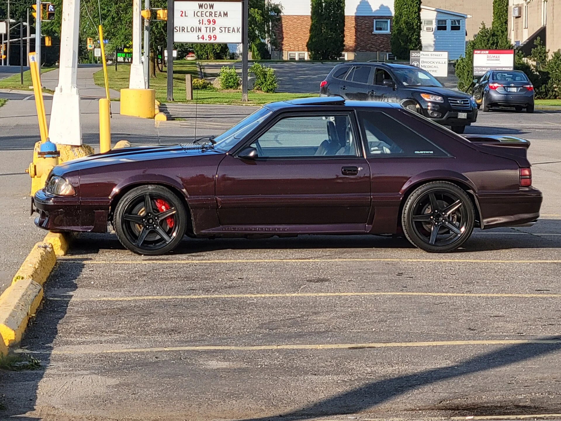

I also have those same size tires, every once and in a while over a big bump on a highway something rubs slightly, but I haven't tried to figure out what it is yet, no obvious marks so far...haha

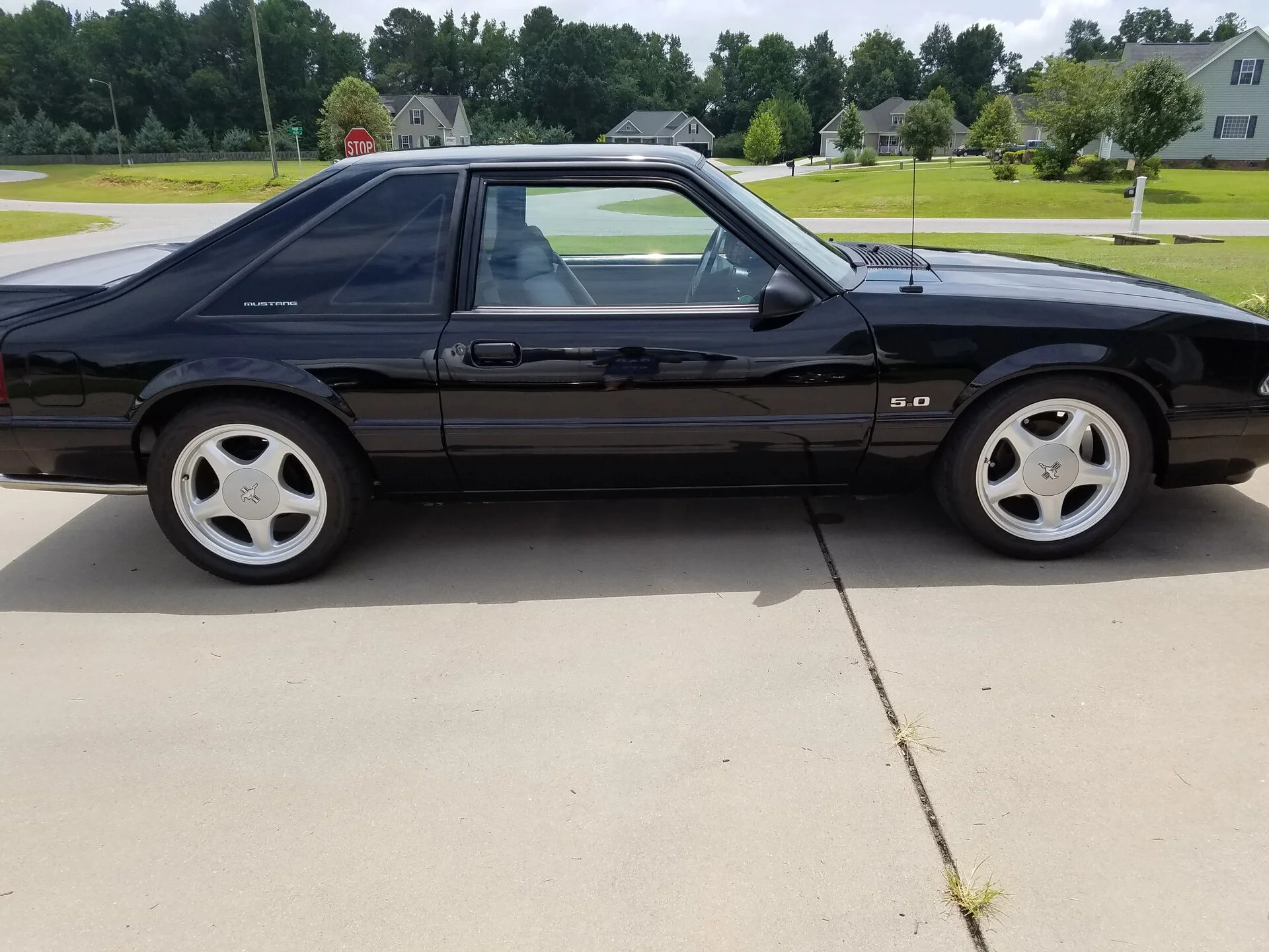

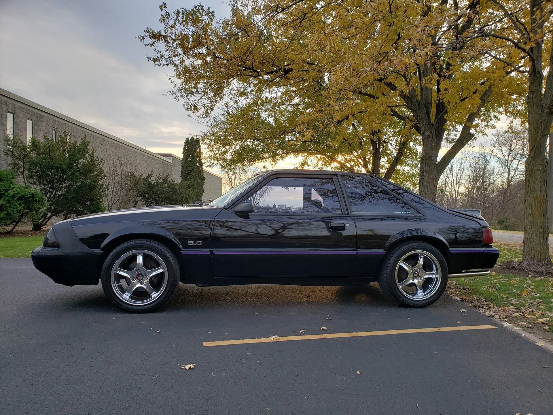

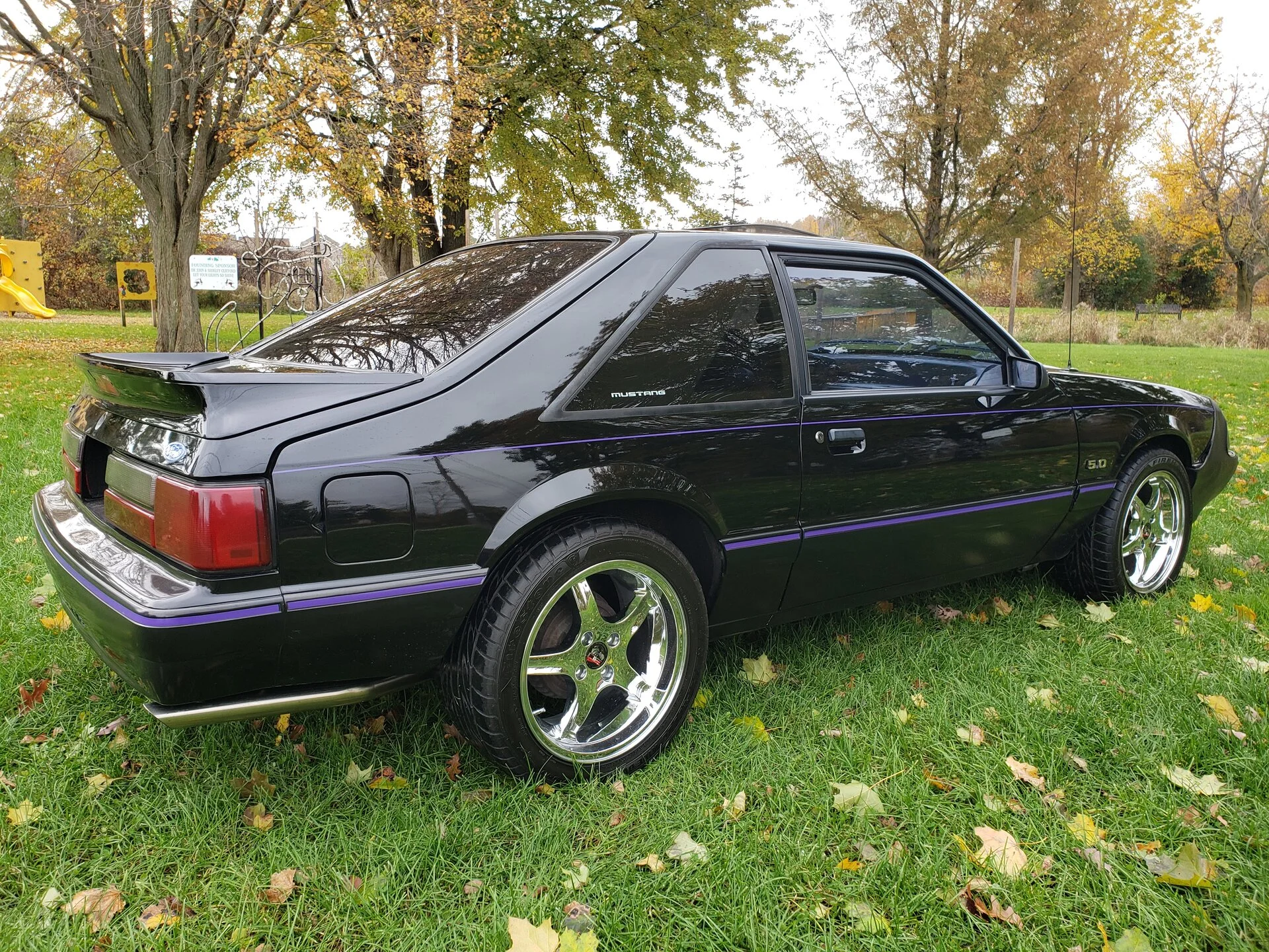

Here's mine setting on Steeda Sport springs. I have the Koni SRT.T shocks and struts, but I've heard the KYB GR2s are decent for the money. I also have MM adjustable lower control arms so I can raise or lower the rear of the car from where it sets in this picture.
