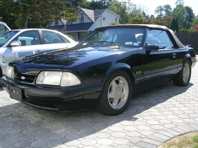

pic of the potential patient
The IRS will bolt right in. You will also need the Cobra exhaust if you don't have that. The IRS will improve the handeling and ride quality of drop top, but add about 100lbs at the same time. If you ever plan on drag racing the 99 IRS is pretty week and can produce wheel hop thet will destroy parts. Other wise I think they are great, much better road mannors.
If i could build one with a bulletproof build that i didn't have to worry about destroying, and if i could get rid of the wheel hop thing, i'd be all over it. The thing is though, there's enough aftermarket stuff for the 8.8 suspension that it can be built to outhandle the IRS with ease.
I'm trying to put an IRS out of an 89 Super Coupe in a fox. I don't think that it is anything similar to the Cobra IRS... Maybe someone can chime in. IIRC it bolts up different. Dunno.
