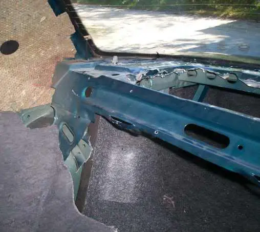

Ok, well I guess first I will show you the reason I wanted to install a bulkhead in my coupe and its not one of the normal ones.
FIRST AND FOREMOST I WANT TO MAKE IT CLEAR! I DID NOT BUTCHER THIS CAR

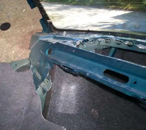

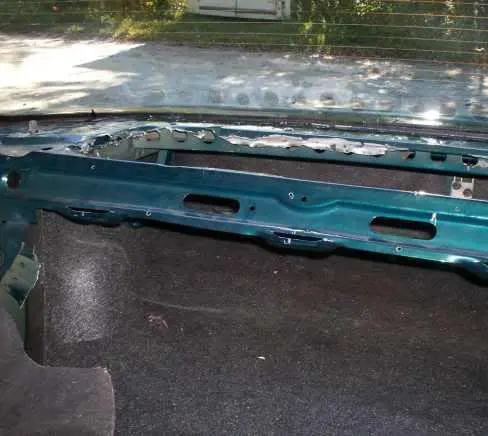

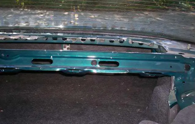

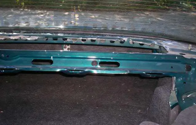

One of the previous owners did. For some unknown reason (most likely a large drug and/or alcohol habit) he decided to cut out the center of the package tray and removed the seats back brace. I didn't know this at the time of purchase. It was behind the seat delete that hid it quite well. I only found out after owning the car for about a month when I went to pull the delete inorder to put a nicer carpet on it. Having never been in a coupe I didn't realise that there was a Y brace behind the seat so when I didn't see it looking in the trunk it didn't trigger any red flags.
I cried. Honestly, tears came to my eyes. The rest of the car is in good shape and lets just say that I paid a fair price for a clean car. I felt like an idiot. I dunno if the guy who sold it to me did this, but I know he didn't pass it on. I know, I know. Buyer beware. But that doesn't mean I can't think he's an ass.
Anyway here is car w/ the rear interior pulled. You can see how bad of a job this ass did.
