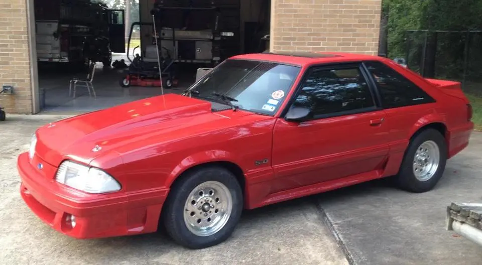

I've looked at quite a few threads and found that everyone is running 15x6 with 3.5" backspacing on Fox Mustangs on the front. One reason is because that was all that was available in 4-lug.
I'm going to be buying 5-lug because of my 95 spindles. In 5-lug Draglites they offer 2.5", 3.5", or 4.5" backspacing. Is 3.5" still the one I need to buy?
Also trying to decide on a tire size. Daily driver car with no track time. Thats why I'm getting rid of the 4-lug 15x3.5 draglites I have on there.
Any info and/or pictures would be great!

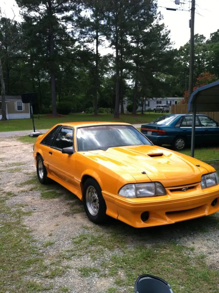

I understand that what i meant was if the backspacing on the 4 lug works why take the chance with anything else. And by works better how could it work anybetter.. I have the 4 lug they dont stick out, rub, or scrub.. So i would say its perfect
Billy,
It just clicked in my head, but I've got something similar on my car, I could measure when I get home tonight. Do you still have (or ever get) my number so you can call me and remind me?
