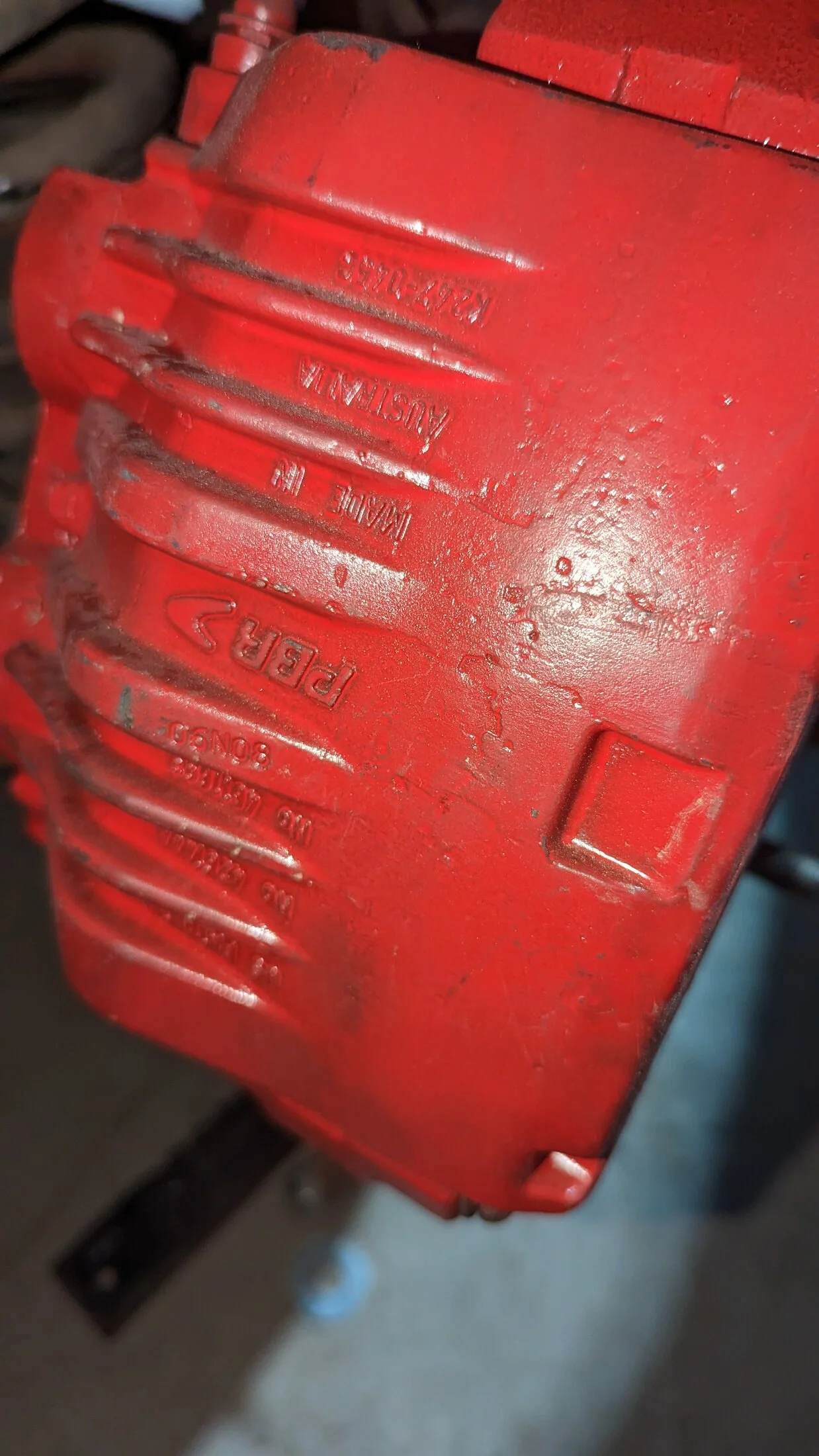

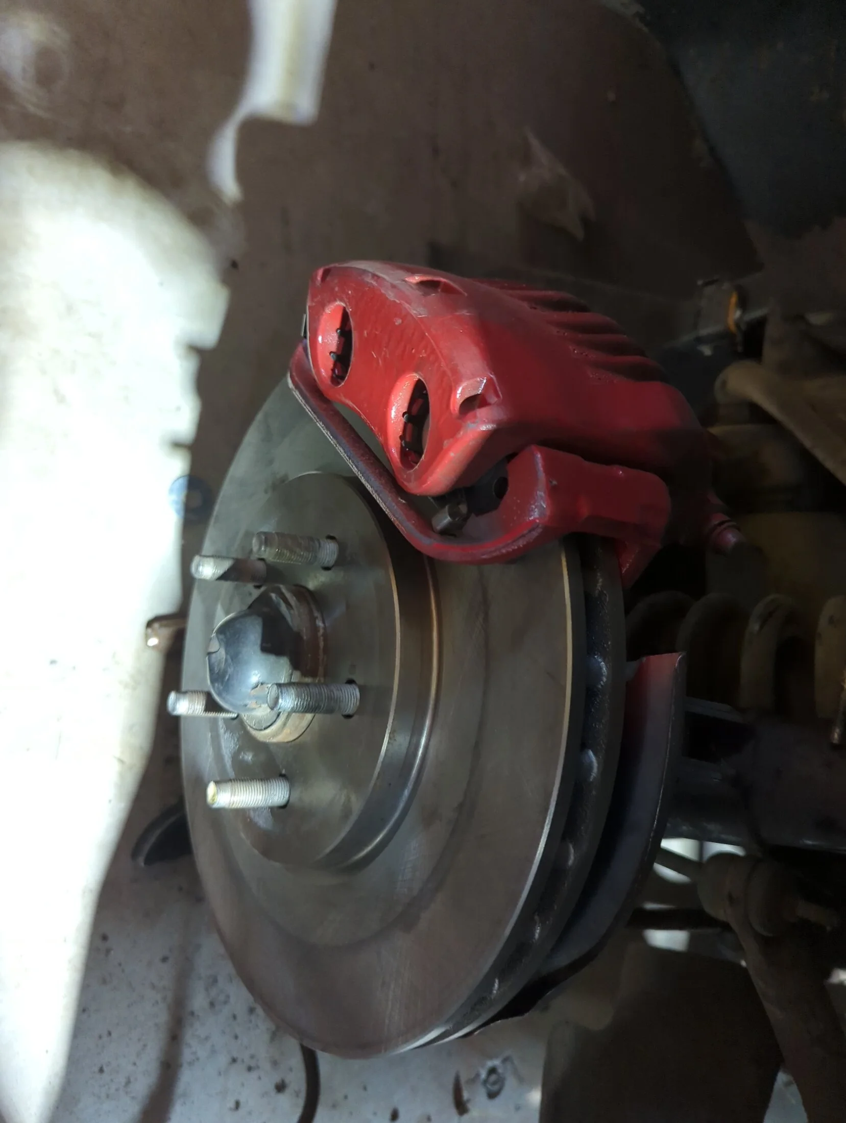

What am I looking at? This is my son's fox. It's getting a 5 lug swap at a buddies shop. We believe this is 03-04 Cobra setup. I had a little trouble trying to measure the rotor on the car but I think it's 13 inches. I thought all the Cobra calipers said Cobra? Anyway my main question is what's the best way (or pretty good just order it kit way) and what's the OEM parts swap master way to connect to the factory hard line. The OEM rubber line we have seems kinda short. We have an auto parts store piece of hard line and fitting that fit the body side of the soft line. Ideally I want to be able to swing by the junk yard tomorrow and grab everyones favorite soft lines. Then hit Napa grab a couple fittings and be driving it home tomorrow night. Using whatever is currently installed if not Cobra stuff replace later.

Those are 13” cobra stuff. That looks like an 03/04 Mach 1 caliper, which won’t say cobra. Often, a lot of parts store calipers also don’t say cobra.
For junkyard hoses, 99-04 Mustang lines are all the same so if you can spot a 99-04 v6 the hoses will work. You will need the 7828 adapter on pass side.
