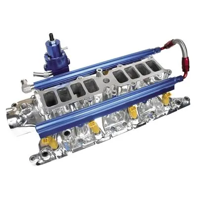

Sadly, I only get the rails and the fuel pressure regulator.

Did you use a thread sealant? I made sure I put sealent on all the threads. I'm concerned about the angle of the nipples that connect to the original fuel lines. Did yours work out alright??
Well, with every custom project comes custom fabrication. Apparently PP needs to specify that these rails don't work with Kenne Bell Superchargers. The new location of the FPR was in the way of my bypass tube on my supercharger. So i had to do some grinding on the FPR. I was sooo nervous doing this. But hopefully nothing will crack under pressure.
Well I think I have a solution to my fuel line problem. Should arrive from Summit on Wed :D

Got all the fittings to make the PP fuel rails work with everything. Took forever. I also had to modify the distributor just so i could put it in with these stupid fuel rails. Remind me to never buy a PP product again.
