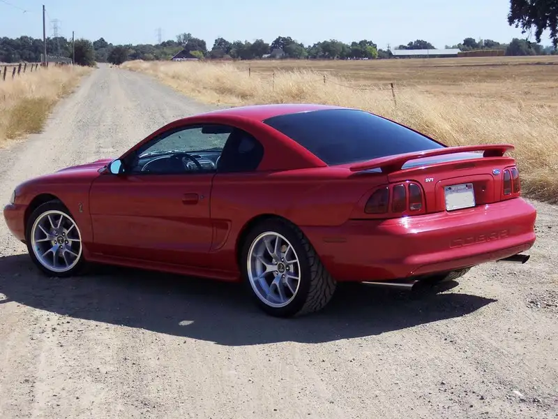

Not mine but it does show the wheels.
http://www.svtperformance.com/forums/showthread.php?t=465685&highlight=mystic+rims

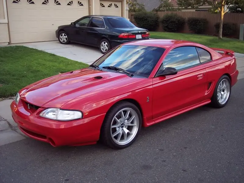

My old car

you could go 17X9 deep dish in the front or 18X10 but I wouldnt go deeper than that. run into clearance issues. in fact the car above looks to be 17X9 deep dish in the rear. you could use them up front

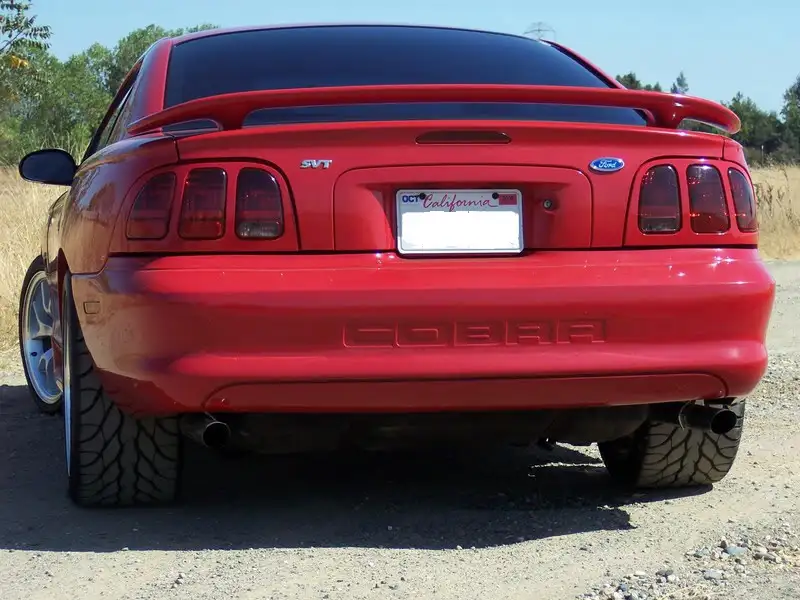

I would just run the 17X9 or 18X9 in front?? 10' wheels in the front would definitely rub & would probably make the car handle like crap. The only isue in the rear is the quad shock, which can be emoved if u have aftermarket LCA's or some people flip them around so the dust boot doesnt rub....
Pics of my old Cobra...
