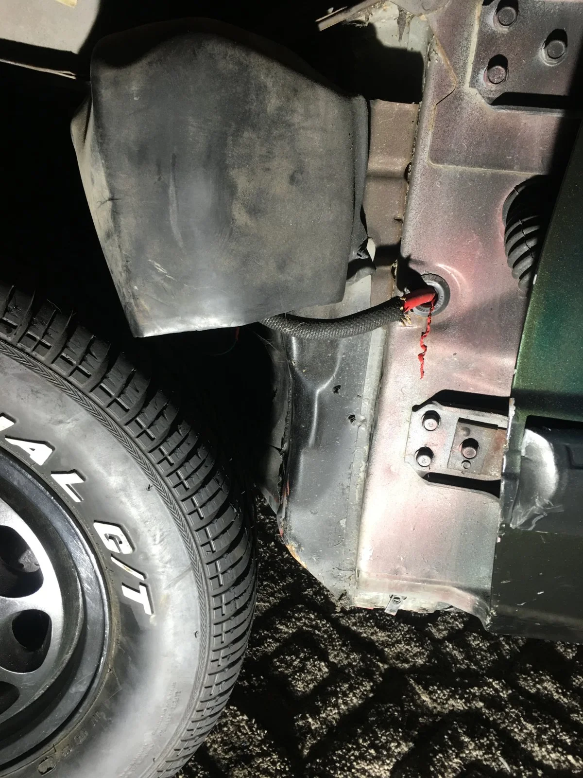

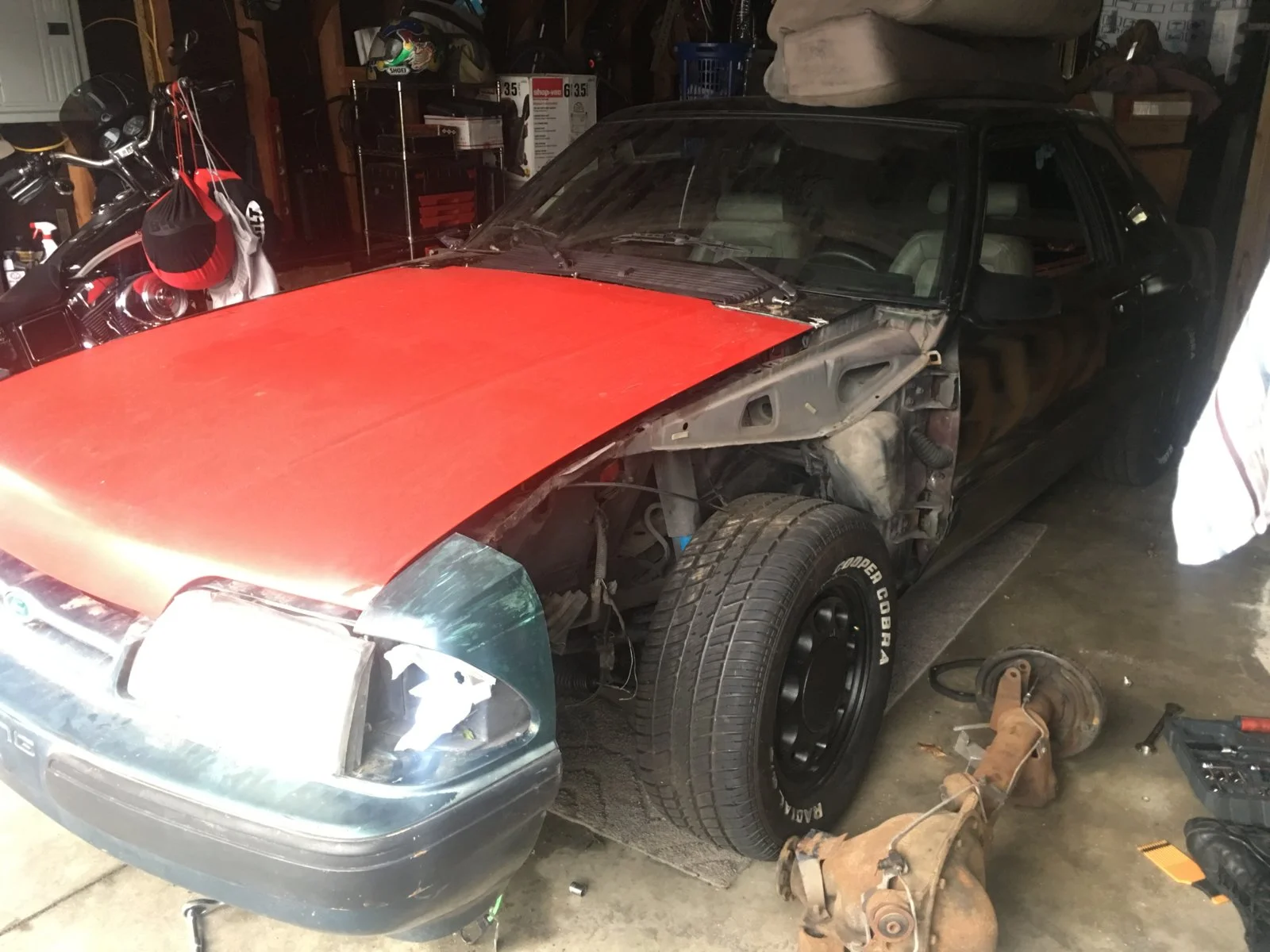

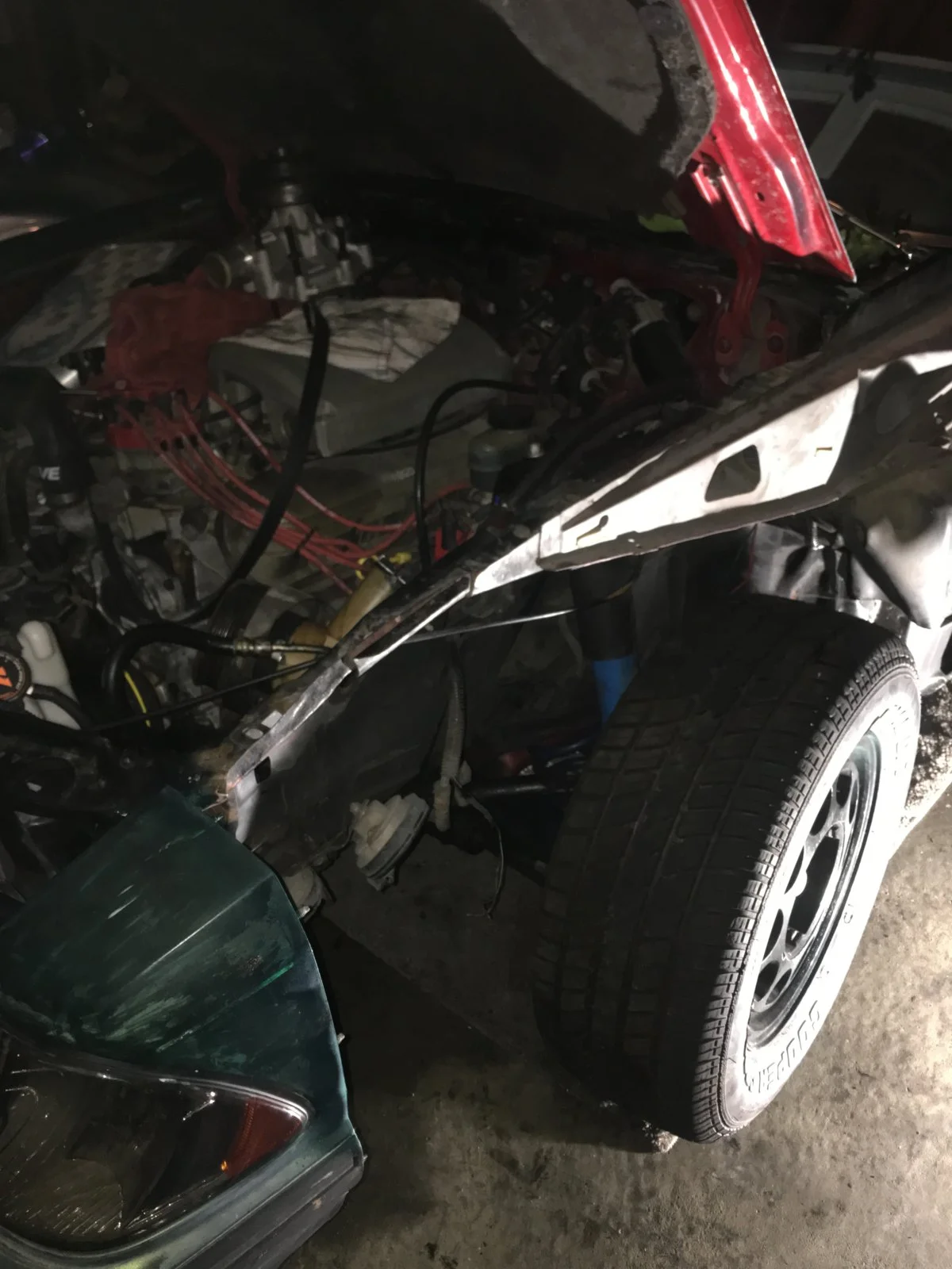

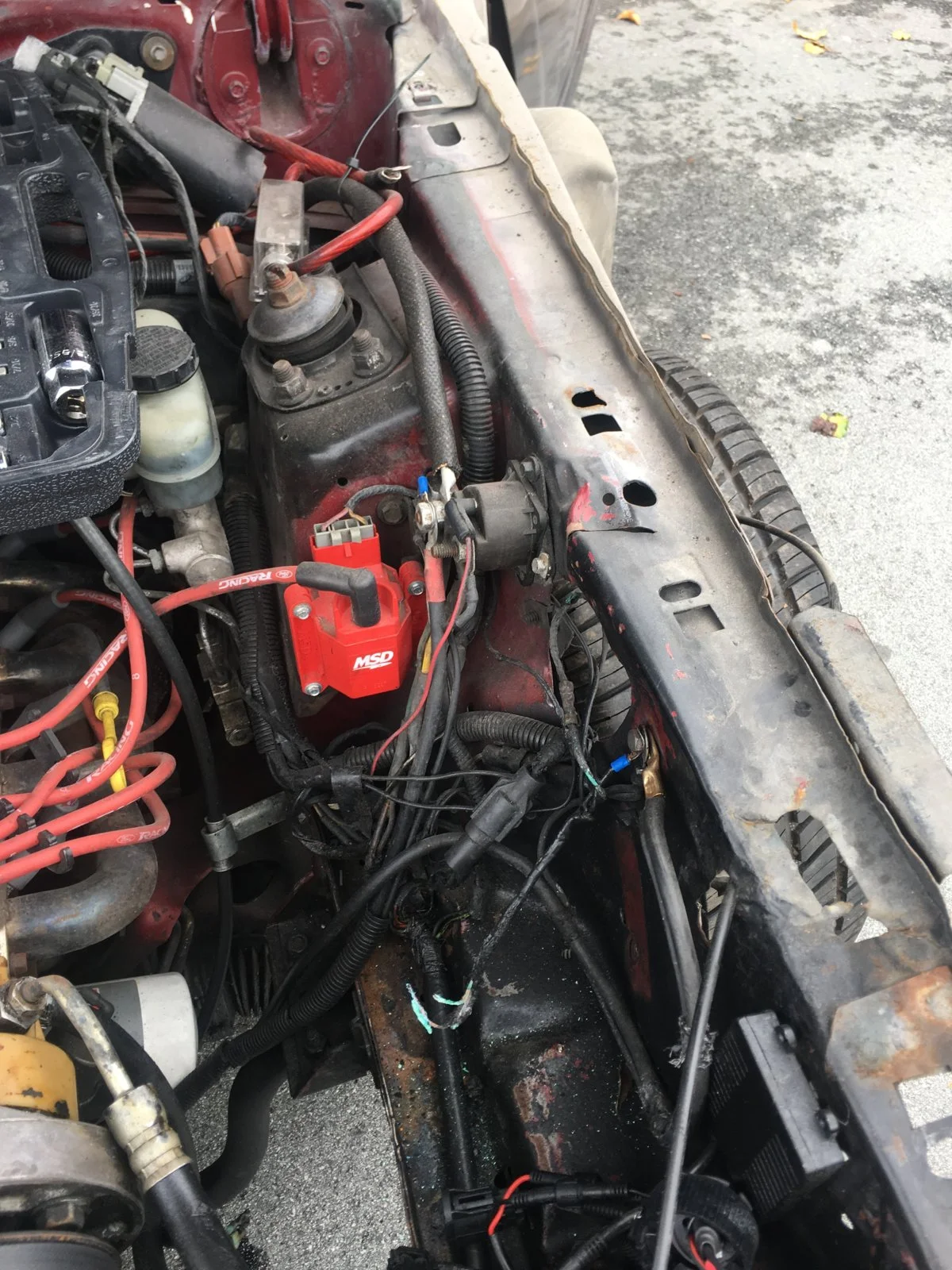

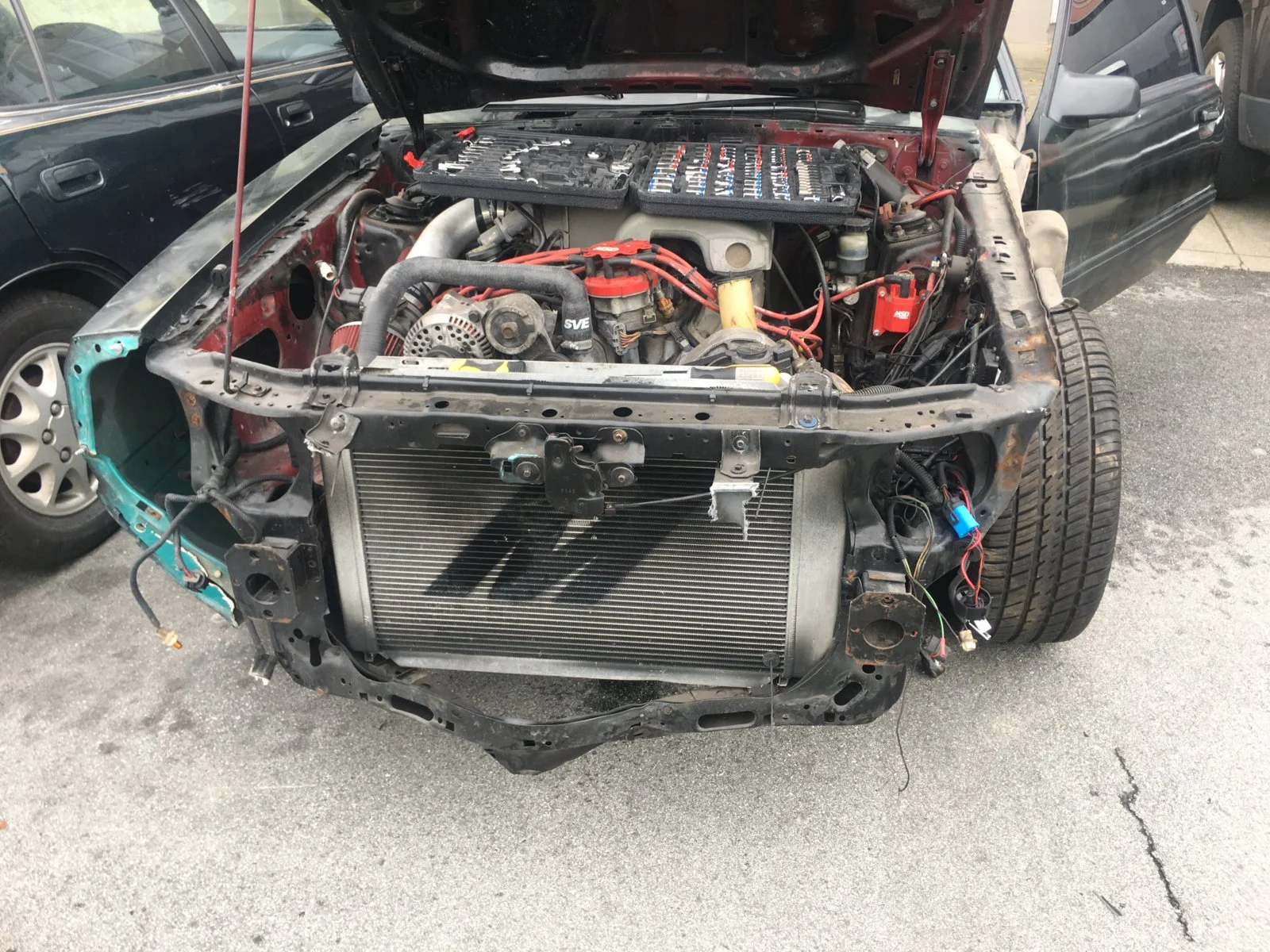

I have a 1992 mustang lx 5.0 and for some reason my driver tire is rubbing the fender net the door. Car was in a wreck on driver side at fender. Changed LCA stillhitting fender.

Judging by the condition of that core support I would say the front end of your car is tweaked significantly. It probably needs to go on a frame table and be measured. I would also check out the K member as it's possible it's bent too.
