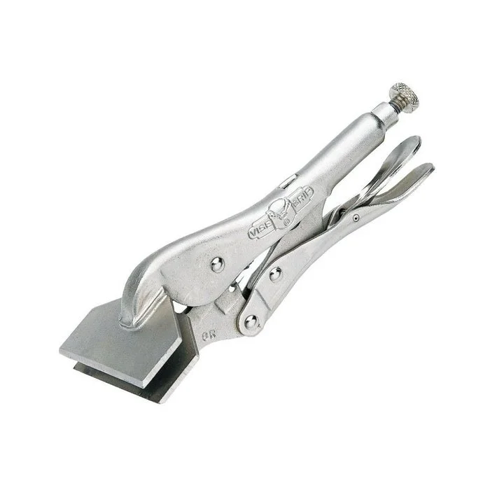

they make a duckbill vise grip that work great for straightening pinchwelds
