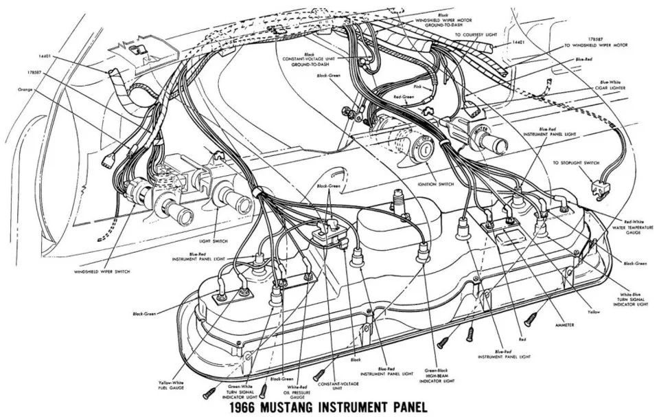

Has anyone ran across a black wire with a yellow female connector on it? I have one just hanging around under the dash. I've looked at the diagrams, but can't tell where it's coming from/going to.
WHere does it disappear into the harness in this diagram?
I think the ammeter had a red & yellow connector on the inst cluster. Is the connector a molded 90 degree plug?
May be black-green stripe? it is going to ignition switch. Other than that only heater fan uses thick wires but not black-yellow (if it is supposed to be in the cab). I also have a bunch of black-blue wires under dash waiting for their turn
It's for the radio. It might not be dangling if I had a radio installed already. Sorry I didn't mention that, still new here. Thank you guys for your trouble.
