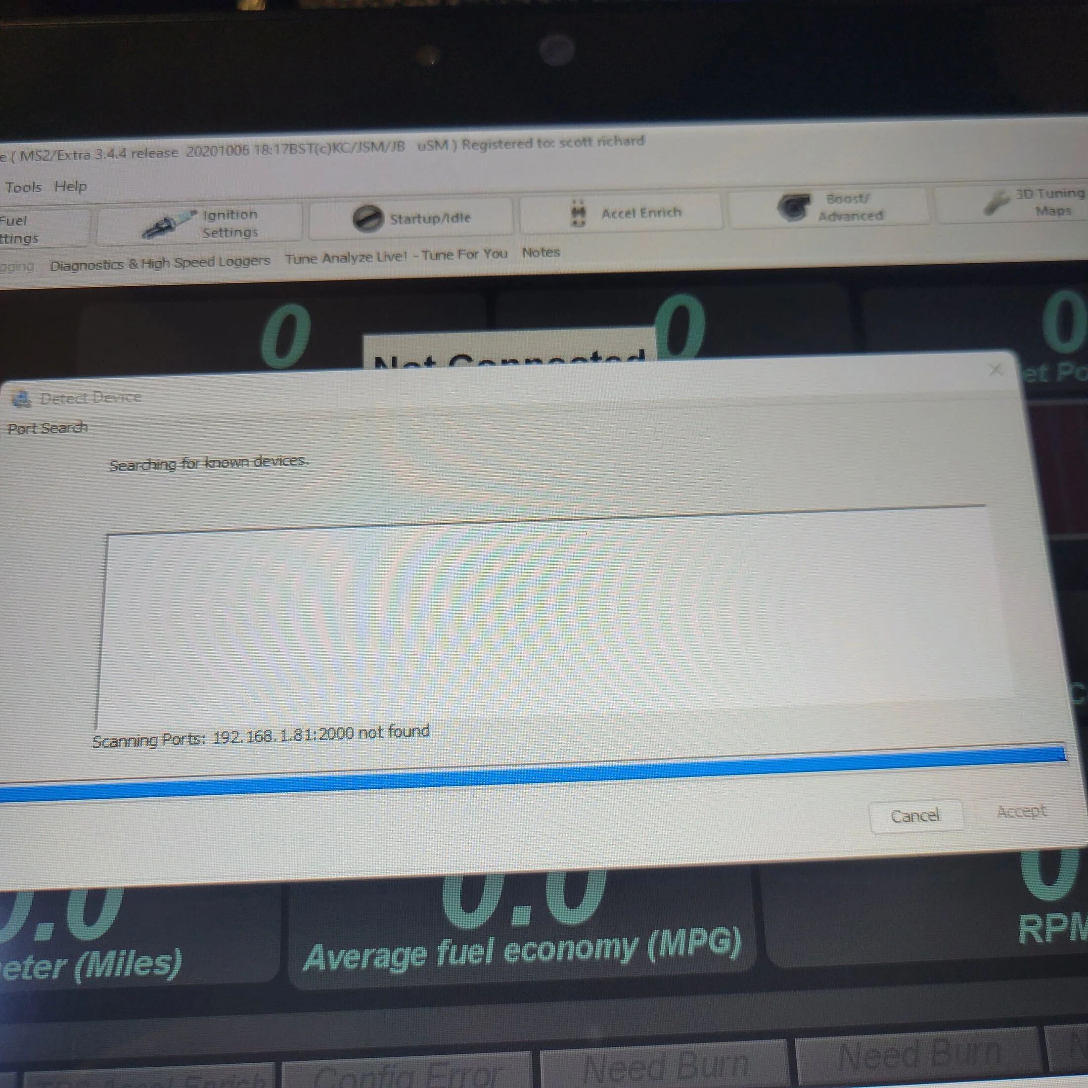

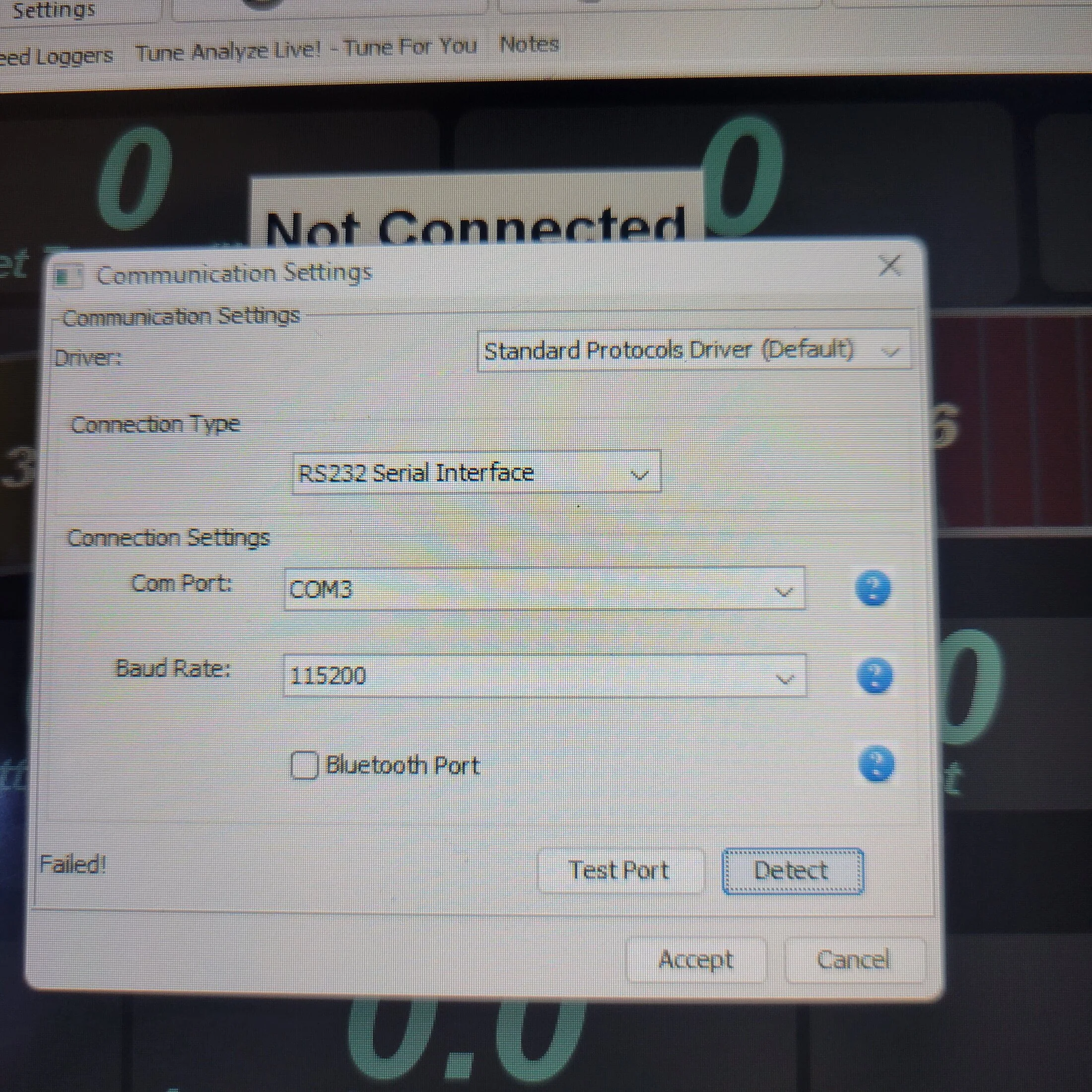

The computer is reading that the port is connected but TS is NOT reading anythjng. It just shows not connected and nothing detected. But again, the computer shows it is plugged in. If I can just get them to freaking pair and that is the I can't figure it out part. I had to have messed up firmware or some connection previous to the attempt that sent things amiss. But I can't seem to get it to detect anything. I tried the communication tabs and nothing. Debug gives me data but I am not smart enough for that mess.

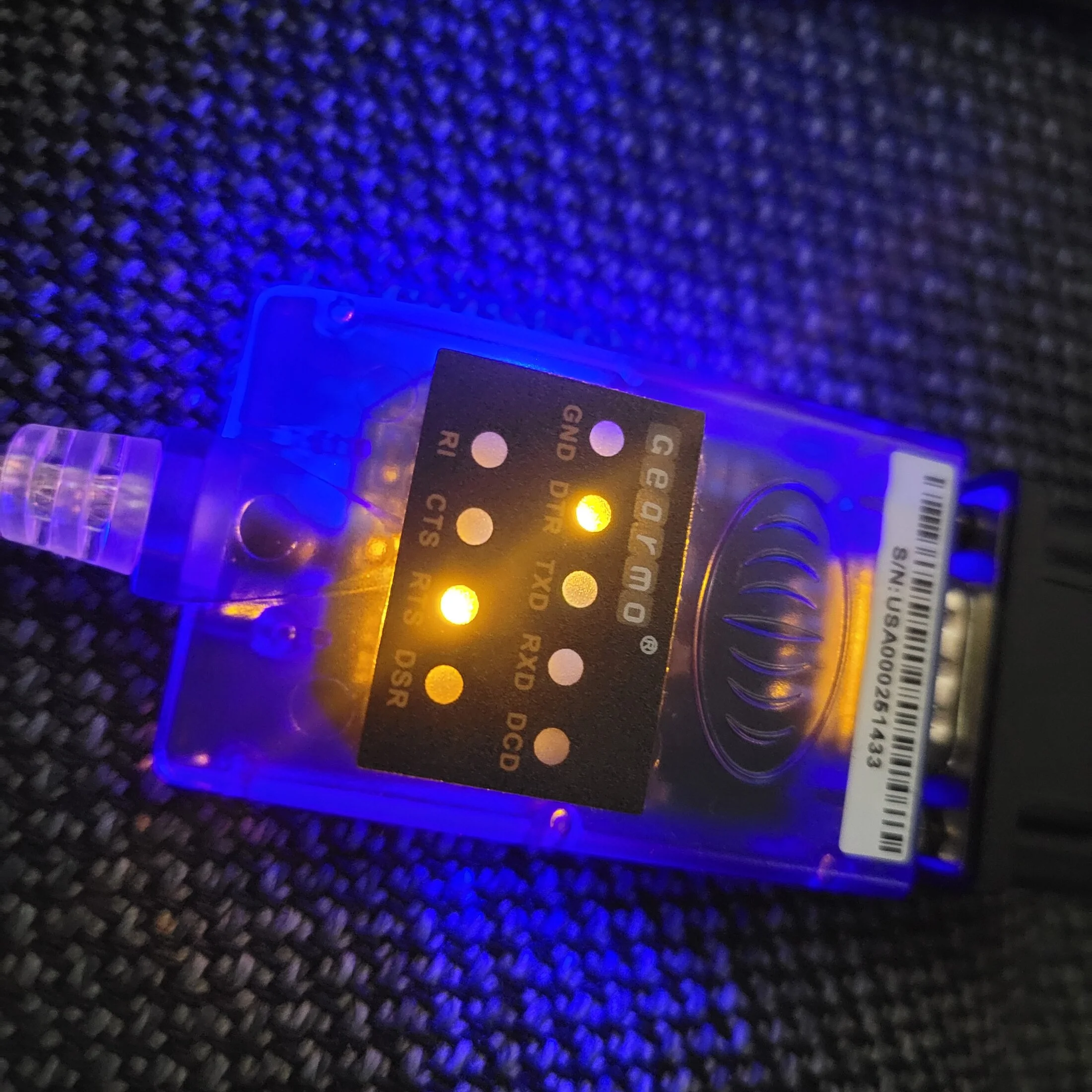

New Microsoft Fusion 5 windows device, new adapter, checked coms, ports and rates and set them all to align. Still ZERO connection from TS to MS. Port is there, com had checked as up to date and correct. The tune I need is sitting in TS ready tooadbut just can't connect.
Seems there is power to the ecu. I mean the car is powered. Maybe the "new" USB/RS232 was bad from the box. Otherwise I can't think of anything else or reason by it wouldn't connect other than maybe the ECU crapped out. Which I guess could be a thing.
Thoughts?

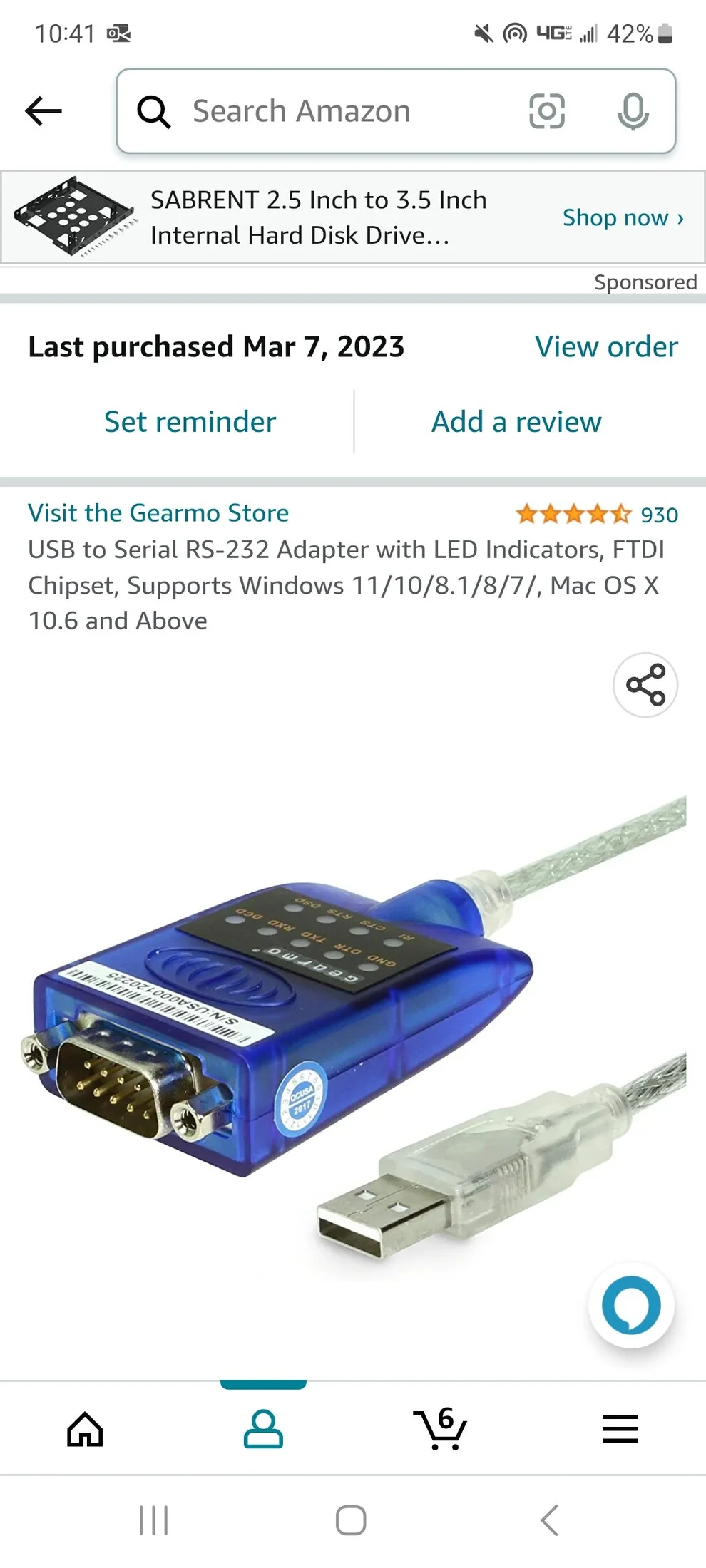

I have this one now and it says it is hooked and powered out by the laptop. But no port connection is being made. Still won't make a connection with the ECU to TS to load a tune. Wtf

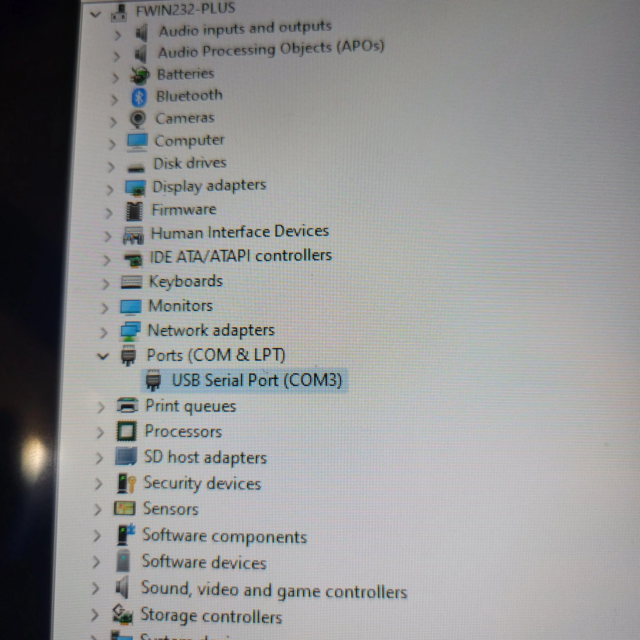

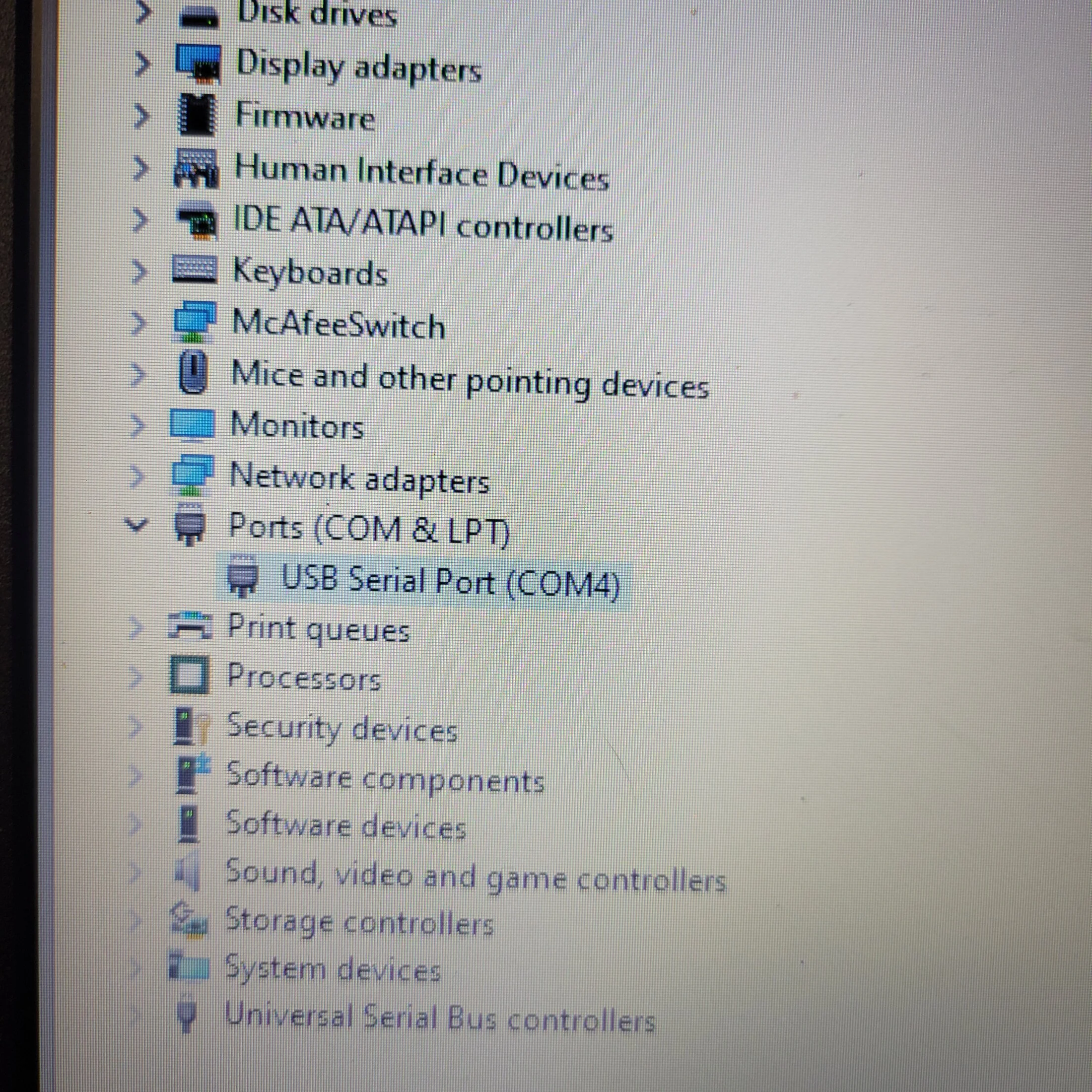

This windows 11 ?????
windows 11 nuked most of the rs232 drivers, it shows up in the comm ports but is not usable. You have to uninstall the driver and install a new one.
Google cannot find what you are stating.
FTDI drivers are the same for Windows 10 & 11.
Any error would be no entry in Device Manager & no comm port assigned but his pics show both.
Windows 11 USB COM port​
