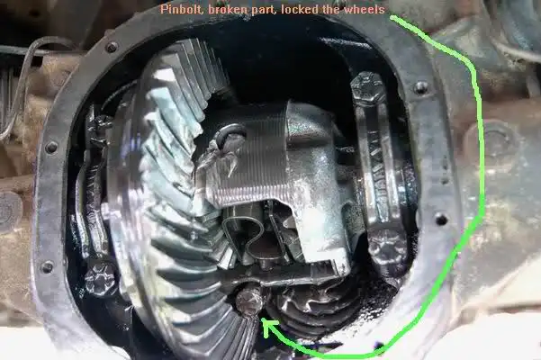

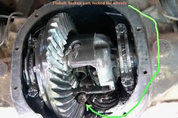

The Large pin seperating the axle shaft, broke and the broken parts ended up locking the wheels in nearly 80Mph. The damage was most likely done during the launch. 2year old pin. The ring gear and pinion and differential housing broke.

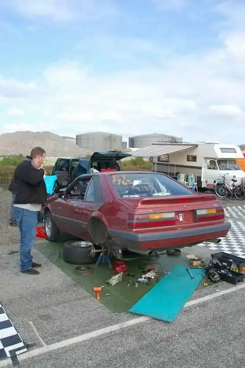

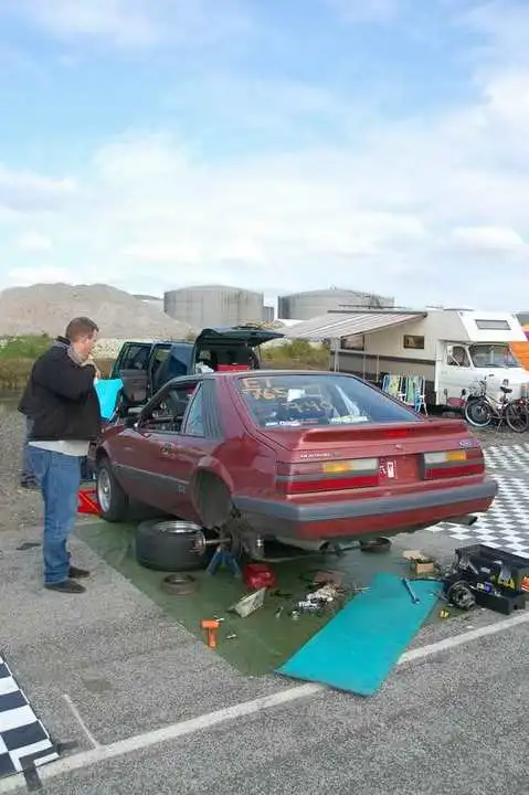

5hours work, some borrowd parts, 2.73 ring gearing and a diff. and then I drove home, 356miles.

And some broken parts :

.. as mentioned, lesson learned. All the "pin design" differentials are as week as the pin itself. Even the M-4204-F318C has the same pin as the stock unit, I think ? Made for 390hp Cobras. If The 31 spline FMS unit is installed, the pin is there. Detroit locker next year Or any other strong units ?
I'm looking into a 31 spine locker when i do mine. I wasn't busting your ass or anything..lol

Thanks. Have been thinking about a spool. But as long as I drive on public roads, and like to use my car, I supose a Locker etc would bee what I need. If I did mostly dragracing, a spool wold bee the goal.
I run a spool now, had a stock diff before. Took it off the lift, back up locked the wheel felt like it was the stocker still. Run it, don't believe everything you read.
