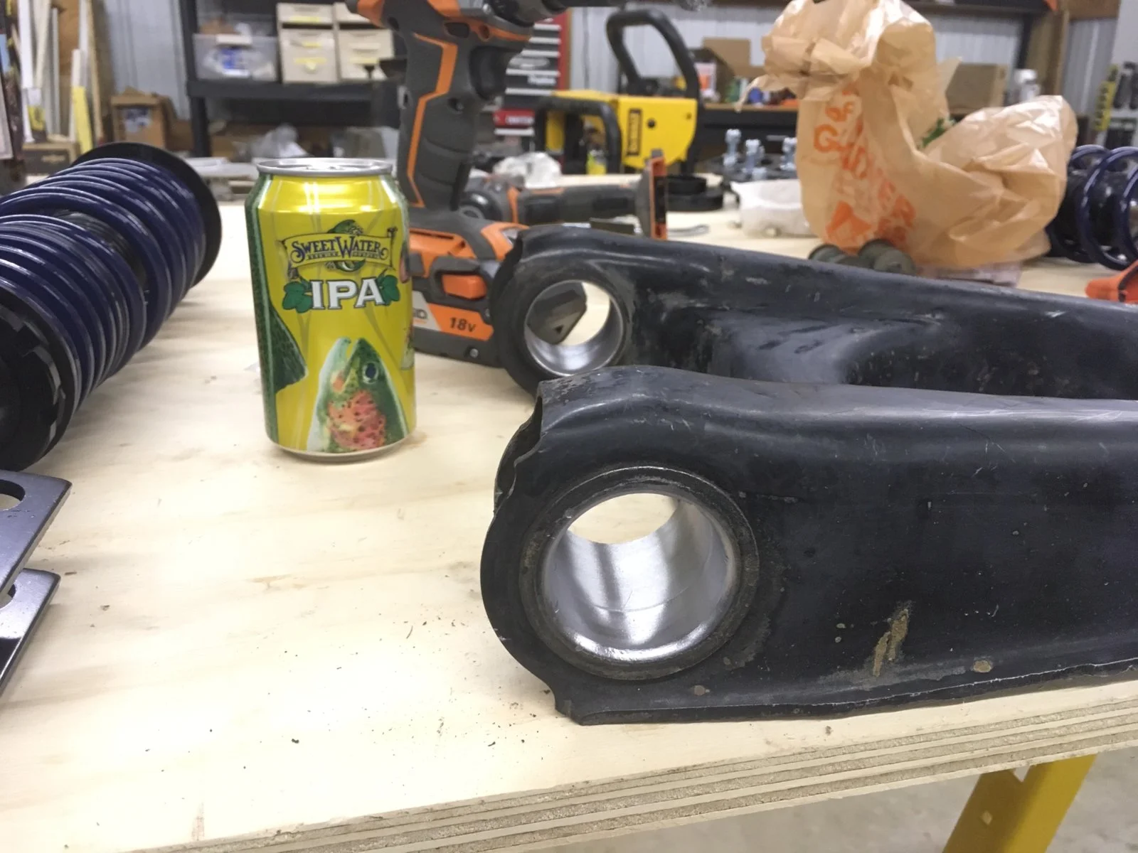

Next is to remove the rubber bushing from the metal shell. I tried a couple methods before settling on the "best" one. The first method was to burn the rubber out. I tried this and I strongly advise against it. Not only does it make a smoky smelly mess, but it's unnecessary if you have a few basic shop tools. After a bit of trial and error on the first control arm, I had the bushings out of the second one in 10 minutes flat. My method was to use a sawzall with a pruning blade to cut the rubber bushing in 45 degree segments. Stop cutting as soon as you hear a metallic rub so as not to damage the metal shell or the blade. The pruning blade is needed because of the deep tooth gullet to remove the rubber chunks, but it's not meant for metal. It'll cut it but you don't want it to. Once the bushing is cut into segments you can pry the pieces out with a screwdriver and hammer. Don't worry if some large chunks (1/8"-1/4") remain attached to the shell. The wire wheel will eat those with ease later.

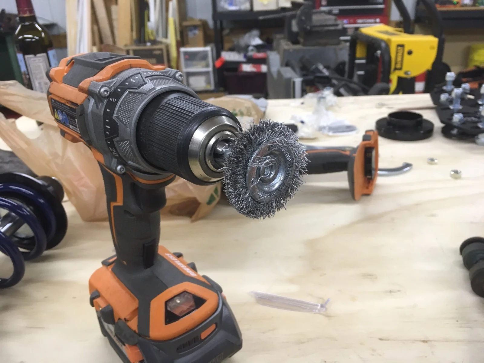

After all the big chunks are gone and only small chunks remain, I recommend getting a 2" wire wheel for your drill. A 2" wheel is too large to fit into the bushing shell but that's ok. This is where your bench grinder comes into play. Chuck the wire wheel in your drill and run it backwards against the rough stone of your bench grinder to turn the diameter down just enough to barely fit into the larger of the two bushing shells (rearward shell). You may need to run the drill in both directions since the wires may lay one way and running the other direction will gouge the rubber out better. If done properly, the wire wheel will turn the remaining rubber chunks into a black powder on your shop floor and will leave you with shiny metal shells to install your new polyurethane bushings.
