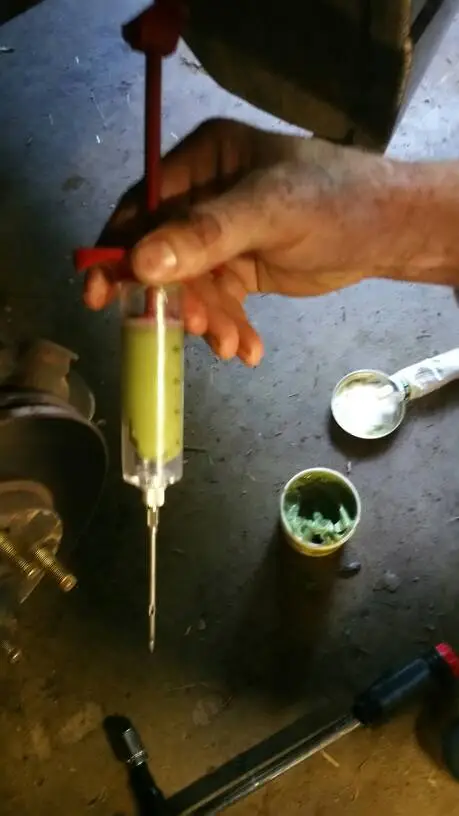

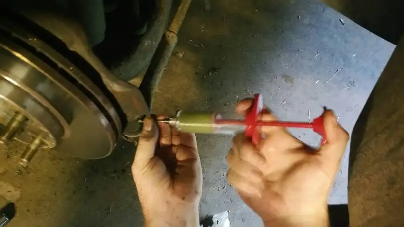

I used a flavor injector then a little silicone to cover the holes. But this allow me to pack the ends fully with good grease.
Sent from my SM-N910V using Tapatalk
I'm not sure if it is the ball joints either, but in going to drive it while before hand. Inspecting the ball joints they didn't look bad, so going with this first.
