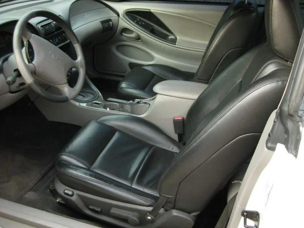

Here's a set of 05+ seats in an SN95 with brackets made for it

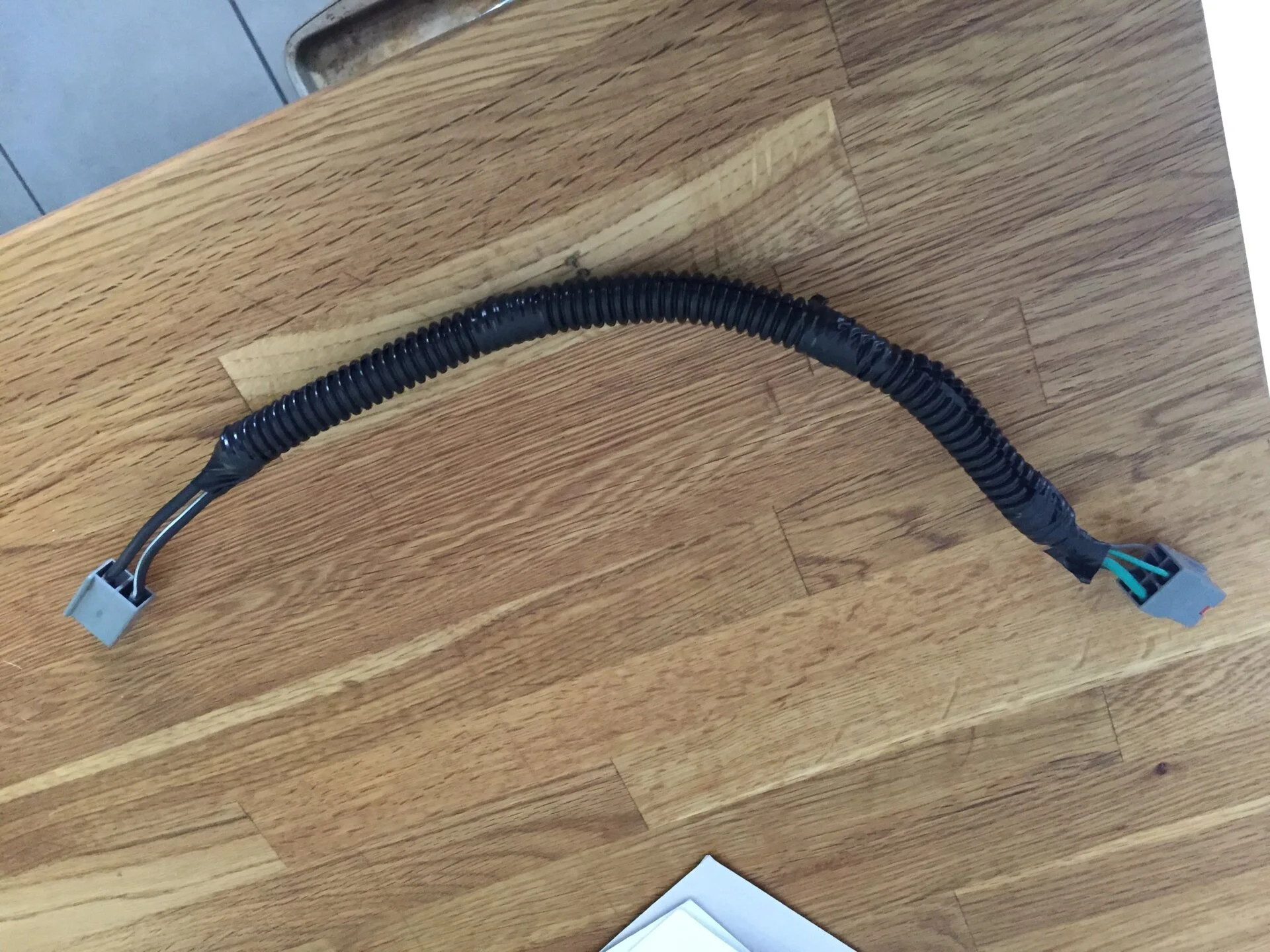

Do you know if the 99-04 seats wire in directly, or would it require some rewiring? I haven't been able to find much information on if the 6 way seats can be made to work on our SN95 pre-"new-edge" Mustangs.
I believe the plugs are different, but not 100% sure. The 92-98 seat track is a 2-wire plug.
thr 99+ track is 4-wire as ford bolted the seat belt buckle to the seat track, so they added 2 wires for the belt warning. I don’t think you need this as I believe the seat belt still mounted to the floor in 1999.
it’s just then two power wires for the track and that’s all. When I put my 99-04 seats in my fox, I made an adapter Harness to allow it to be plug and play. You could track down down some harness bits to make your own, or just use a generic 2-wire plug harnessand splice them in
Sea Dog Line - 426880-1 Sea Dog Polarized Connector 2-Wire Plug and Socket Amazon product
View: https://www.amazon.com/dp/B000Y89TDM/ref=cm_sw_r_cp_api_i_RmamFb8XH0JQX
Edit: here’s the harness I made. Right side male plug was clipped off a 99-04 car, left side male plug was clipped off an 87-98 car. I didn’t want to cut any of the factory wiring
