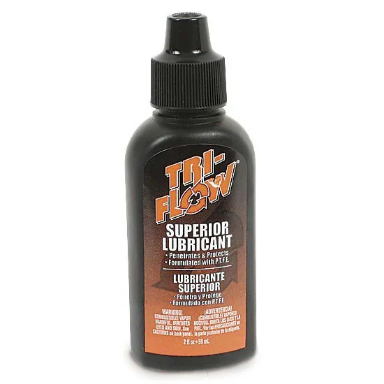

this right here is what you want
Reactions: theconductor
